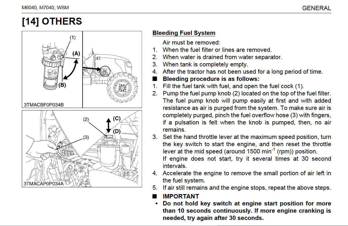

There does not appear to be a bleeder. The procedure is: pump the fuel pump until resistance is felt, then crank engine.
I have done all that.

   / Changed out fuel filter and now tractor won't start #13
Looks like you went by the book.
M6040 WSM https://www.kubota.cz/data/soubor/WSM_M6040_7040 EN.pdf
Page G-39

So your tractors water seperater base doesn't have lever(ITEM 1) with positions A & B similar to most Kubota tractors I've seen?

Go with the easy answer first. When I had the same thing happen on a similar Kubota, I learned I turned the fuel shutoff lever the wrong way. Fuel only flows with the lever pointing one way and I had it pointing 180 degrees off.
Not sure if yours is set up this way but I'll bet it is. If not, it's air in the lines.
