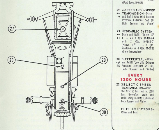

Dec 1, 2025 / change oil #1 B billb7984 New member Joined Mar 4, 2016 Messages 6 Location lowell Tractor 1953 golden jubilee which plug on my 63 ford 2000 do I remove to change the hydraulic oil on in the rear thank you?
Dec 1, 2025 / change oil #2 EdGooding Gold Member Joined Sep 12, 2016 Messages 357 Location Montpelier, VA Tractor 2006 Massey-Ferguson MF-1533, 1973 Ford 3000, 1952 Ford 8N
