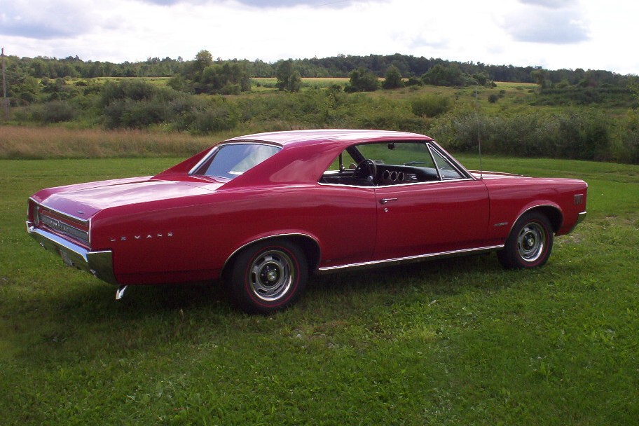

I'm just one of those people who doesn't care about, or for, his stuff....or how long it lasts....this is plain to see below....Hill Billy Bob
PS: My Pontiac is still powered by it's original 326 engine
