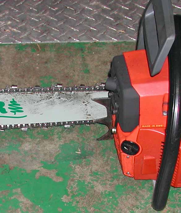

Stihl's especially have succumbed to the noise police. Easy fix for more power, quicker spool up and better RPM.... Take the muffler off and open it up a bit with a Dremel and a grinding bit. I opened up my MS 290 and it made a big difference.

I wouldn't mind having more power. When you opened up the muffler on your ms290, how much is a "bit"? And how much louder was it?
   / chainsaw #25
I have modded several mufflers on larger saws. What I do is cut a 2nd outlet port and
weld (not braze!) in a short piece of 3/4" conduit. Louder? Yes. More power? Sure feels
like it, but I have not measured speed or loaded RPM to prove it. The photo is of
a Husky 266 I did recently. The original muffler has a pretty small outlet, which
is true of most saws built in the past 30y.
Another path to more power is a cylinder gasket-delete. Replace your gasket
with fuel-resistant sealant for more compression. This is an easier
project on a pro saw than on a consumer-grade unit like the MS290.
