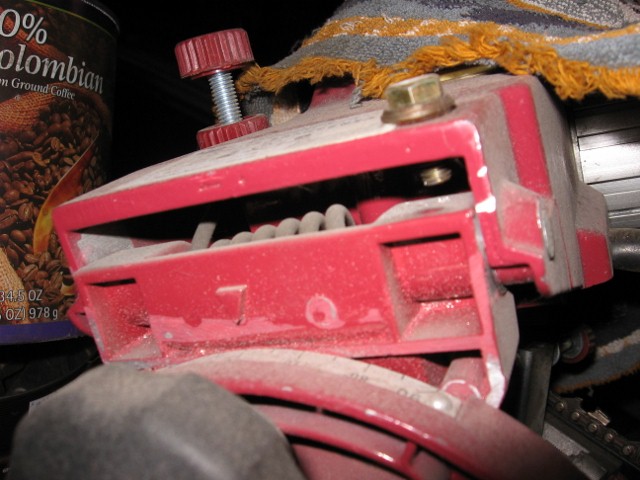

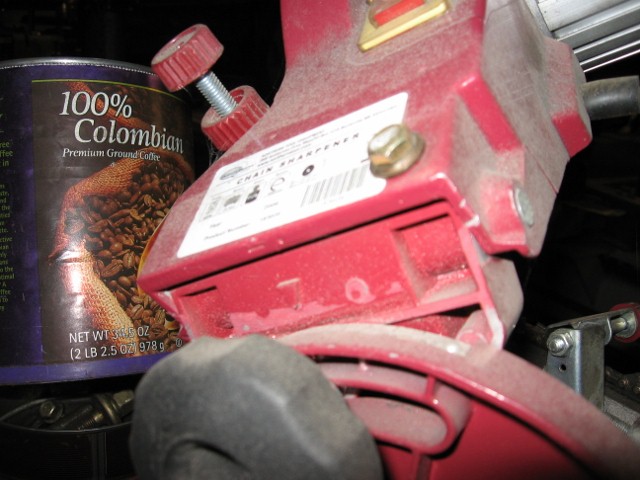

Here is a mod I did that saves time there are other mods also but this one I like the best it keeps the arm from going up too far.
I had an Oregon 511A at one time and that was a feature it had and the chinese copy has not.
Nice! I like it. I was going to add a chain, but your method is much better. Thanks for sharing!
You are welcome thank you! :thumbsup:
