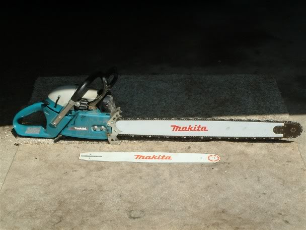

I have owned two MS 250 Stihls 18"bar and one PS510 Dolmar 20" bar; the 250 is good for light brush and small stuff but no match for the Dolmar on the big old dead mesquites that I cut. Like both but give the edge to the Dolmar.
I am about to pull the trigger on another Dolmar/Makita this time a 32" bar probably looking at the DCS6421RFG or the EA 7300PRZ. Heavy saws but want to use the small mill attachment and on the big logs let the weight of the saw do all the work.

64cc is too small for a 32" bar. My modified MS460 (77cc) can pull a 32" but only with skiptooth chain. Milling is especially hard on saws because the chain cuts much slower in that orientation.
   / Chainsaw Recommendations #125
Ya i figured it would be harder. So the 7300PRZ is 73CC is that big enough? Or what about the 28" bar for either of those?
   / Chainsaw Recommendations #126
I don't know the 7300 but it's probably going to be slow with a 32". I wish I'd gotten a 28" for my 460 and I might get one still. I got the 32 to deal with a very large fallen tree. I had to modify the oiler to HD specs to handle the long bar. It's really happy with a 24" bar and full complement chain.
Get the 7900 if your going to go that route.
They pull a 32" fine.

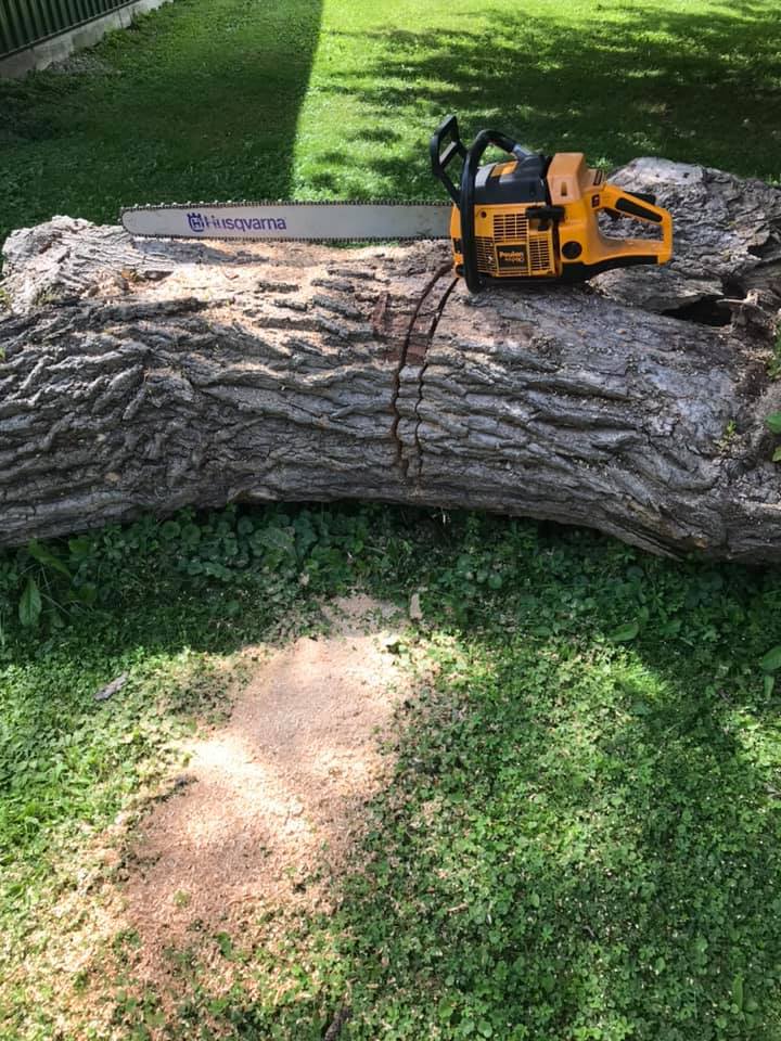

I made a cut with a 65cc with a 36" for kicks. 32" or so was buried in cut.
I was suprised how good the 65cc poulan did. I wouldnt want to do that all the time on a 65cc IMHO.
Get the 7900 not the 64 73 for the little more money for 79 JMO
