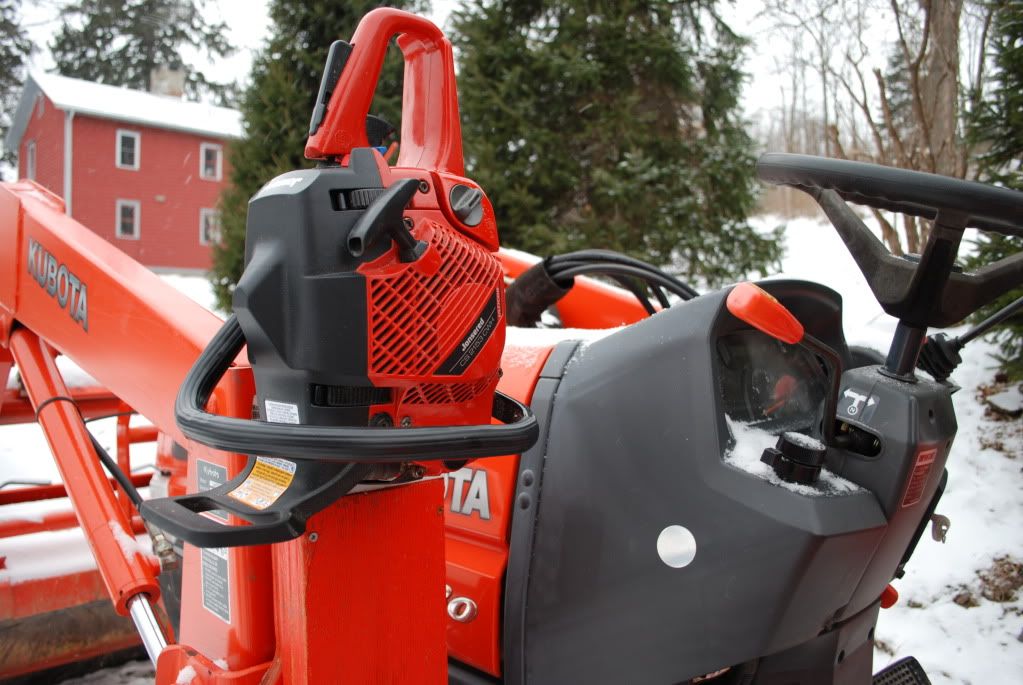

I finally took some photos of the chainsaw holder that I have mounted to the FEL post on my new Montana. I fabricated it out of aluminum L channel and plastic from a kitchen cutting board. The saw is now always in an out of the way, easy to reach location. It does not rattle at all and the cutting teeth are well protected. Greg
gpd9780, nice job good pics , now all you need to do is get a nice orange Kioti to match that nice orange Husky saw !!

Nice saw J.Walker:thumbsup: I have the 2159. Does yours leak bar oil when it is stored like that? I have been wanting to build a mount for the massey like yours. I have mine stored like that in my shed and noticed it was leaking bar oil down the wall this fall, so I had to angle it almost 45 degrees to get it to stop.
   / Chainsaw holder #26
Greg,
...recently my Husky started leaking all the oil ...
If it's a Husqvarna, it leaks oil. Well, my 353 does and dealer tells me (and others) it's the nature of the beast. When I bring it in for the night it get's a diaper.
Great idea for the saw holder. I carry a 353 and a Stihl 460 on the floor boards at my left foot. Alsways gettin in the way. I think there will be a new addition to get rid of that problem. Thanks for the ideas.

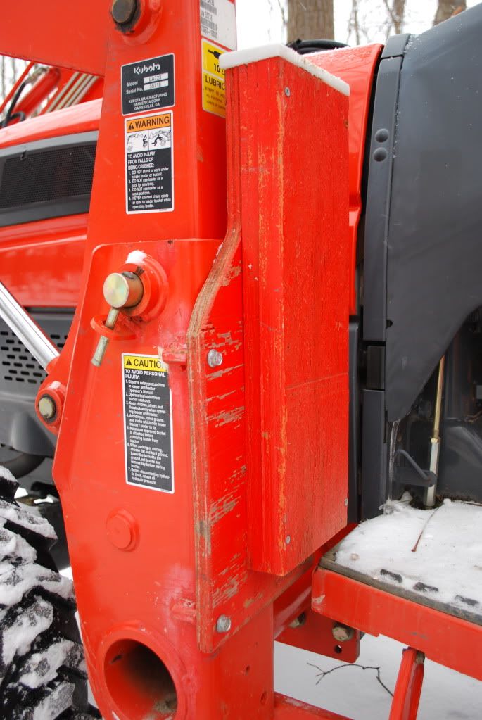

My buddy has a holder in his pole barn that's a 5' log sawn thru with the tip of the saw its pretty nifty I'm gonna make one also for my saw.
   / Chainsaw holder #29

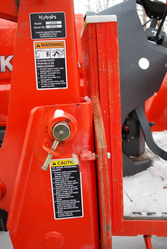

I made use of this half inch gap on my loader mount, which means easy on easy off, and this also means I'm the last one to show pics. on this ten year old thread, which means I'm the winner, which means I will win a brand new 50hp tractor, I hope it's the right color.
