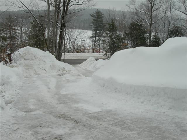

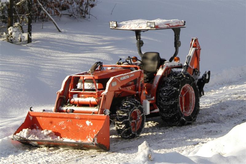

If you're anywhere near Milford stop into B & B chain they're a part of Chapell tractor. Good people, pricing is decent and you'll get good info as well as being able to handle the merchandise which always helps me. I'm in So. Me and use double ring chains as they are self cleaning and I use them through spring mud season.
here's a pic of the bottom half of my driveway, I can't find the photo going up from here.
Here's what I decided on the tractor, I bought a canopy to keep dry and found it the ideal place for mounting lights. The angle is much better while using the FEL than ROP mounted lights. I have two trapezoidal beam lights on the front and two floods on the back. after several years of use I still wouldn't change a thing. I hope this helps.
