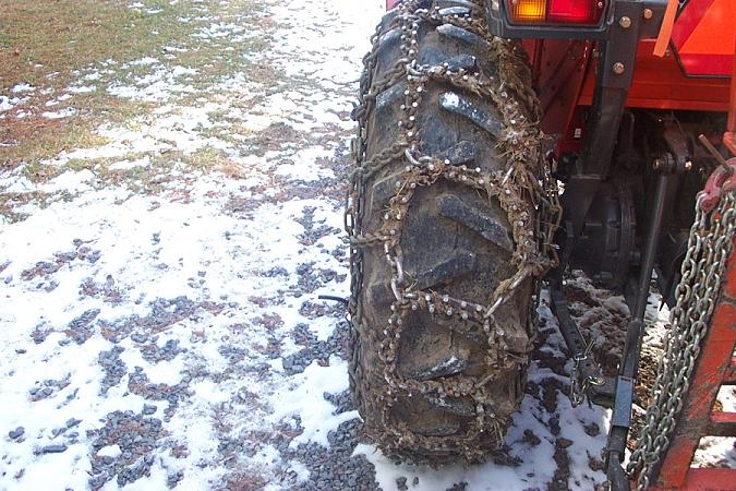

Whew! 65lbs each! Still can't get those spring tighteners tight enough to do much, but the chains are on pretty good.

Chains look good. Where did you get the chains from? FYI, in the past I've used the black rubber bungee cords to take up the slack in my tractor chains, they work very well.

Nice set of chains. /forums/images/graemlins/grin.gif I use a couple of black rubber bungee straps to keep chains on my snowblower tight. Easier to install than the spring type you have.

From the picture, looks like the side chains need to be tighter (shortened) by taking in more links. Extra links are cut off on the inside so nothing flopping around, and because the extra ones may be needed for tightening on the outside, they can be wired back so they don't flop (and bang on the fender).
The springloaded cross tighteners look a bit flimsy, IMO and you may find that in deep snow and icy snow chunks, they will be ripped off. As mentioned, I sometimes add some bungee cords to take up some slop, but mostly tighten the side chains to take up the slack.
Just an observation, and can take it for what it might be worth to you. /forums/images/graemlins/wink.gif In icy conditions, chains are often a must, and the scratches in the asphalt get covered when the new sealer is applied. Deep scratches from getting 'unstuck' are harder to hide with sealer /forums/images/graemlins/tongue.gif beenthere /forums/images/graemlins/grin.gif

I have looked at the pic of your chains 10 times and still can not put my finger on what is wrong. Maybe nothing but they almost look like they are not wide enough for the tire.

It looks to me like you just need to put some tension on your spring tightners. Take another link or two on each until they are putting tension all the way around.
Drive around a little and you will be able to take up some slack most likely, although a little loose isnt going to hurt at all.
Chains will give a lot more traction than a rubber tire. The type shown also will give you lateral traction which is pretty handy on side hills. I run a less aggressive set all the time unless I am going down the road a fair peice.

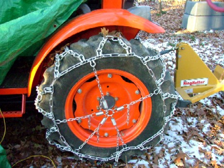

How would you like to put these on.
