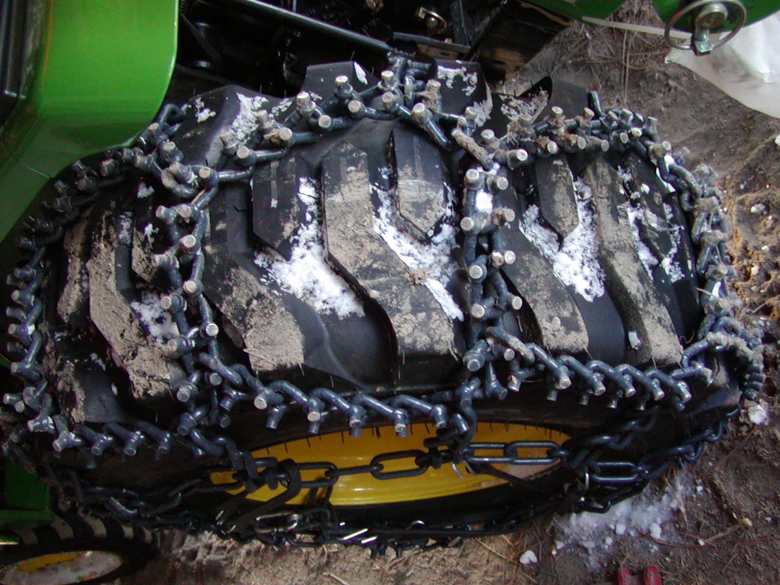

I tried a 2 link and it did not help much on my driveway. So, I traded them for these plus more cash. These work! Problem is they are very heavy and the 2520 has little clearance.
/ Chains on R4's #4
Those look like thay would really bite.;) only problem is on a paved drive.
it looks like if it spun. it would really scar the driveway...:(
Chris...:)
Wow!
Those are some serious chains!
I don't need anything that aggressive - my main problem is the last 500' of my driveway is a pretty good hill leading up to the road, and we get a few sleet/freezing rain storms each year. The sleet can get 8" deep or so at times - it's like trying to drive in silica sand.

I purchased these chains through our local Les Schwab dealer! They took the first set back in exchange. I have a fairly steep curved hill in my driveway. With the normal chains, I would still go sideways around the curve while trying to angle the snow like grading. These chains do really bite into the icy stuff too. Expensive too. Cost me upwards of $500. The problem I have with them is they are HEAVY, and they are somewhat difficult to put on because of that.
Last year I tried to plow the curved area going backwards and that worked very well, so much so, that I did not put on the chains. It did not snow much last year either so there was not much motivation...
