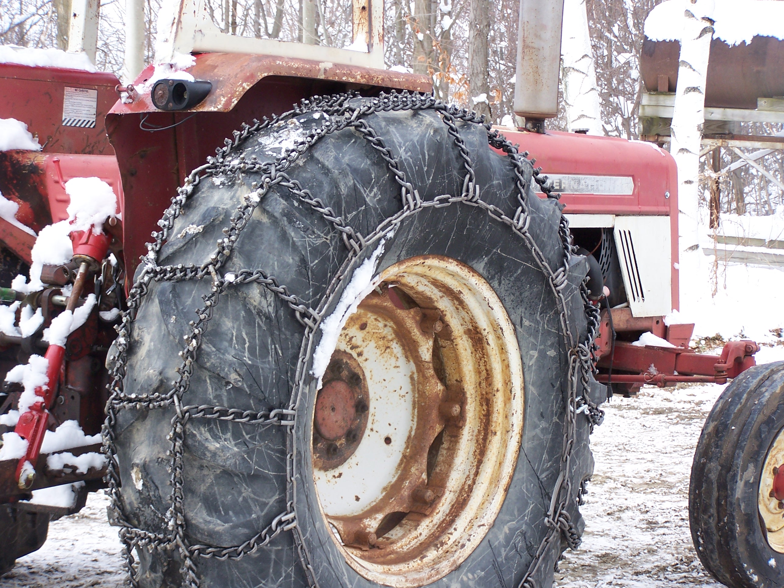

The ONLY chains I would recommend are the Euro type;
Auiline,
Trygg,
OFA's
these style of chains will provide the best traction and ride quality of any conventional style of tire chains.
View attachment 592513View attachment 592514
I totally agree. Spend the extra and get the Aquiline chains. The Aquiline MPC are a low profine chain. I have v bar ladder chains and wish I had bought these. Ladder chains give a bumpy ride, especially when they're on the front.

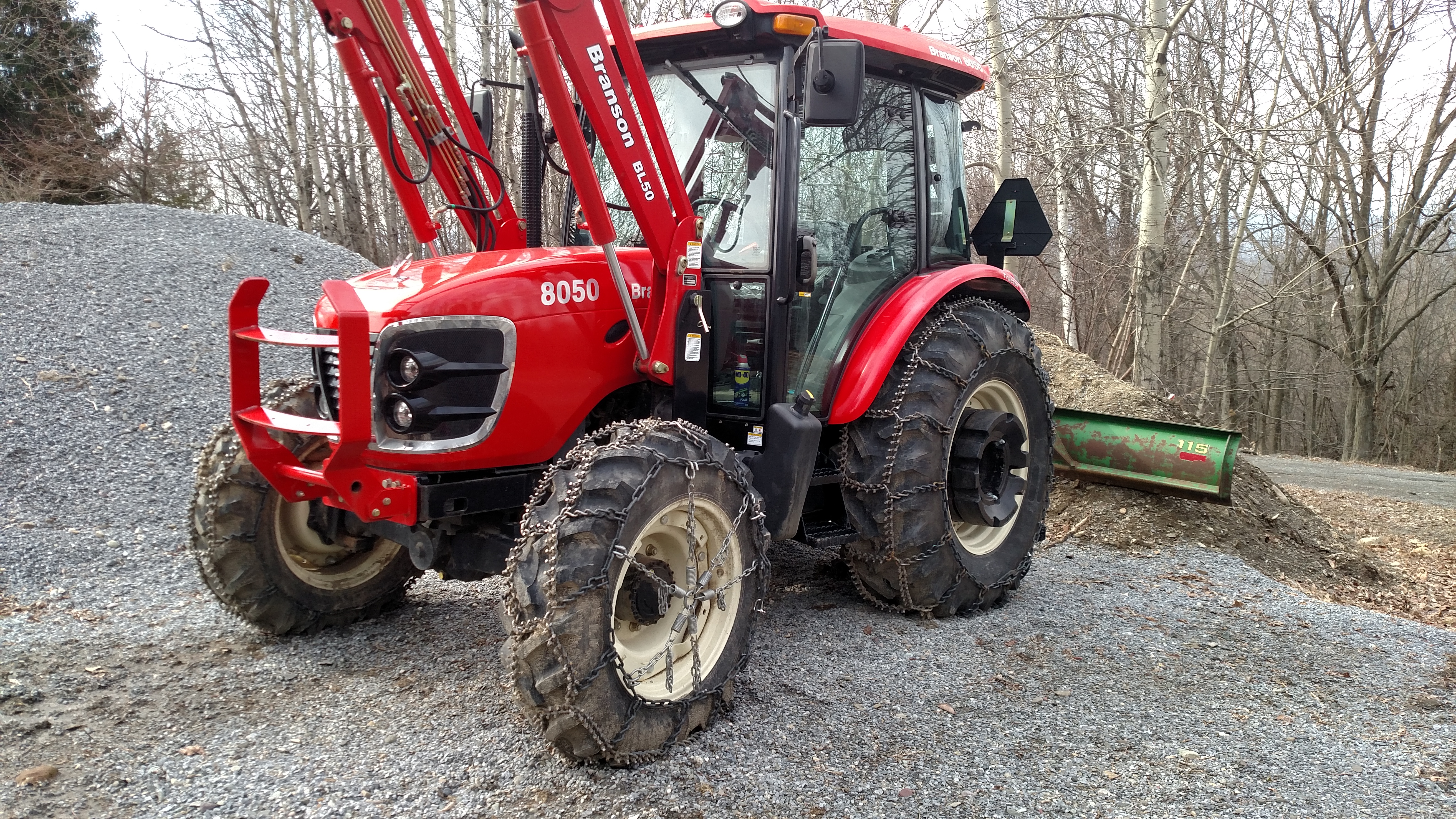

Been running chains front and rear on my DK 35 for years, no issues.
