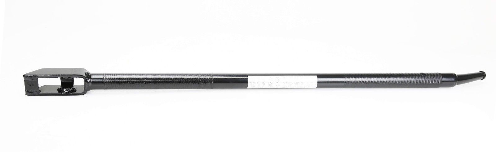

Personally I think with the invention of screw and ratcheting binders, lever-binders should go the way of the doo-doo bird. They are just too dangerous. It takes a piece of pipe to lever them down, then when you take them off you get a face-full of lever under amazing tension. Many a teeth and facial surgery have resulted from them.
Best to stay away in my opinion...
I used a truckers winch bar with a binder lever on the other end. When the binders broke over either way the bar released the the binder handle. If you are using a pipe, you are using the wrong tool.
