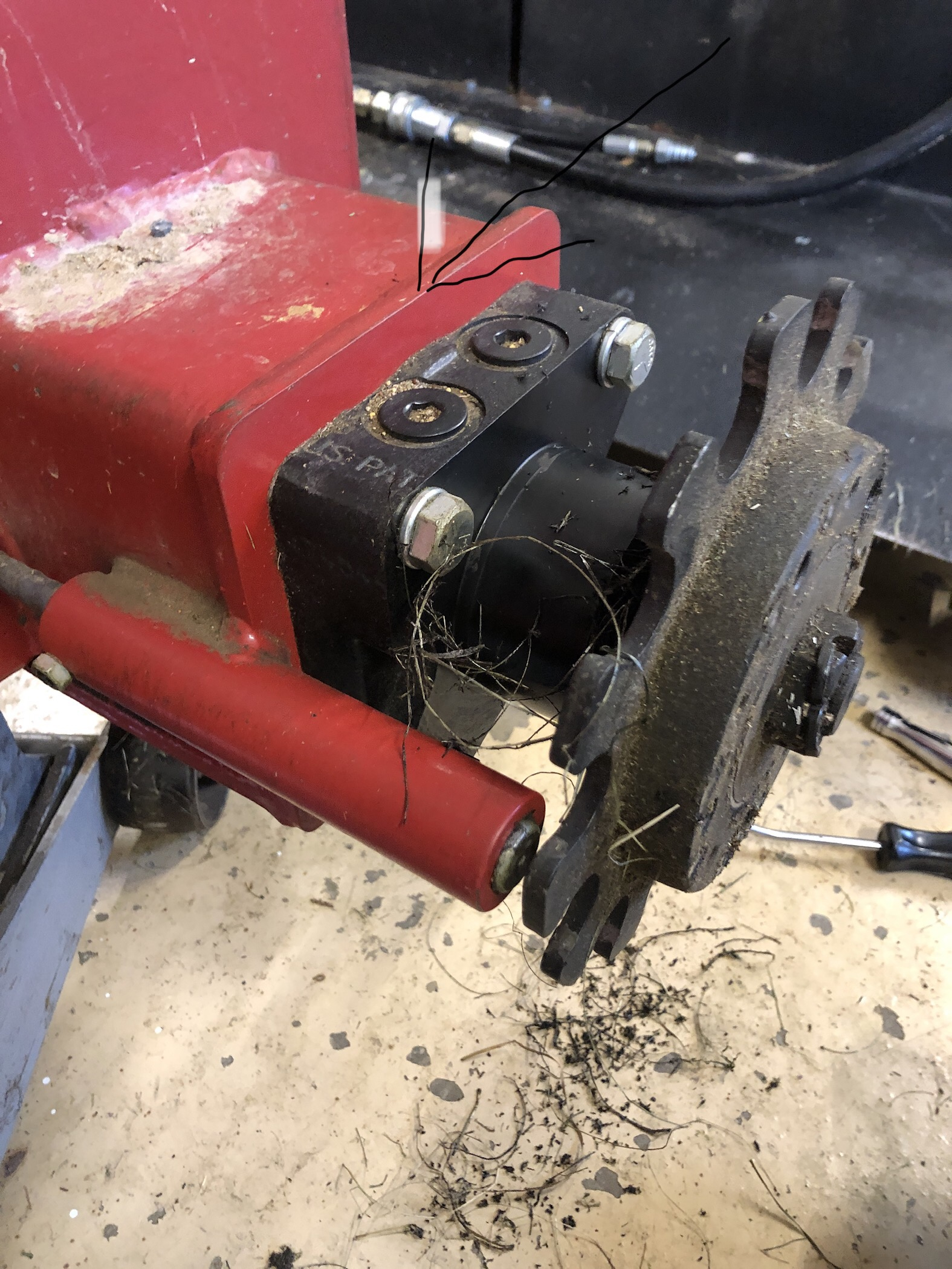

35A875F3-A5CE-46ED-9499-6E3A59812E35.jpeg Has anyone had an issue with bending any of this with a chain binder when tightening the machine down on the trailer? I was curious. I’m not real sure about these wheel motors or the plate it is attached to, so I don’t tighten the pt down as much as other machines. Maybe someone out there has some helpful advice for me? Thanks.

You need to be careful with the park brake mechanism. The brake applies with spring pressure, so any deformation of the parts will render it inoperative. The frame for the wheel motors can hold way more than twice the lift capacity of the tractor, so no issue there.
I use nylon straps and use the tow pin on the rear and the steering cylinder pin bosses to pull toward the front. But that is just me.

When my PT-425 was shipped here they just chained it over the center tunnel. Which scraped all the paint off. :mad: So I repainted it and all is well now.
Looking at that picture, can you get the chain closer to the frame on the red part?

Thanks John 👍 That gives me a little more confidence I’m not messing anything up. Yeah, I know what your saying about the brake pins.

Someone could strap it down there. A thought that came to mind would be to make 4 places on the trailer bed fitted with D-rings dedicated to putting short straps around that red part around the wheel motors, then tightened it down.

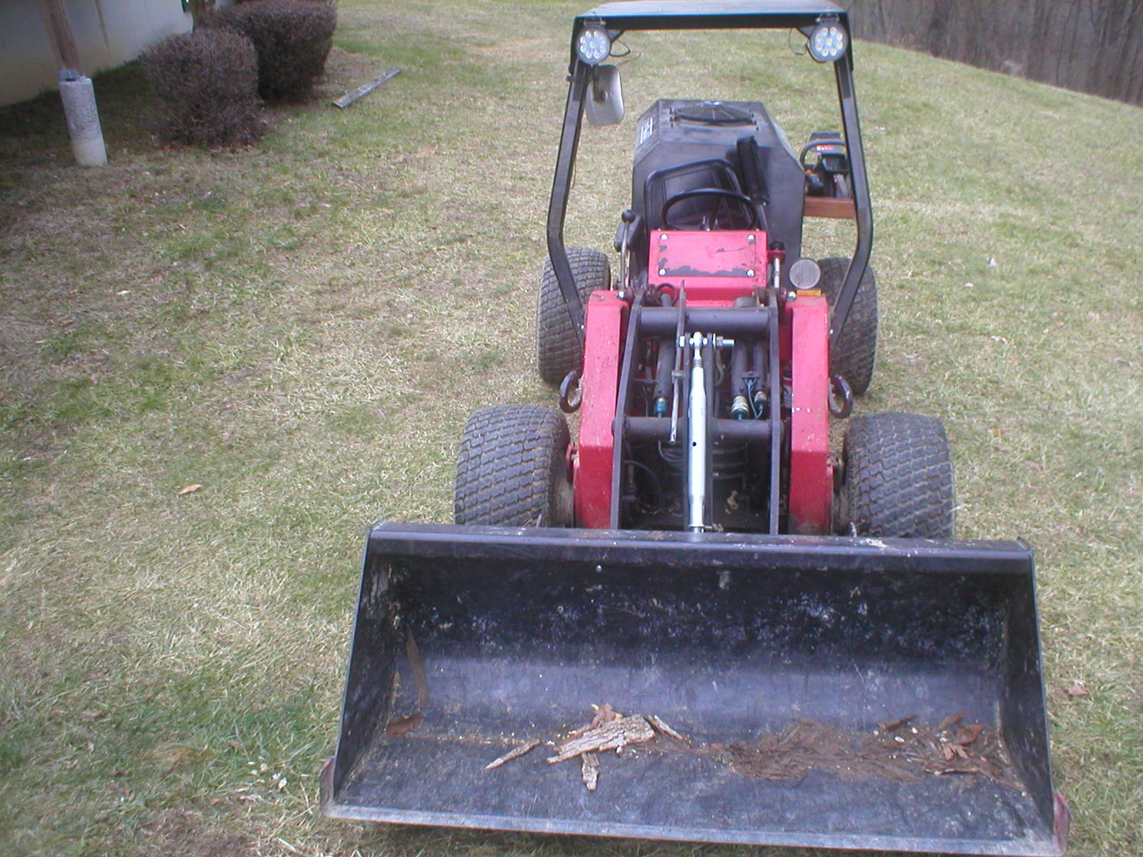

Here is my 1845 front hooks, I use them for pulling also. They were on it when I purchased it.

Here is my 1845 front hooks, I use them for pulling also. They were on it when I purchased it.View attachment 718465
That would make it easy for strapping the machine down, there's no doubt about that! This 1845 looks like a work horse(y)

The chain hooks do come in handy for quickly securing the PT and sometimes even for controlling a load. I had the factory weld them on to the front and back of mine and Carl's tractor.
Ken
You mean Power Trac welded them on for you? I was told they usually don’t get into doing custom adaptions.
/ Chaining down a Power Trac #20
Yes, they welded them on for us. I bought the tractors used (used is an understatement) and had them delivered sight unsee to Tazewell to have PT go through them and repair what needed to be repaired. At that time, I sent the weldable hooks to them and they welded them on. A very easy thing to do, I would have done it myself but since I considered them an important safety item when trailering, I had the pros do it.
