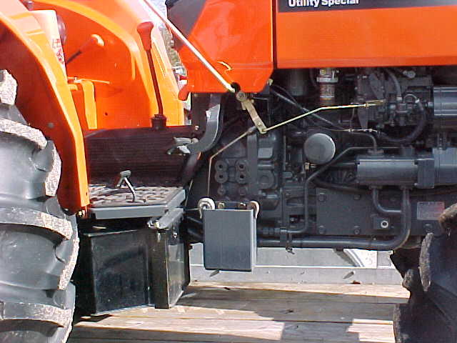

   / chain storage buckets #28
Just thougt I would re post this photo. If you have room it works well and keeps out the mud and rain.
Rich
