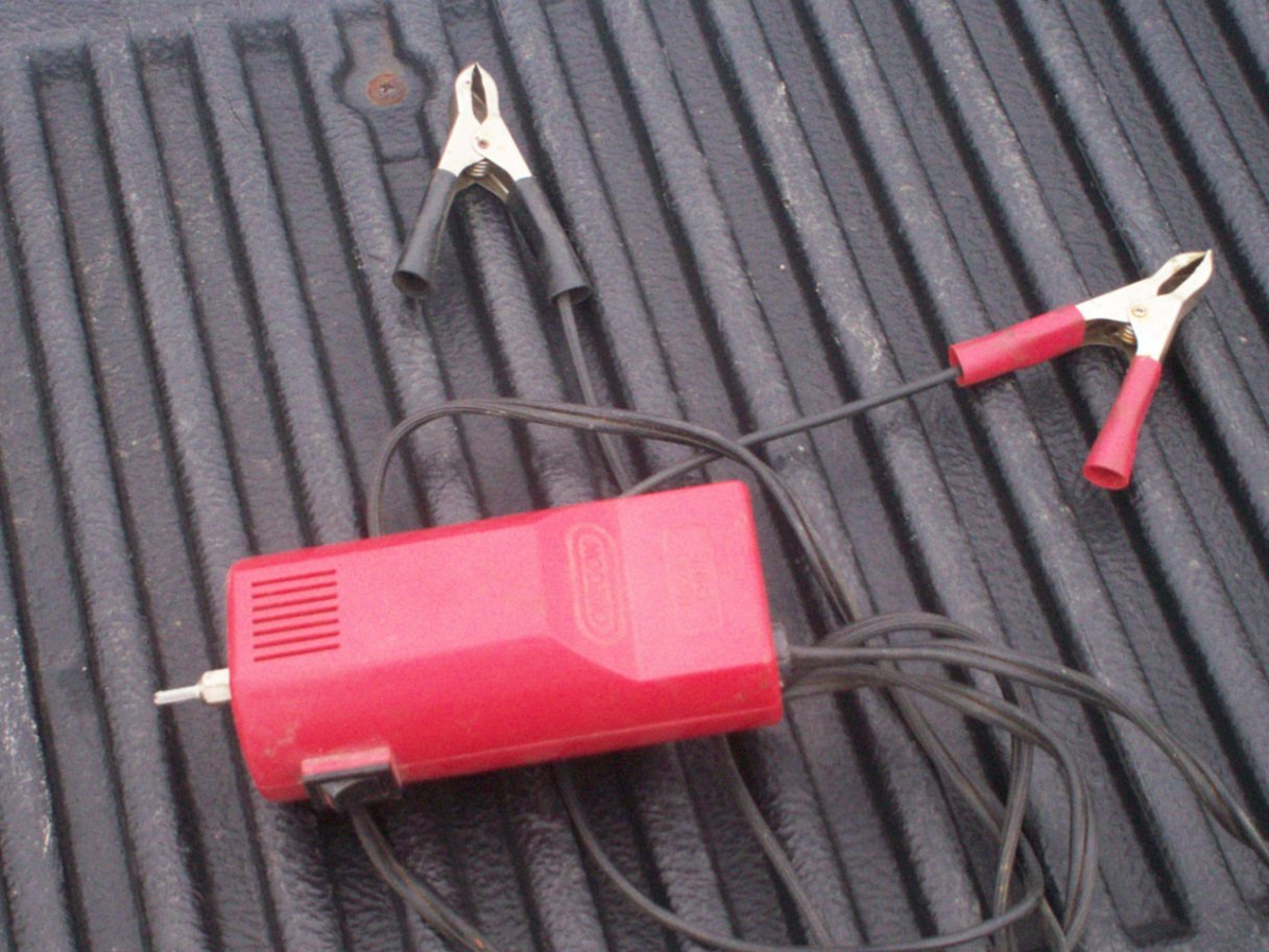

I bought this from a lawnmower repair shop in Irving several years ago, gave about $20 for it as I recall. You get stones in whatever size you need for your chain, it hooks to 12volt battery, and your in business. It has a metal bit in it now, but it comes in handy for touching up blade in field. It is an Oregon brand.
