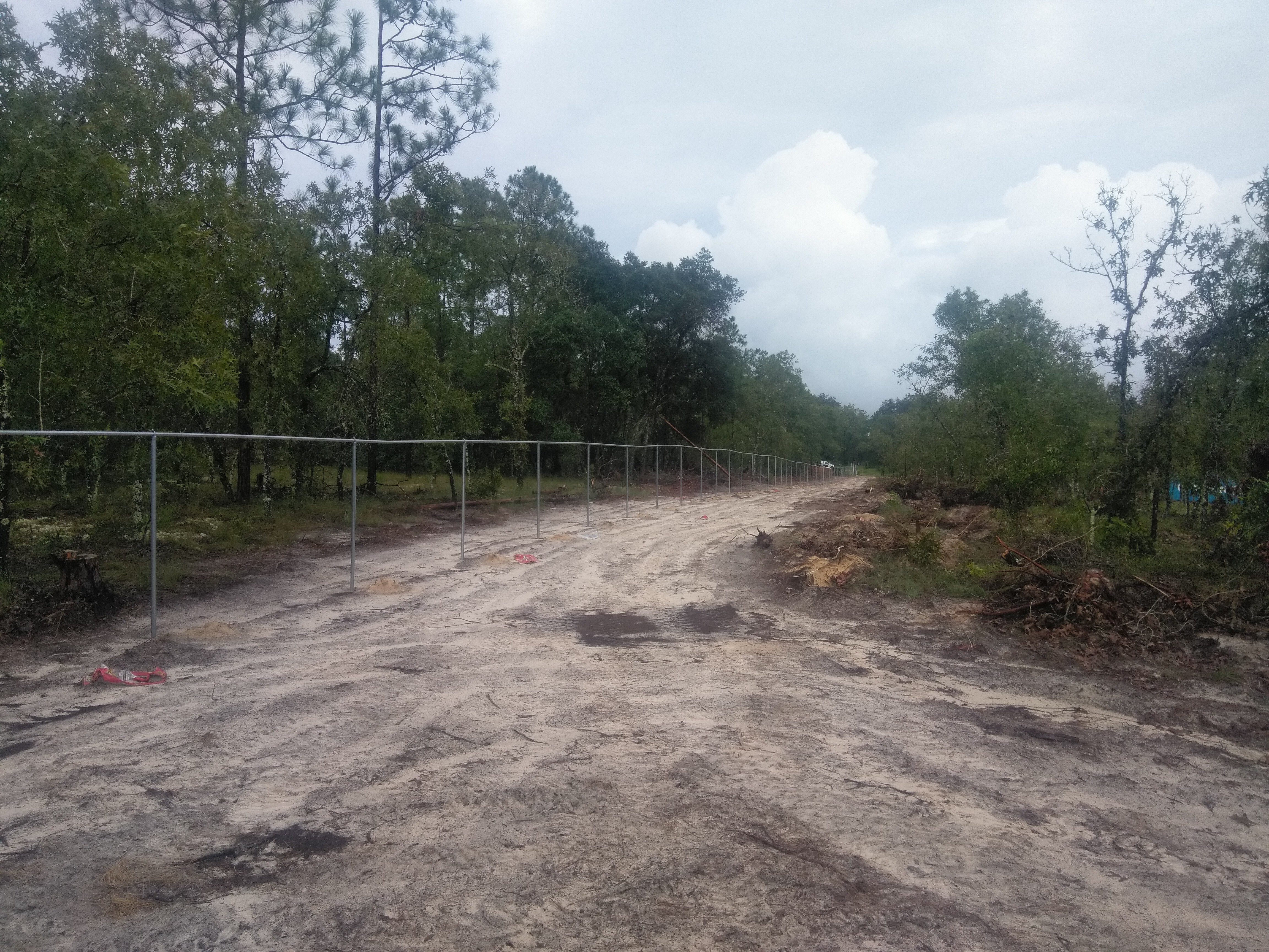

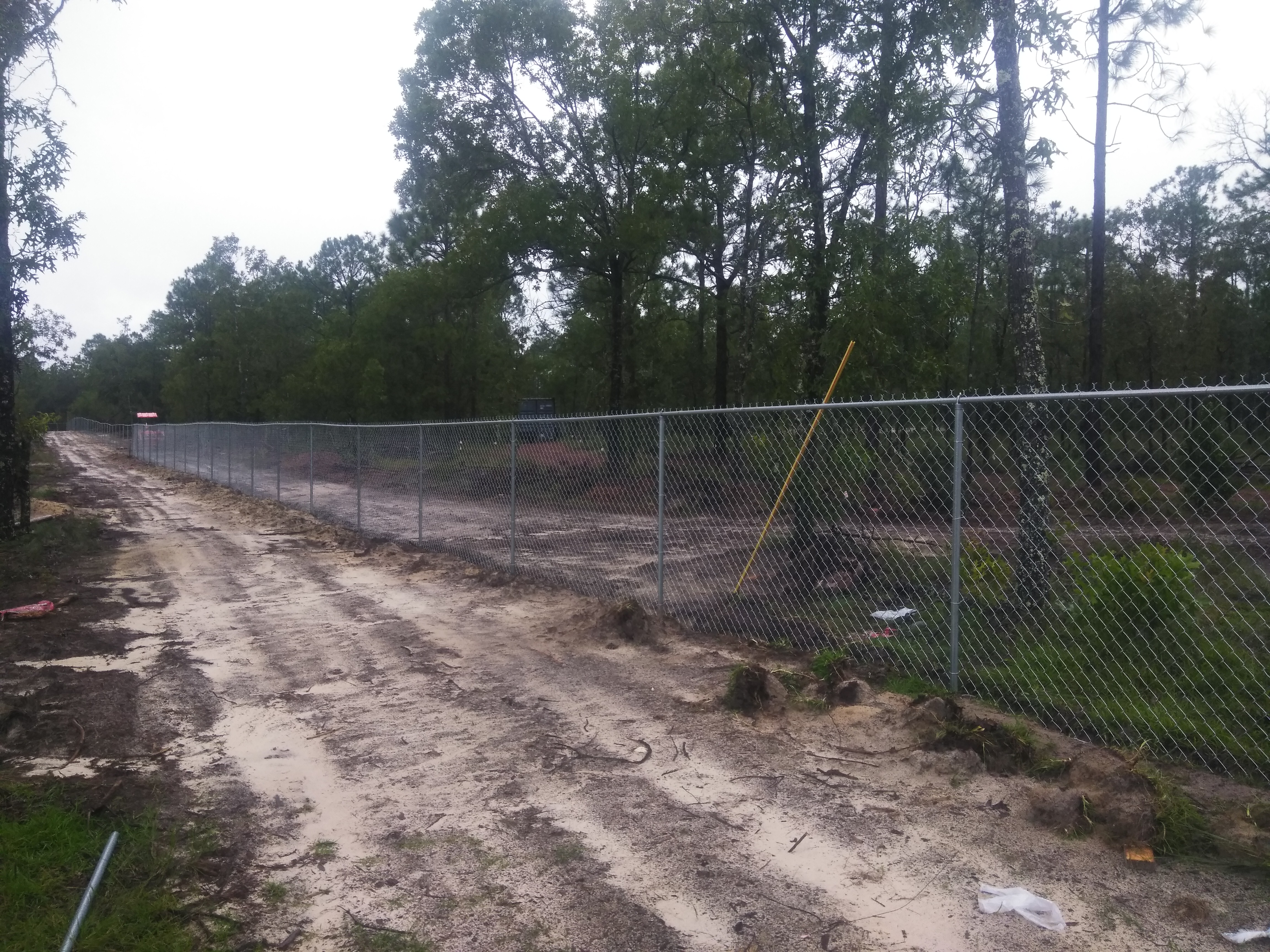

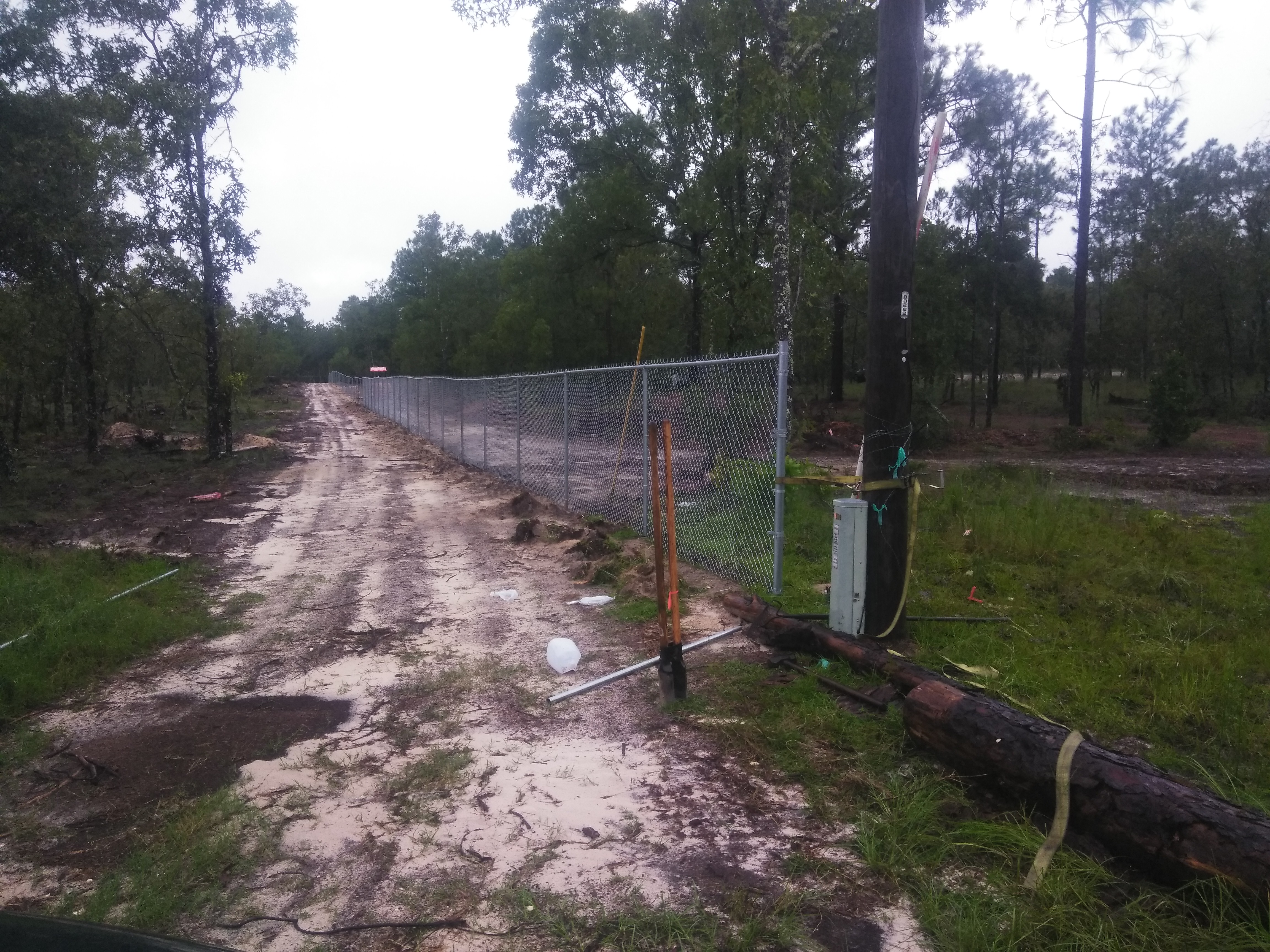

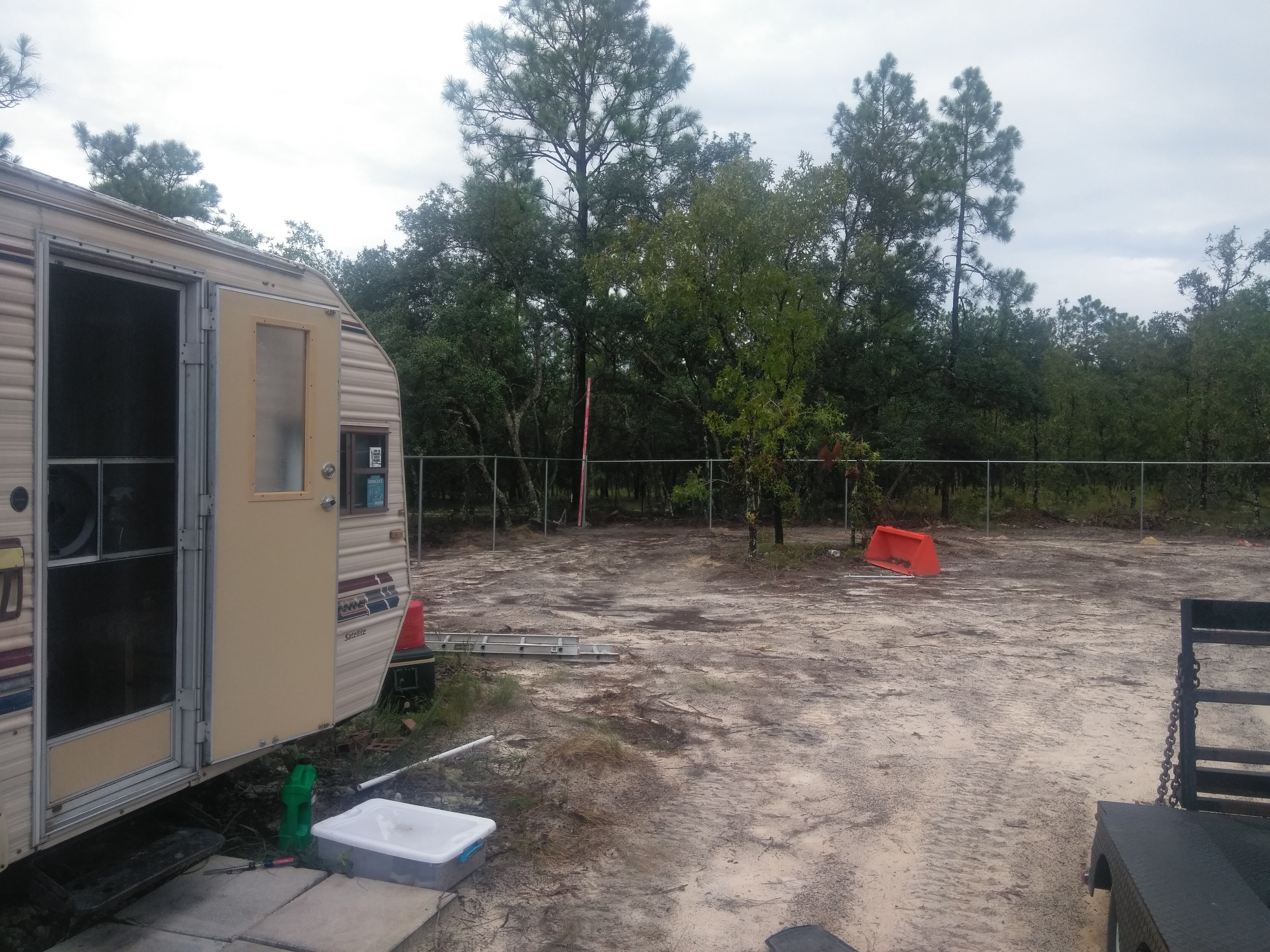

Again just to update, the fence is just about done, took 3 weeks away from work to get some things done on my property, knowing what I know now I think I could have gotten it done in 10 days easily but the sun was either absolutely blistering hot or it rained cats and dogs, I worked in both of them to the best of my ability.
I prob had 2 weeks into the fence. Concreted all posts, people told me I couldnt do it myself, I did it myself with the exception of some of the trenching, I wanted it buried a few inches, I hired some locals that needed a few bucks for beer.
Everyone that sees it cant believe I did it myself and so quick, its straight as an arrow when looking down it from the end, the land is not level though so there are some elevation changes within the fence line itself.
All in all I will say it is EXTREMELY easy project, zero complicated, definitely not overly labor intensive. I am glad its done though with the exception of one gate that I am still working on making since too pay someone to pre fab is a ridiculous price.

Congrats on getting it done. Any pictures?

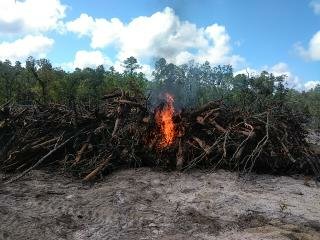

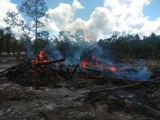

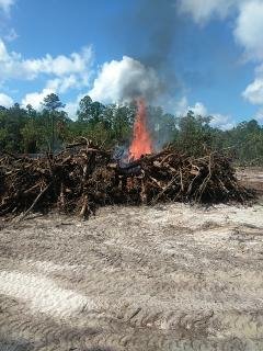

I really like how you have it cleared of everything along the fence line. Tress love to drop branches on a fence. I think it's a game that they play!!! My neighbor was in a rush to get his land fenced and didn't clear all of the trees that he should have, and in the Spring, I went over there and counted over 20 areas that the fence was damaged from branches falling off of trees. In some areas, the fence was completely destroyed!!!

So how deep did you put the posts, and how many bags of concrete per hole?

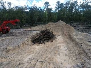

Thanks, I wanted to be able to drive the outside of the property and have room to haul stuff. I already had an accident with the tractor hauling some steel that was long and came down onto the fence, twisted the top rail pretty badly, easy though to change out since it was nearer to one end. I still have one gate to finish, I have to pick up the pipe this weekend and am waiting for some hardware.
It will be real nice when its all closed up with a lock on the gates, at this point its still open to anyone
I cant tell you exact depth, cant remember the figures since the fence was buried a few inches.( its written downs somewhere ) I used a 50LB for end posts and half a bag per line posts. Gate posts I used 2 bags per
