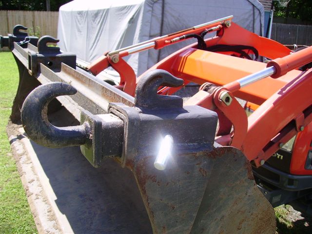

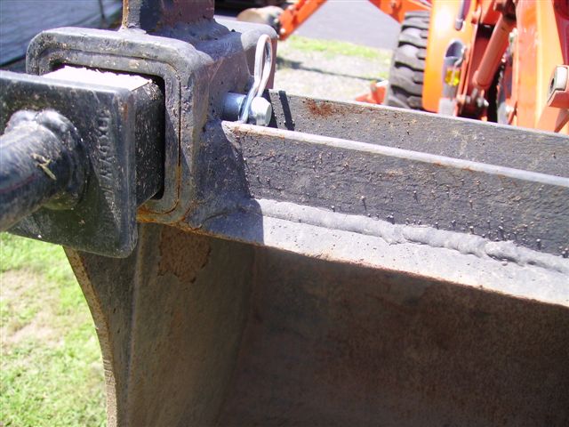

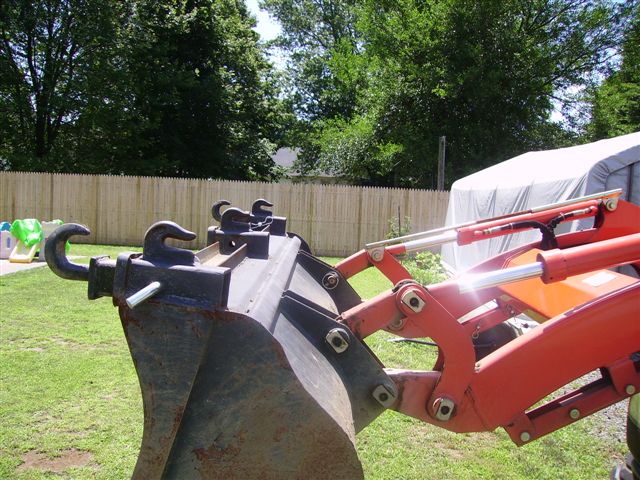

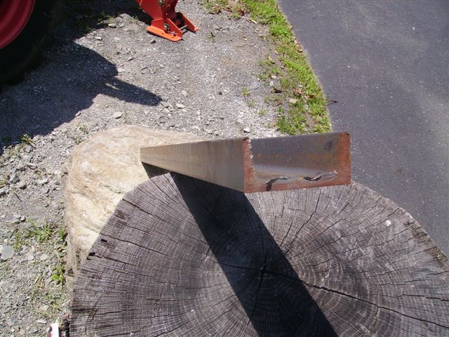

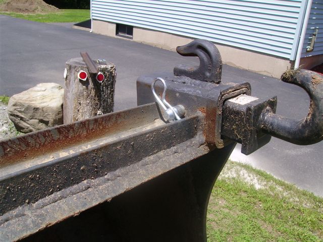

   / Chain hooks #7
Ruby Goldberg Bucket modification!
Supplies:
2 x 6 receiver tube - tractor supply - $10.00 ea.
3/16 x 3 x 1/38 - 6ft. channel steel - metal yard - $20.00
2 receiver tow hook Harbor Freight - $8.00 ea.
3/8 weld-on chain hooks awdirect - $5.00 ea.
Ability to create and plug in a variety of helpful gadgets PRICELESS!
Tools:
Lincoln 135 flux-core
Hobart Stickmate Welder AC/DC
7018 Rod
Process:
1. I first ground off all the paint from the top of the bucket where I planned on welding. What a PIA. The paint just wanted to melt and gum-up the grinder.
2. Ditto for the receiver tubes.
3. Cut steel channel using a chop saw and dry fit all components.
4. Tacked receiver tubes into place on bucket with Lincoln flux-core.
5. Capped receiver tack weld with Hobart & 7018 rod.
6. Ground relief in channel to fit over existing welds on tube.
7. Tack welded channels to bucket with Lincoln flux-core.
8. Stitched with 7018 about every 4?
9. Filled in between stitches with Lincoln flux-core
10. Tacked on 3/8 chain hooks with Lincoln flux-core & caped with 7018 rod.
11. Sprayed with automotive body primer, hey it痴 a working machine.
Strength? Well I had a couple of boulders to move so I lassoed them with a slip chain and tried to pick them up. I was able to barely pick up one of them up but not the other one I could not so I dragged it. The buck and hooks held up without detectable deflection though the loader arms were quite twisted on the one I was able to pick up even though it was pretty much centrally located to the buck the rock was not of uniform shape so it shifted the center of gravity. I considered this a maximum load test for me and my machine. I can never imagine using it to a greater capacity. I could imagine any form of serious jarring could bend or break something but I would consider that abusing the equipment so there are no guarantees there. I do have a variety of gadgets on the to-do list so as I create them I will post them.
