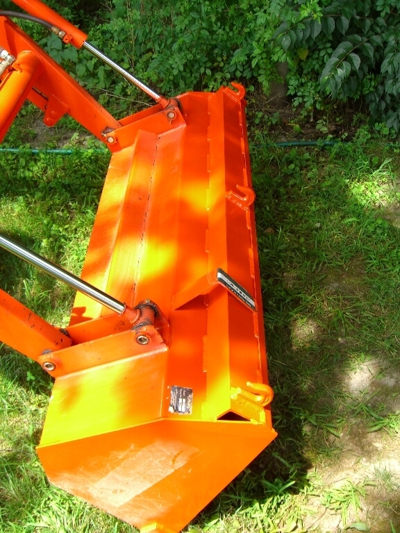

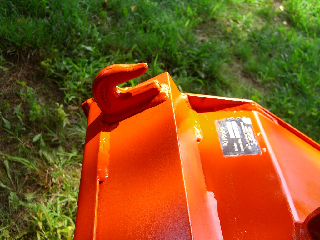

   / Chain hooks on Kubota LA463 FEL #45
Here's my setup. 2"x2"x1/4" thick steel angle stich welded every 4" with a 4" weld. I got the hooks from AW Direct. Here is the link. AWDirect.com - ID3 Towing Grab Hooks
And since the top of the bucket is reinforeced, I have bent the bottom edge of the bucket picking up rocks that just fit inside the bucket, forcing the bottom edge to bow out. Just hooked up a come a long and pulled it back into shape.
   / Chain hooks on Kubota LA463 FEL #46
And I must say,,,,, without seeming too bold,,,,, those are some of the prettiest welds I have ever saw!!!! Wow!!! I can weld pretty good but those are awesome!!!
Also like the heavy angle iron idea. Some tabs could be added to attach a grapple for quick removal. Great job pashworth!!! :)
