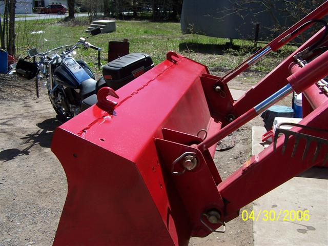

Does anyone have any pictures to post of chain hooks welded to a LA463 bucket. The lip on the top of the bucket has got me really stumped. Thanks in advance. /forums/images/graemlins/confused.gif

Its not a LA463 but I just did mine over the weekend. Welded a piece of 2"x2" angle to the top edge then welded the hooks on.

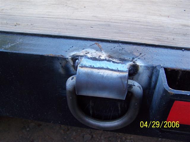

I didn't do a continuous weld. I ran a bead about 5-6" long then skipped a foot and ran another 5-6" bead. I did this all the way across. Then went back to the first weld and ran another 5-6". eventually they all connected.
I also welded on 6 d-rings to the trailer I bought about 6 mos. ago. Just got around to doing it. Till now my tie downs have been through the stake pockets.

George2615, did you use a stick welder or wire feed welder on the d-rings? Welds look great to me!!! /forums/images/graemlins/cool.gif Why I ask is when I weld using my wire feed welder (with gas)I seem to get "little craters" in my welds and was wondering what I'm doing wrong. Too fast, too slow, not enough heat, too much heat, etc. /forums/images/graemlins/confused.gif Sometimes the welds look fabulous and other times they look like crap!!! Thanks in advance.

Porosity using a mig welder and gas is usually caused by losing the gas (having it blow away if it's windy). Try turning up the pressure on the valve or getting the tip and nozzle closer to your weld. Check all your hose connections, too.
It can also be caused if you are welding over paint and the paint is burning. This can be solved by welding slower so the paint burns off before the weld gets there... or grinding the paint off, of course.
You can also help prevent warpage by welding in two different directions... two inches left to right, then two inches right to left back into the existing weld, or 1/2" welds if you are tig welding something. Like already mentioned, don't heat the whole thing up at once if you have a long pass to make.

On the D-rings, is there a benefit to welding them on top of the deck channel vs. on the side like shown. I've seen them both ways. I can arc weld them on much easier to the top of the frame channel.
Great welding.
Porosity is caused by contamination whether it be oxygen in the air where the shielding gas was insufficient or by welding through junk like paint. The weld isn't as strong with porosity but I've never had a porous weld be so weak that it broke. Just make a bigger (uglier) weld.
