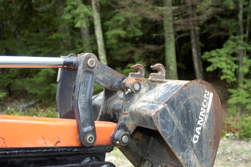

traded MF135 for a 2605 4x4 &added a Mahindra eMax 22HST

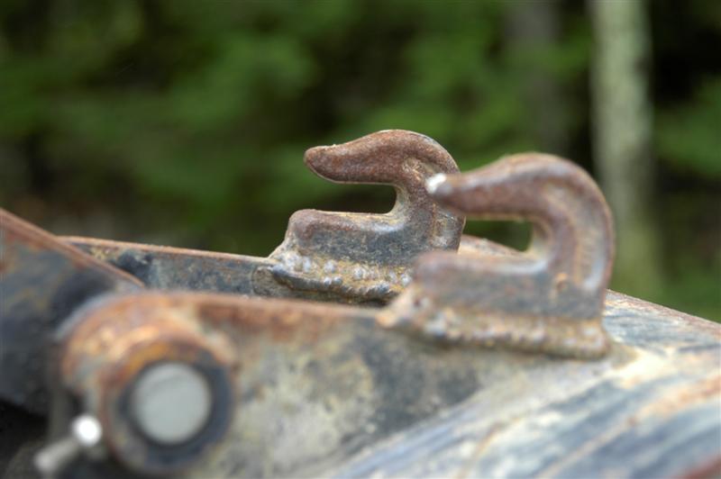

I saw this idea on a Back Hoe that a associate had and though it was a good one.
Took the hooks and cut off one of the eye lets that hold the pin to be attached to a chain and a flat area on the bottom. Used a abrasive cut off saw to make the cuts. Then welded them to the top of the bucket.
Fairly easy and a cheap mod.

I did it to my bucket ten years ago. Works great. You just never know when you're going to need to drag something with a tow chain...

Yeah, I think you did it the hard way, but at the end of the day it will work the same!

I put 3 hooks on my bucket. They are the bolt on types. Grade 70. They have come in handy several times.

You are missing a lot of possiblilities leave the round end on the end of chain hook, use it for rope, bungee cord or rachet straps.

I used the same hooks you did and just put them where the hook fit the bend in the top of the bucket, no cutting and still use the cheep chain hooks.:thumbsup:

most people cut the eye (round end) of the chain hook off before welding it to bucket, therby only being able to hook a chain to it. If you have the round left on it will still hook a chain but will also have a round ring to hook rachet straps or bungee cords also

I welded hooks on my bucket as well but after seeing other buckets with hooks that were bent, I first welded a piece of 3/16" x 2" angle across the bucket the welded the hooks to that. Bucket hasn't bent yet.

Yea, one hook in the middle as the only attach point and a heavy load........bucket isnt designed for that. I like 3 hooks. Each end and a middle one. Middle hook is for light stuff ONLY. Heavy stuff gets hooked to BOTH outers.

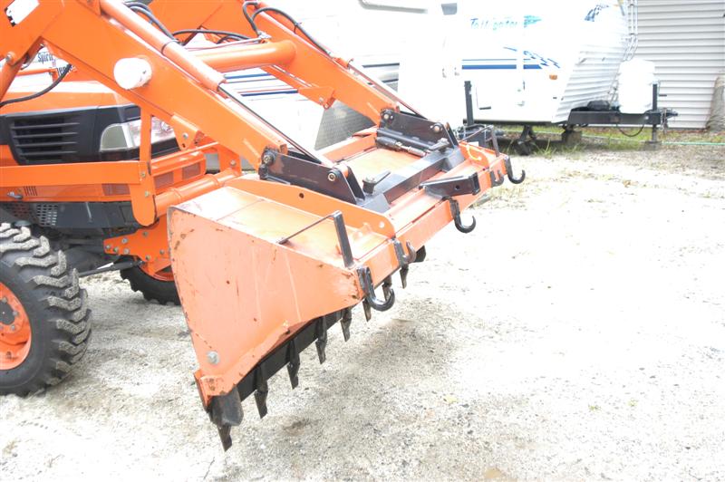

This is what has been working for me for 10 years.

If you weld regular chain hooks onto the bucket...leave the eye portion of the hook alone. It works excellent for hooking cables without the risk of cutting them like the chain hook portion would.
Casco - good ideas - i'd say you're Kubota is all hooked up - or well hooked and ready for chains.
