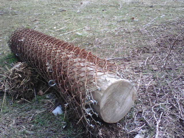

Here is a picture of one I built for $10...... I bought a 20' section of used chainlink fencing (6' wide) and wrapped the fencing around a log and then let about 10' drag behind. Works REALLY well! Apologies for the pic quality - I was using my cellphone camera.
do you put any weights on the back to weigh it down?
how did you keep the fence to stay down when you were dragging?
