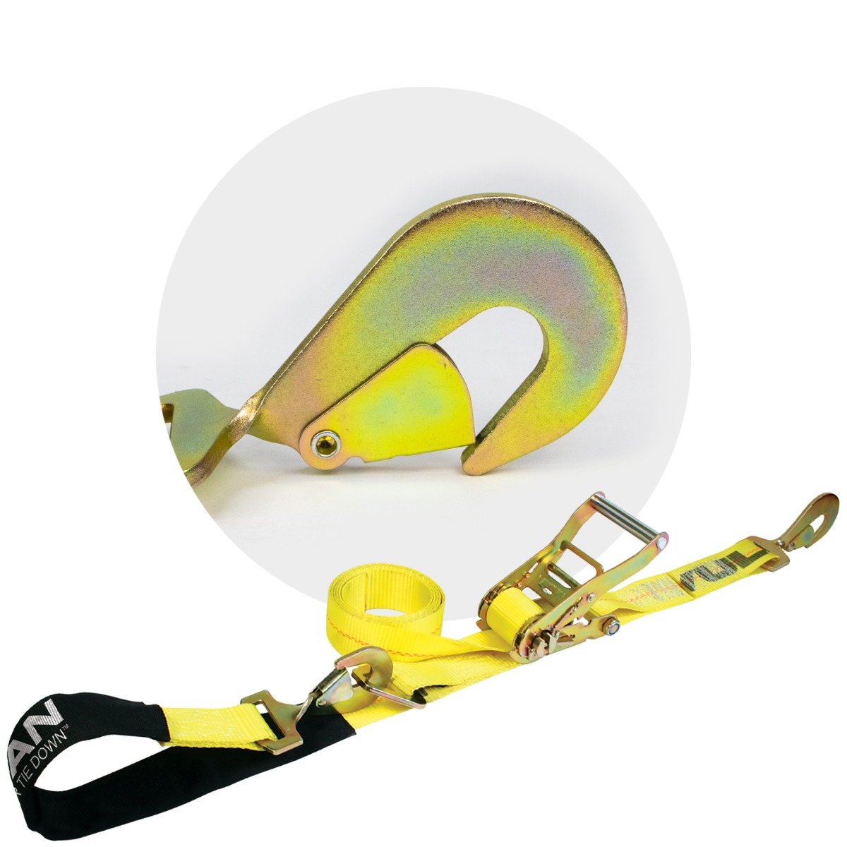

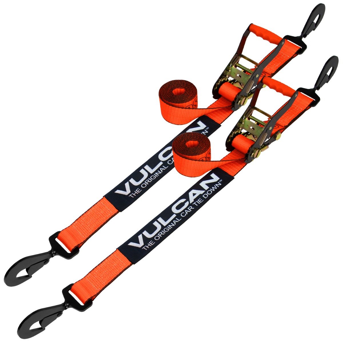

I use 2,500 load capacity 10,000 burst web ratchet straps, on all four corners (Calif DMV/DOT) that give me 10,000 pounds hold and 40,000 burst energy (theoretically) to break tractor loose from trailer, and yes I have a 1,500 pound tractor and 500 pound (+) ballast weight,,, They are actually "leftover" race car tie down straps from a different era....
Similar to ones below....
If using straps, get flat "snap" hooks NOT "J" hooks.... Also include "axle straps" in your search...
And be sure you have adequate tie down rings/points on trailer, funny thing was when I got my "car carrier" there was no provision for tie downs, had to add loops to trailer frame....
