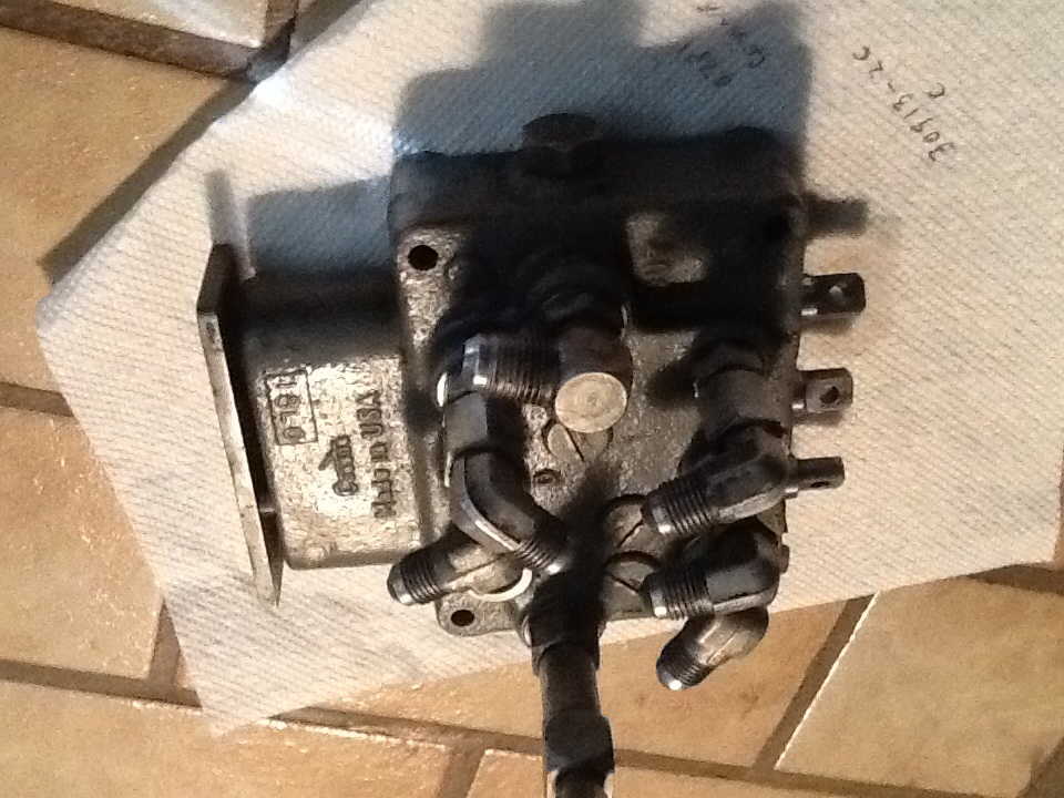

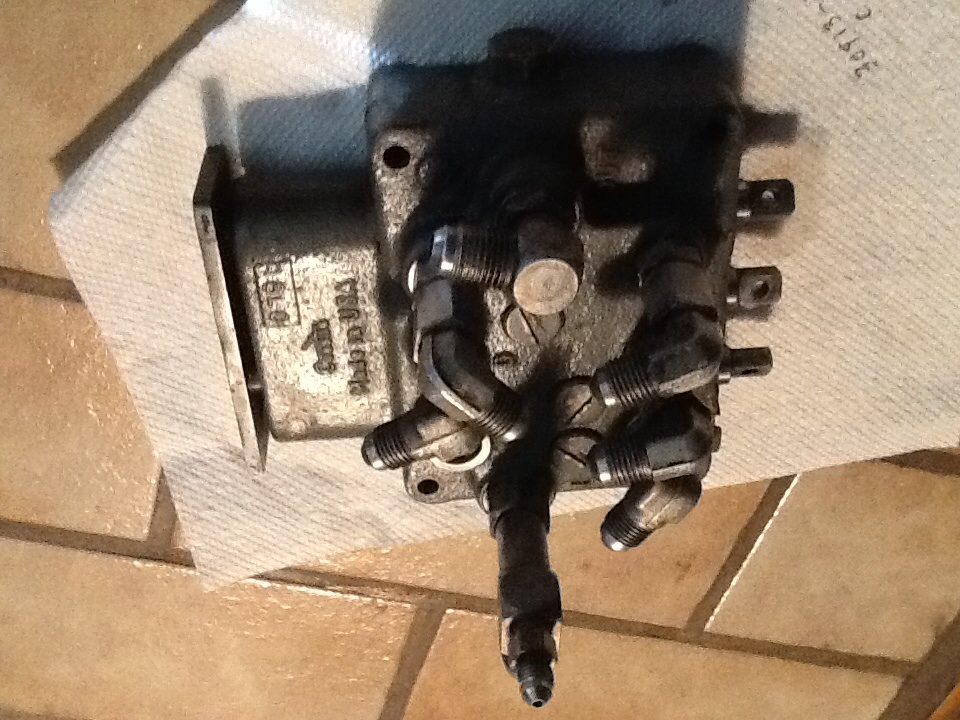

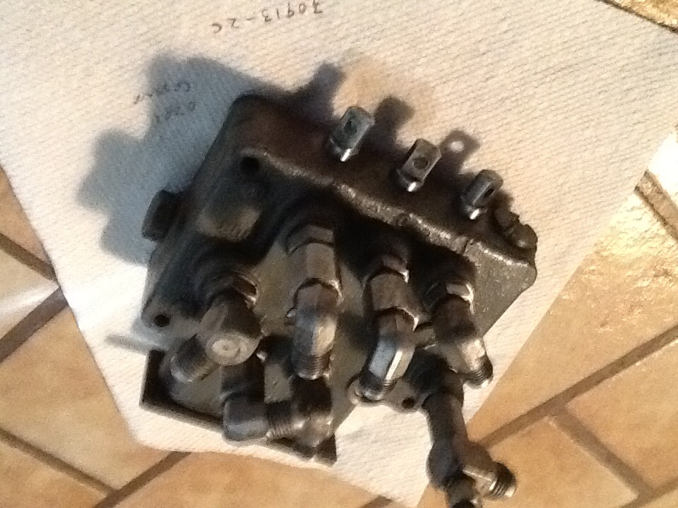

Hello,
This is my first attempt at using this forum, so I apologize in advance if I'm doing anything incorrectly here. I purchased this valve recently, probably before I should have without further knowledge of what I was about to do. I am looking at installing a remote valve for my Kubota L3200HST. I have been reading all I can find on the forum and I think I have learned quite a bit. Anyway I can't seem to find any information about this valve, and wonder if it would be suitable for my purpose. If someone know about this valve, I would appreciate hearing from you. The numbers I can find are 30913-2C. As soon as I figure out to post a picture, I'll do that.

The pictures came out fine.
I have to ask though, why purchase a used hyd valve not knowing what is does and whether it is any good?
If you ask your question on this forum, knowledgeable people will be able to help you and guide you to something that will work and how to connect it all together.
I see the OUT port label.
What is stamped by the other ports.
You might be able to connect it up and it might work OK, or not.

Yes sir, that valve will do what you want.
Be sure you install the PB screw in the C port and use that port to feed the next valve.
The PB from your loader will feed the new valve.
There is no reason you can not try it as a remote valve.
If it leaks or does not work as you want, then just remove it.

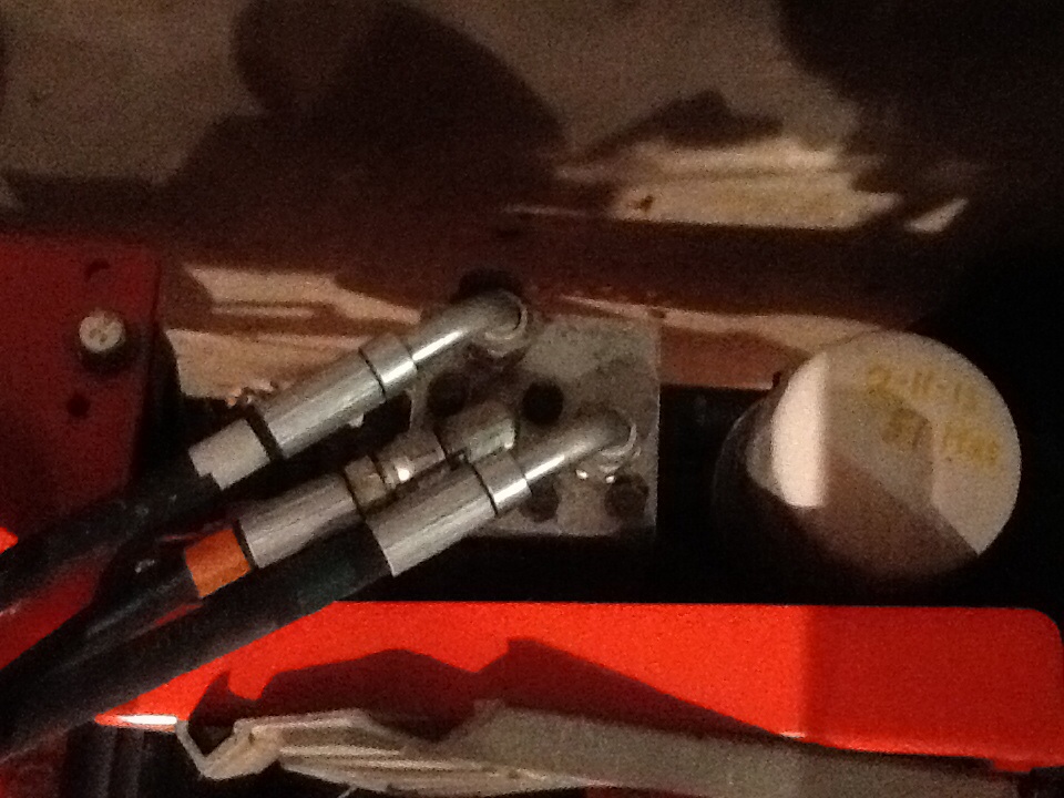

Ok, thanks. JJ. Just to verify that I have the installation right.
PB hose from hydraulic block to new valve inlet, PB screw into C port, then new hose from C port back to hydraulic block PB where first hose was removed, then hose from valve outlet to hydraulic block teed into existing return line.
That should work.
Can you post a picture of your hyd block.

Here goes
/ Cessna 3 Spool Control Valve #16
If I remember correctly, the orange taped hose is the flow from pump.
White is the return /OUT flow from FEL.
The left port is the PB flow from the FEL.
