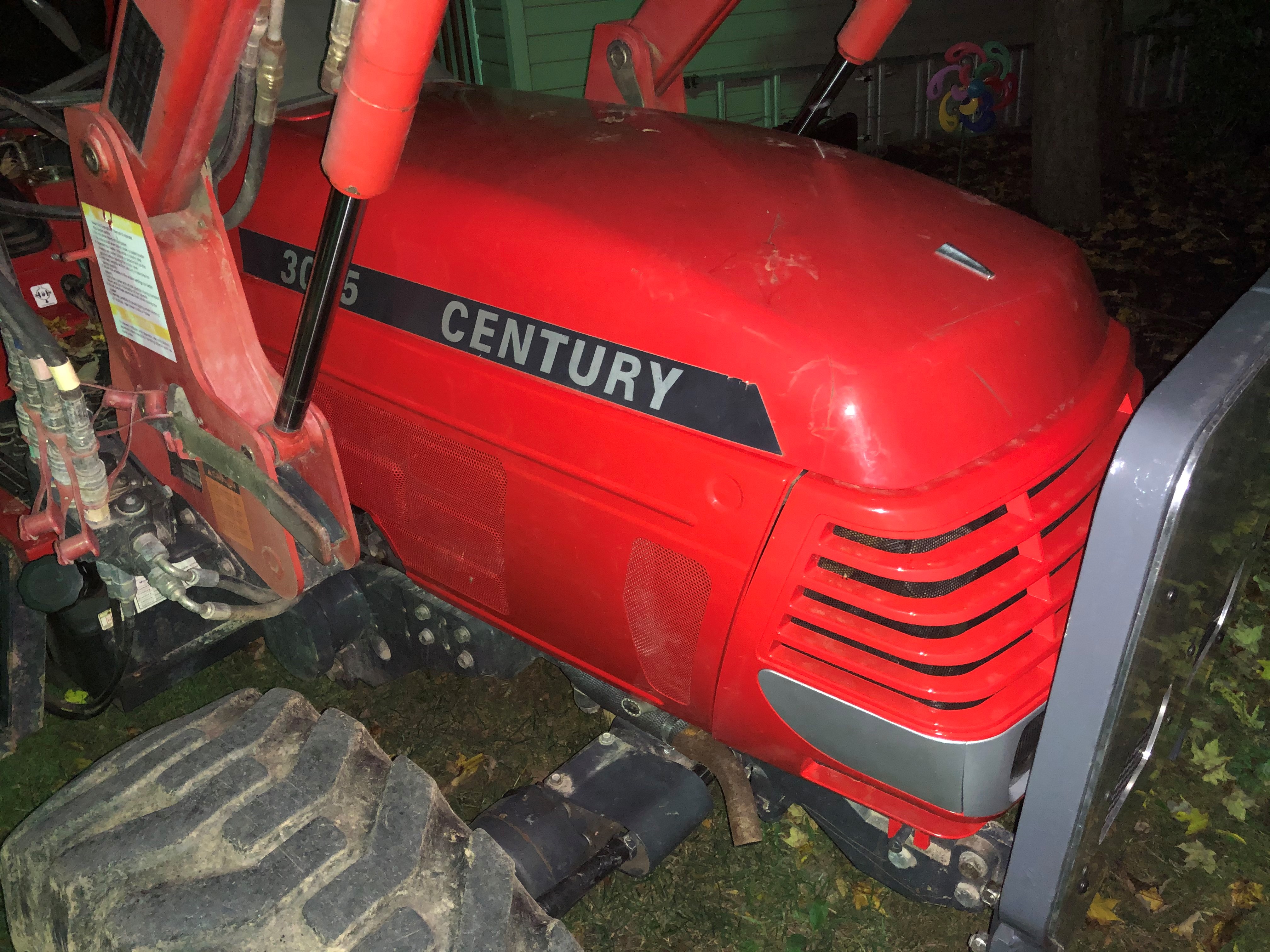

I am looking for the side panels for a Century 3035 or Branson 3520, apparently Branson has discontinued making these. Does anyone know of a Century/Branson graveyard or know of where I might find these?

Thanks for the lead to Panhandle, they are going to check Monday to see if side panels from another model might work. There are a few side panels that are similar but not quite the same, so may be worth taking a chance to see if they can be modified to work. 4520 has a slightly different P/N and 4720 has a similar panel that hinges/slides instead of lifting off. Will update when I hear back.

Asteral, it was good talking with you today. I am going to go ahead and order the side panels for a 38/42/ & 4720 (NTD6870000B0 & NTD6880000B0). I am thinking that a few minor modifications if any will be required. I will let you know when I get them on the tractor. Thanks again for your help.
   / Century 3035 / Branson 3520 Side Panels
I picked up my side panels over the weekend. I am going to have to move the lower mounting points to mate up with the tractor connections. A little cut-off wheel work and some welding then touch-up painting. Hope to have them on later this week.

Picture of the new grill and right side panel. Had to remove the lower panel attachment pins as they are in a different location than the originals. Did some touch-up with Rustoleum Cherry spray paint. Versus welding the pins on in the correct location, I chose to modify the lower mount brackets by bending to hold the bottom of the side panels and adding 3/4" ID rubber hose over them to keep from scratching the side panels.

Good work!

I was able to get the grill from a Branson dealer in Kentucky, Cottrell Farm Equipment. They were able to order from the facility in Georgia. This one is P/N NTD610E000A9, it was a bit pricey at $650. It looks like this is the same one as your 4520. It is nice to have better dust protection and head lights though. The original one was pretty mangled up.
