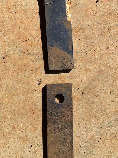

For the past 10 years it has operated without braking any blades. Recently the central blade is breaking regularly (every time is it used now) next to the cup washers. There is no visible damage to the broken blade.

I have stopped the tractor, checked and compared the temperature of the blade bolts. They are warm, but certainly not super-hot. Moments before the blade breaks there is a loud clanging sound and vibrations. Inspecting the half still remaining on the spindle, the bolt is tight and secure.

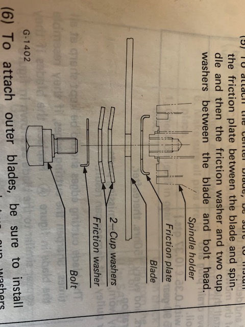

Is it possible I am tightening the bolt too much or the cup washers need replacing?
What purpose is the friction washer for?

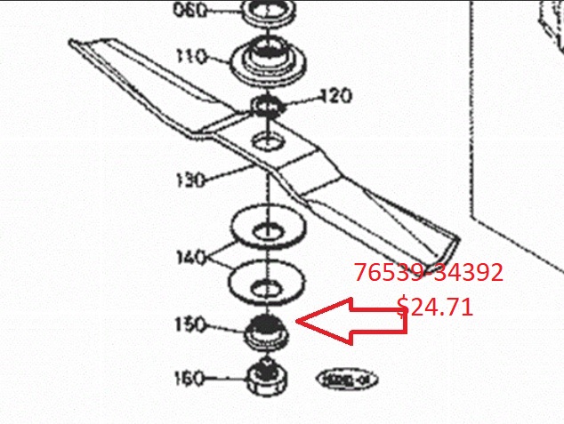

I can only find two mid mowers for a B7100 and neither match the RC70-71.
The two are RC60-71 & RC54-71.

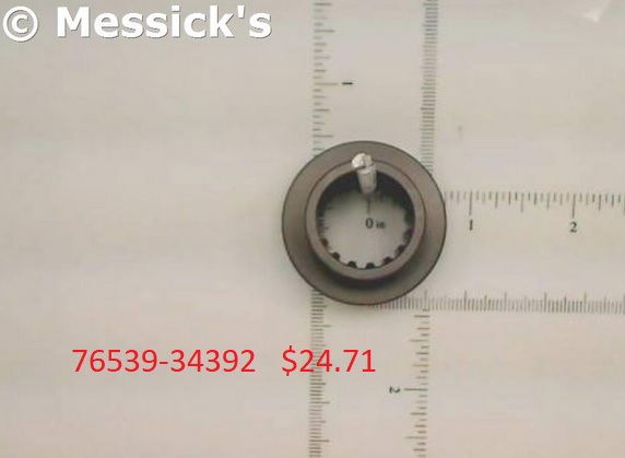

In any event I would make certain your assembly is using the special shoulder washer Kubota calls a JOINT. See attached.
This JOINT will center the blade on the spindle. If it is not present, the blade hole is too large and will not be centered on the spindle leading to lots of vibration and failure.
Dave M7040

Correction. Typo RC60-71H
   / Central blade breaking - Kubota B7100HST-D 4WD mid-deck rotary mower RC70-71H
#9
Thanks Dave for your suggestion,
Rc60-71H doesn’t have this part as the bolt is performs this action. See original diagram attachment
My plan is.
1. Get new cup washers as I believe mine are “squashed”
2. New fiction washers.
3. Make sure the bolt is tighten to the correct specification
4. Inspect for vibrations due balance and alignment issues.
