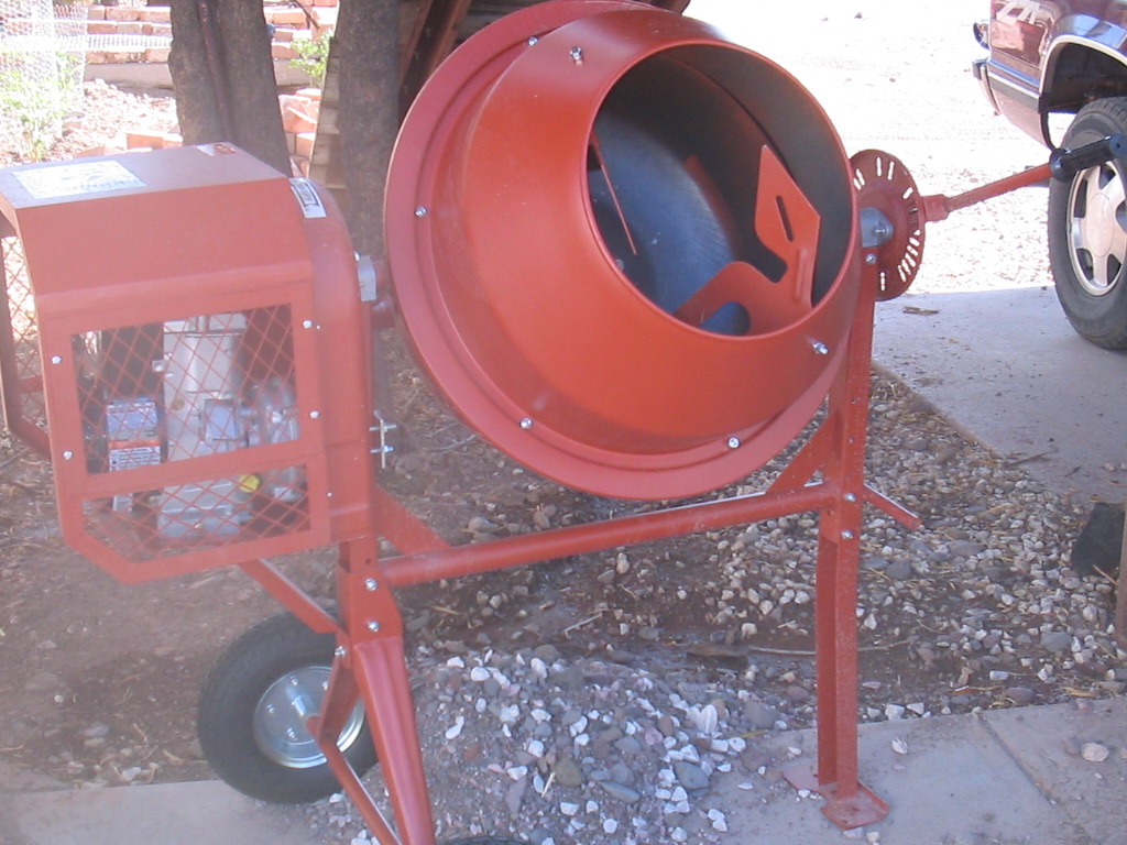

I had two old well used mixers in my life and they were full of crap that I could never get them clean. Finally I sprung for a Harbor freight 3-1/2 cu. ft. mixer. 110 volt and dumps on both sides. I used it for a a 100 foot long sidewalk and mixed the mortar for the full block basement in our house, and a ton of different little projects. Ready mixed works great for smaller jobs but I just got a couple yards of sand and gravel mixed and did it that way for a bigger job.
It is heavy enough to where I can mix a load and it will fill 3/4 of a wheel barrow full. I am a big guy, but that's all I want to handle.
If it was on sale for $159-$179 and I needed one, I would get another one.

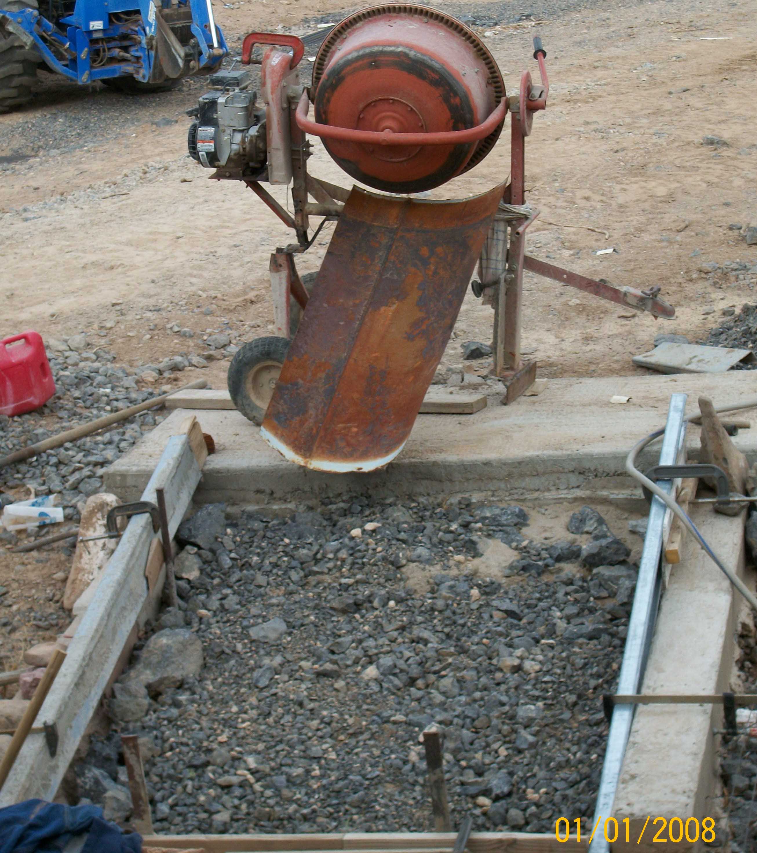

I would pass on the 3 point mixer. You can't always get it where its needed. More important (2 Me anyway) I use the the front bucket or forks 2 pick up the bags of cement so they do not have to be lifted, just open & dump or shovel.
The HF 1/3 yard is a pretty good mixer for the money. I got mine with a B&S gas engine so's it could be used any place, any time. Little problems, mixer is a little 2 low, with gas engine was tail heavy and front foot is to narrow.
Rear of mixer was raised about 4 or 5 inches, moved axle back about 4 or 5 inches, a wide front foot was added along with a weight. Also put on a tow tongue, that can be used with a ball or long bolt.
Its worked hard for almost 5 years and is still ready for more.
Some dummy who shall remain name less,:) loaded it way past design capacity managed to tip it over. ( Before front foot was made wider.) It laid on its side still running until I figured out how to set it and a full load back up.:laughing:

I'll add another to the list of those that said to get a 115 volt mixer. I prefer the one from Northern Tools over the one from Harbor Freight. I've had better luck with stuff from Northern Tools than from Harbor Freight (and I buy from both, depending on the item). I have the 4.1 CF model (# CM350A)and it's held up very well. Can't count the number of bags of mix I've run through it.
cement mixer from Northern Tool + Equipment
One important thing I want to point out and I've seen some make the mistake. You must have the mixer running before dumping in the mix. Don't think you can put in the water and cement mix then turn on the machine. You'll quickly burn up your motor. They do run them on sale occasionally and if you sign up for it, they send out discount coupons.
