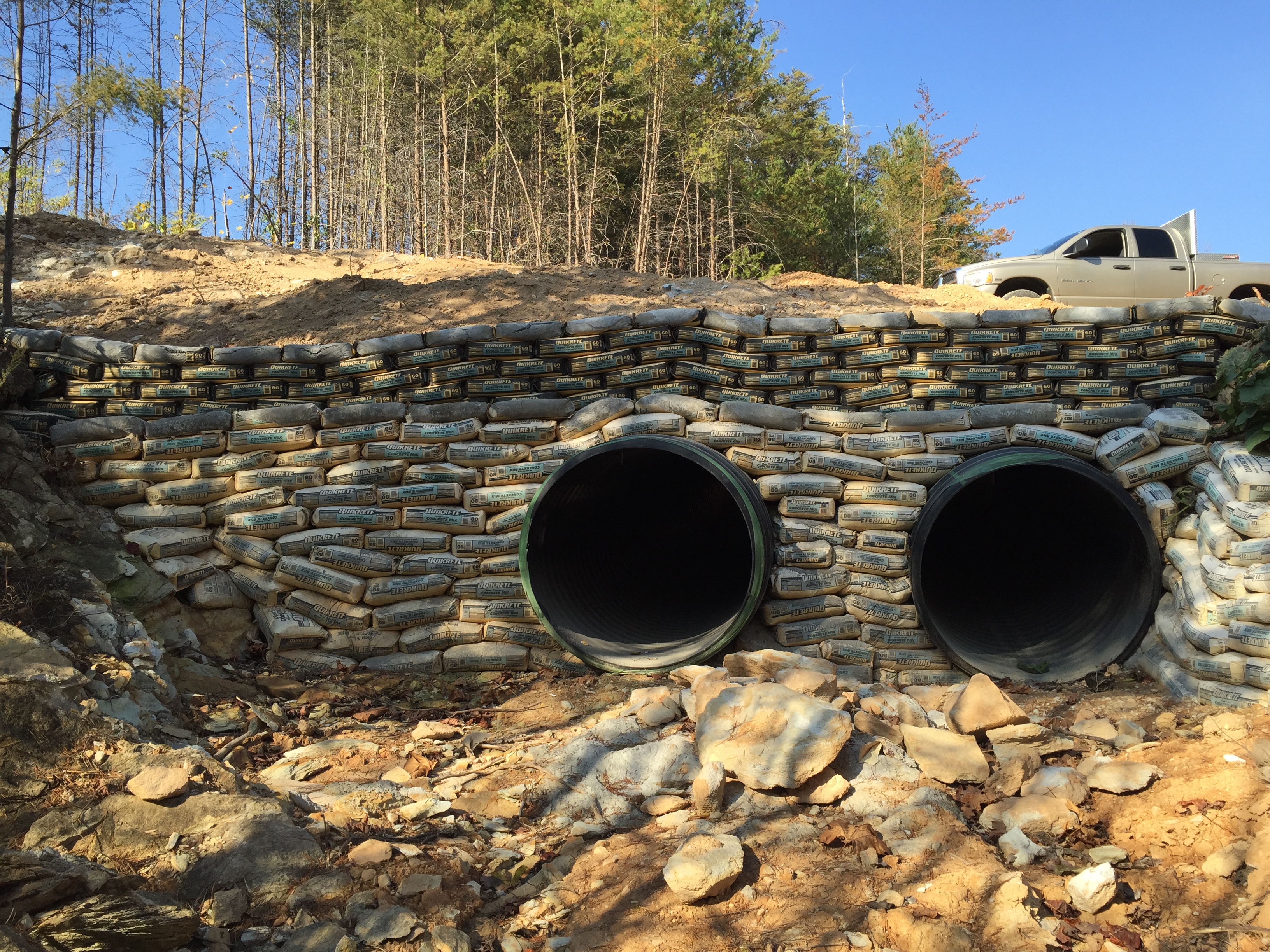

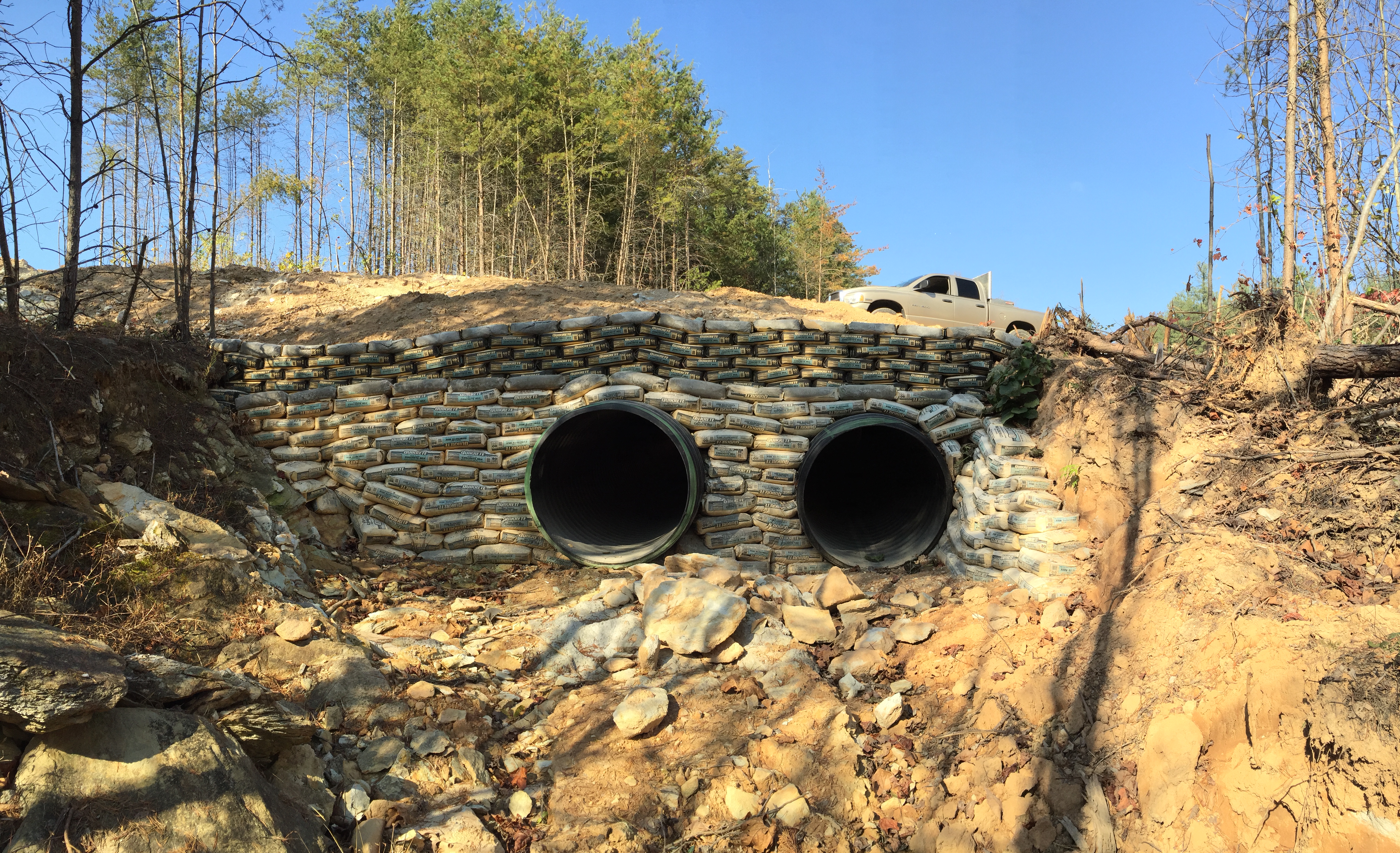

And finally, the view from the bottom .
   / Cement Bag Retaining Wall #122
nicely done. I love living on the property now and see there is now 350 acres behind me for sale but they want way too much. I will wait a bit then offer a bit lower. I like the cement bag wall. I think it will work very nicely.
   / Cement Bag Retaining Wall #123
Hmm, i think i see a lot of the sacks are installed upside down ! Hope they still work ok :)
Looks really good.
   / Cement Bag Retaining Wall #124
Woodchuck - I found I had to add more rocks at the end of the run out pipe on my culverts. The outflow was washing away the soil and undermining the pipe.
#125
I plan on adding more. I have a stack of granite cutouts that I will toss on the bottom then put more rocks in on top of those. Right now it hasn't been a problem because we haven't had any appreciable rain since I built it. So with the exception of me pouring a bucket or two of water in it, nothing has run thru it.
   / Cement Bag Retaining Wall #126
That worked out great, good work.:thumbsup:

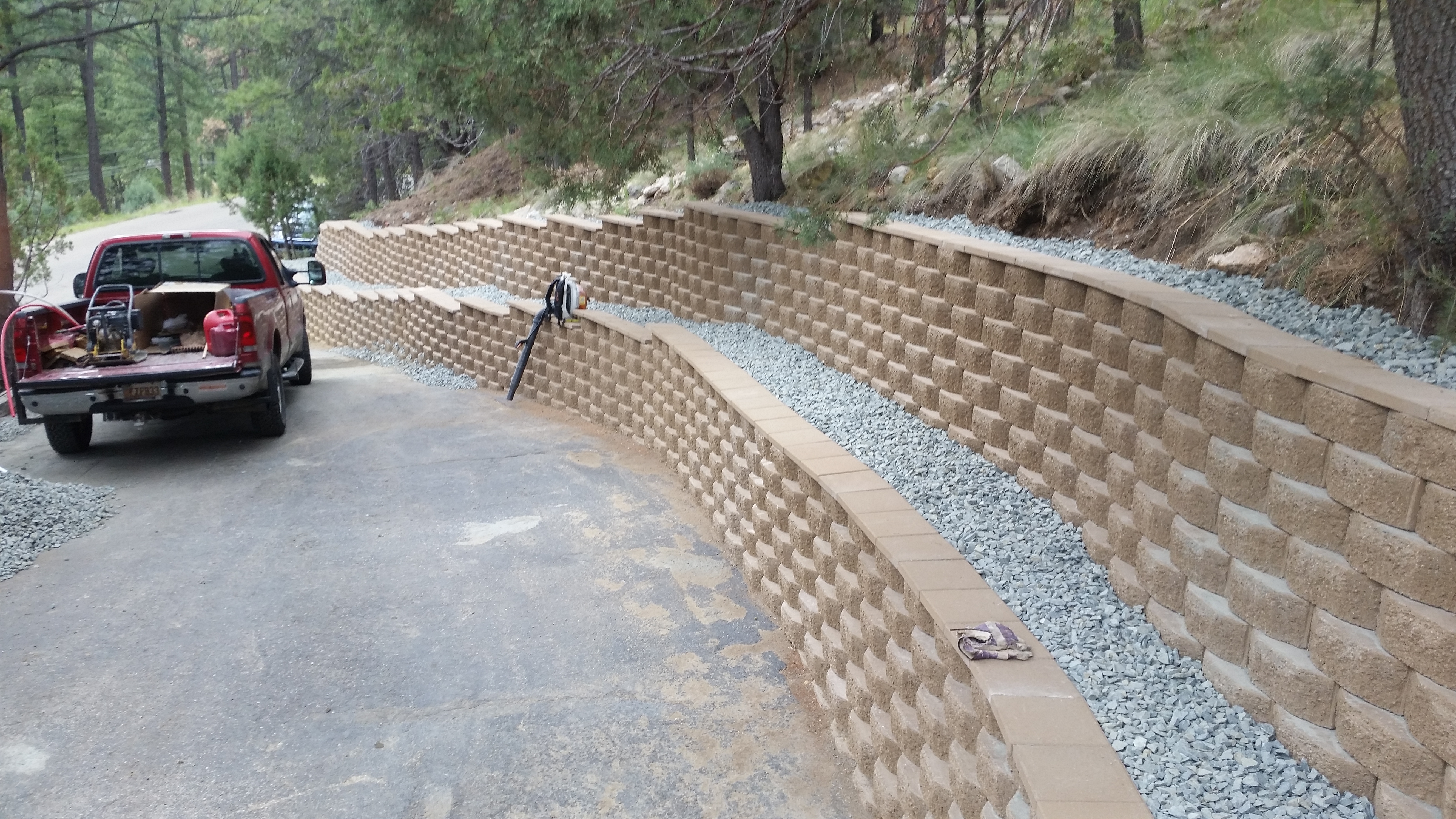

I have used sack walls for ditch bank repairs on irrigation ditches and they work very well. I considered using the sacks for retaining walls on customer properties but found the stackable block to be close enough in price. I get the 62 lb. retaining wall block delivered up in the mountain sites for $3.50/block.
Here are a few pics of a retaining wall we built early this year.

   / Cement Bag Retaining Wall #127
That is a very nice looking job.
What do you like to use for masonry adhesive to hold the cap blocks on?
What do you prefer to use to miter the ends? And do you miter one onto the square end of the last one (can look OK for small bends) or do you always miter both pieces?
How did you support the upper tier?
I suspect there is drainage inside all that, too, yes?
   / Cement Bag Retaining Wall #128
I used Loctite Pro Line Premium construction adhesive in the 28 oz. tubes for the caps. So far so good it has held up on other projects for the last two years or so. Just have to see how it holds up long term.
I prefer to miter both pieces, otherwise the length of the sides won't match. I use an 8" tile saw to cut the caps.
As I build up each layer which is 6 inches height, we compact engineered fill with a plate compactor. The larger 1 1/2" rock is about 4 " layer to dress it out. This rock is large enough to allow us to use a blower for clean up of pine needles and leaves without moving them.
The water from the hill above can run through the rock to each side of the property. Worked pretty well during the summer rains this year. Water can weep through the wall if necessary but since it is all compacted from the bottom up it is an insignificant amount.
