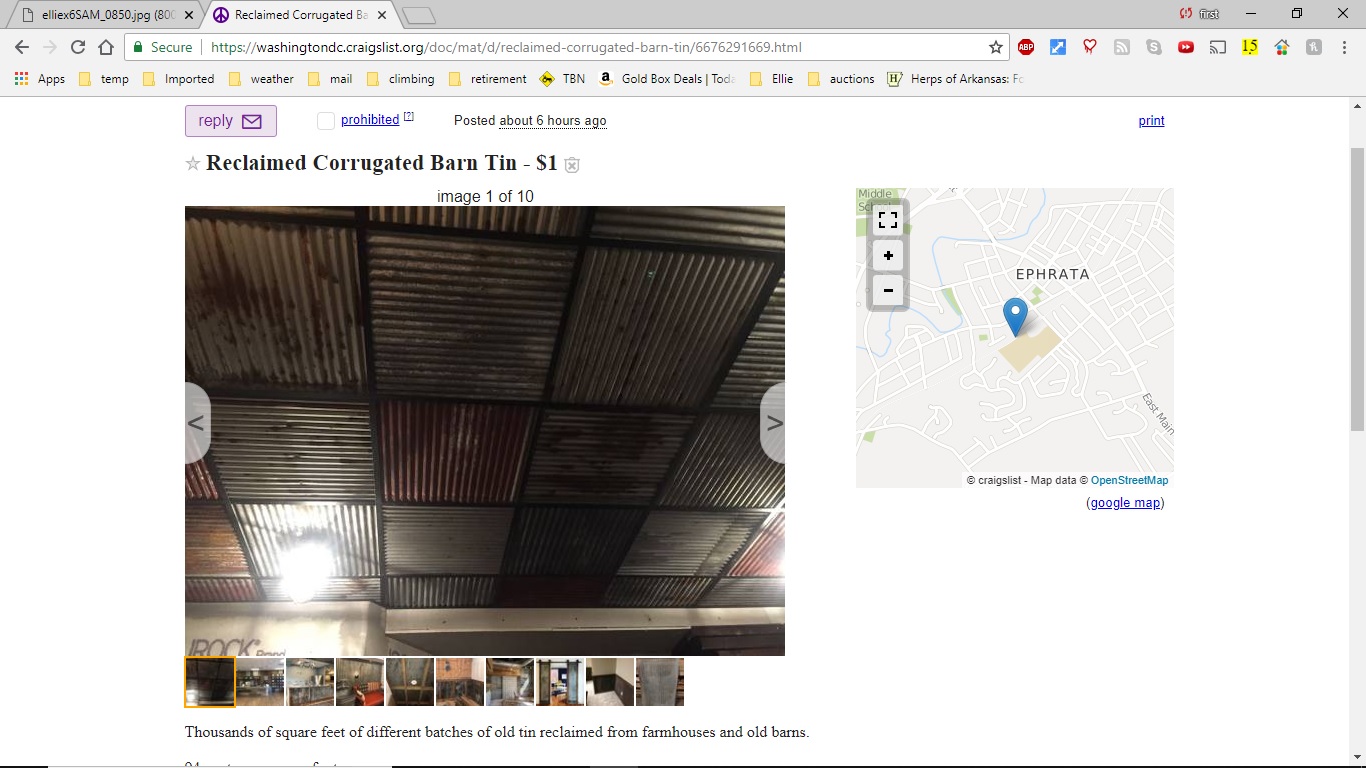

Here's an idea:
attachment.php
Apparently it's the new "in thing".
I'm thinking of doing my ceiling with what I ripped off the roof :)
