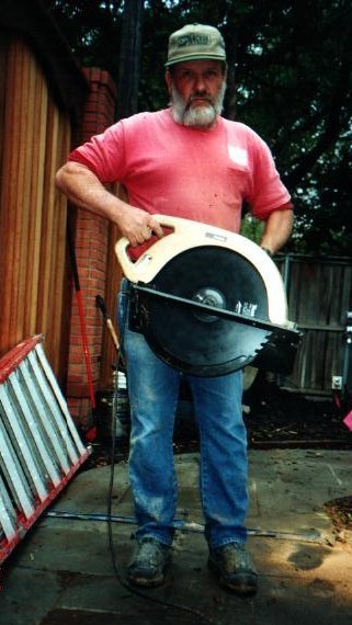

I have to share my secret to doing that job.
   / Cedar for pergula (sp?) #10
Now dahlin' that's what I call a saw!!! It's a Makita beam saw. That's a sixteen inch blade.
It's a one man tool, really. What I found, luck, I have it. I found a speed square that is special for something or another. Where it's different from regular speed squares is the flat edge is about an inch and a half deep. That allowed me to use wood clamps to hold it in place for my cut. Then I'd put that little gold baby up there, squeeze the trigger, wait for it to wind up, yup, it winds up about like a turbine jet plane motor. Then I'd push it through using the speed square as a guide.
Some of them boards I used started off being well over a hundred dollars. Then we cut them. If we cut them short, I had an expensive toothpick. Enough to make one want dentures.
