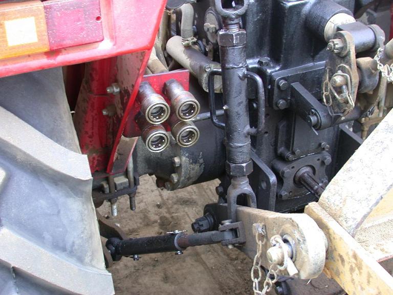

I need some help filling out your Custom Fit questions on your website.
I have a 2005 KAMA 554 tractor, are you familiar with that model? I don't know if it has a closed or open center on its hydraulic system. I do know there are two levers that operate the hydraulic ports to the rear. It has two exterior sets in the rear.
I am attaching a picture of the rear end where you can see the connections, the top and side links too. Please send me a PM because I want to purchase a complete system from you. I want to make sure it will fit and work properly.

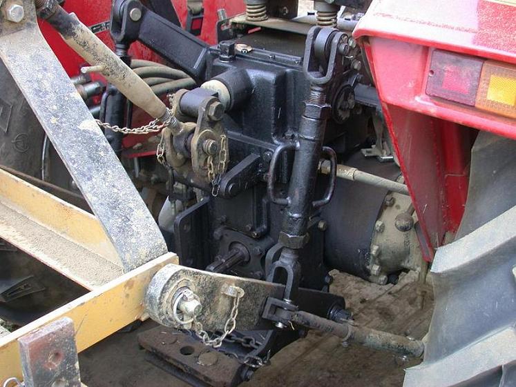

Attached is another photo of the side links on the tractor.

Since you already have 2 rear remotes all you would need is a top link cylinder and a side/tilt link cylinder and corresponding hoses and fittings. You do not need any additional valves. Just measure your top and side links for max and min extensions and order the appropriate cylinders from CCM.
