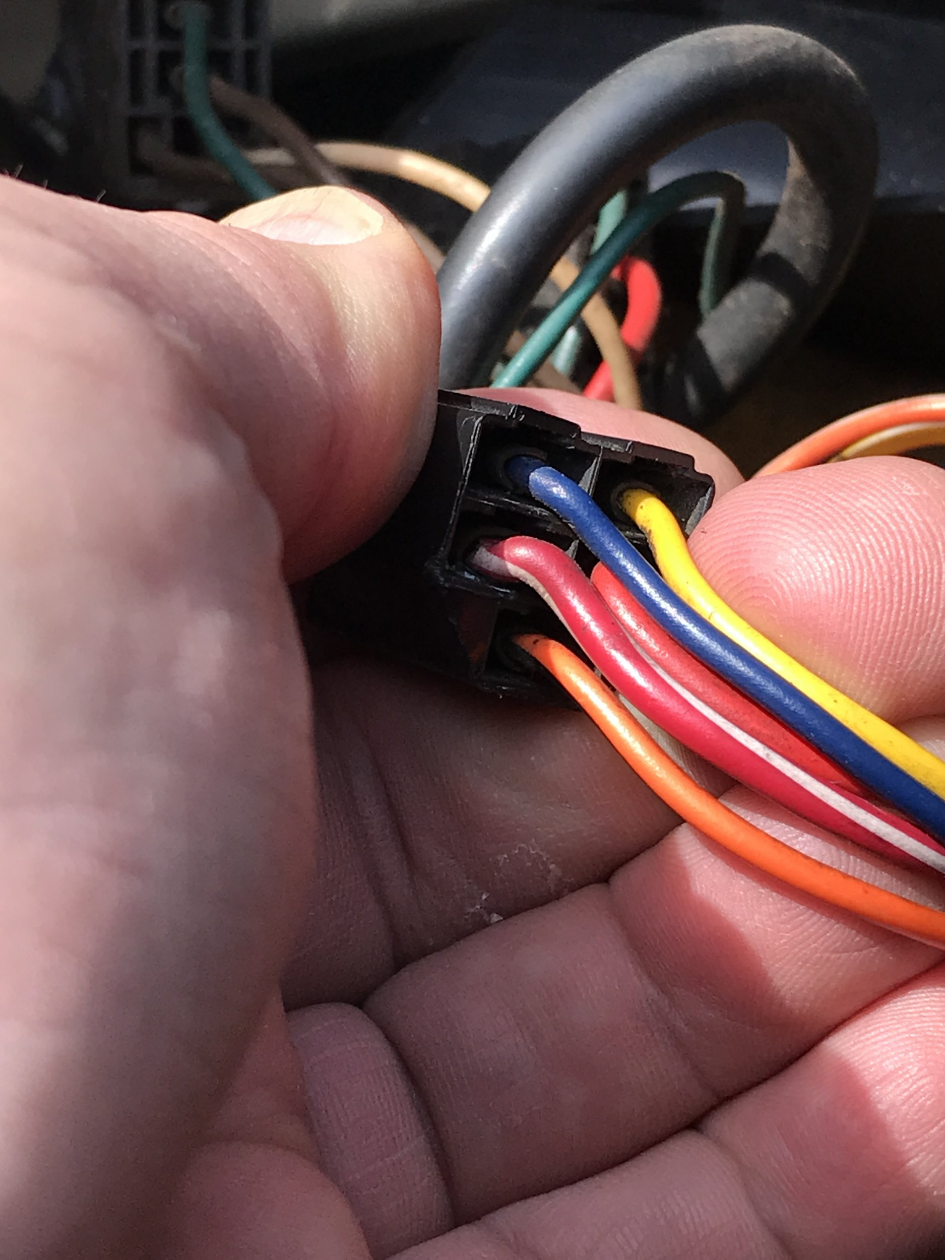

I like your choice of wire, individually timed strands is the best for this application.
The next important question, how do you plan on making the connections to the old harness wires ?
If the old harness wires a bright and shinny where you cut them back, then I recommend that you use non-insulated crimp terminals, then solder. If the wires are crappy looking, the just the crimp will do. Remember, use some shrink tubing with sealing adhesive in them. This will insure that the connections will not corrode in the future.
https://www.amazon.com/gp/product/B08F3ZM6Z9/ref=ppx_yo_dt_b_search_asin_title?ie=UTF8&psc=1
I've used these solder heat shrink butt connectors on my trailer, and they've held up well. I twist the two conductors together.

The Rest of the Story:
I finally had some time to finish this job:
Prep new wire: Strip, crimp and solder. Add heat shrink
Insert spade connectors into the plug body.
Some more heat shrink as a strain relief.
Splice the new plug assembly into the existing harness.
Add some 3/4" wide woven sleeving, with heat shrink on either end and...
All done!
Thanks for your help, everyone!

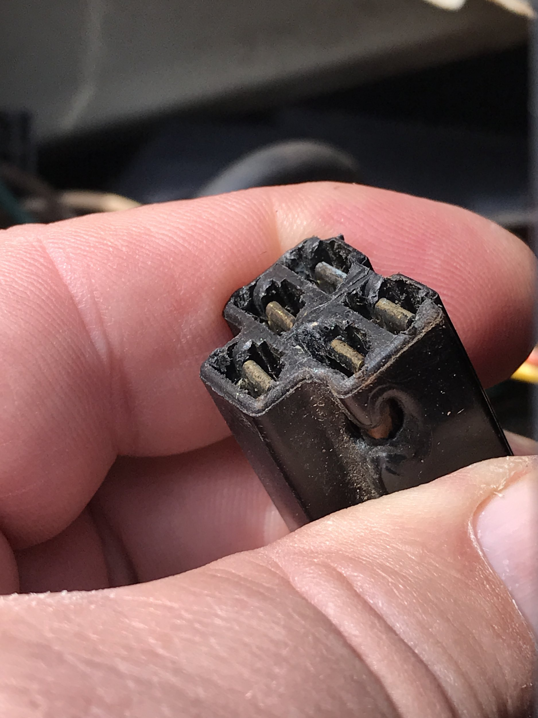

Looks good.
I'm not sure that putting shrink tubing over the connector is a good idea. It's a great place for water to collect.
Did you clean the connector contacts on the switch ?
Richard

Richard, I'm going to put a piece of heat shrink around the back of the switch, overlapping the harness heat shrink.
The switch is getting replaced because the headlight position is iffy.
