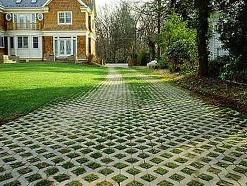

I know you said no concrete and that stone was ok, what about concrete blocks that are intended to be driven on and allows grass to grow thru them? What size of area are you looking at? BTW, These are not the normal cinder blocks you get at the big box store. You may have to order them - I've no idea as to the cost. Nor have I used them, but have seen them used in the neighborhood.

3Ts, I thought about something just like that. Would be quite a job to install, but might work. The "only" issue "could" be driving my tractor / truck across it might mess it up ? The soils here are.... crap when wet. But, using something like that would seem to be the best option. Thanks

The open pore cinder/cement drainage blocks used for driveways are likely going to be unappealing to cattle for crossing. It is going to be hard on their hooves unless it gets fully filled. (Think cattle guard.)
If the blocks are placed correctly, they will hold up to your tractor just fine. I think that if you have clay soil that liquifies, those blocks are also going to be a challenge to place; my guess is that you would need to dig down 18" or so, put in geotextile, then two six inch lifts layers of base rock (0-3/8"), compacting each lift, and then put your blocks in, spread gravel to fill the pores, and then compact that. But they really are meant for flat use, and then where is your water flowing? If you want place the blocks on a slope, you will probably need a flat steel plate on the lower edge to support the sloped blocks to keep them from shifting.(A steel edge guard for lawns, or water tanks should work.)

With just a quick google search, these are called turf blocks and are about 16"x24"x3" they come 94 sq/ft per bundle/block (2200#s)and are about $250 per bundle or block. They need a compacted sub base, geo fabric and 6" base to let the water seep into then get absorbed by the soil and a sand setting base according to the spec sheet.
