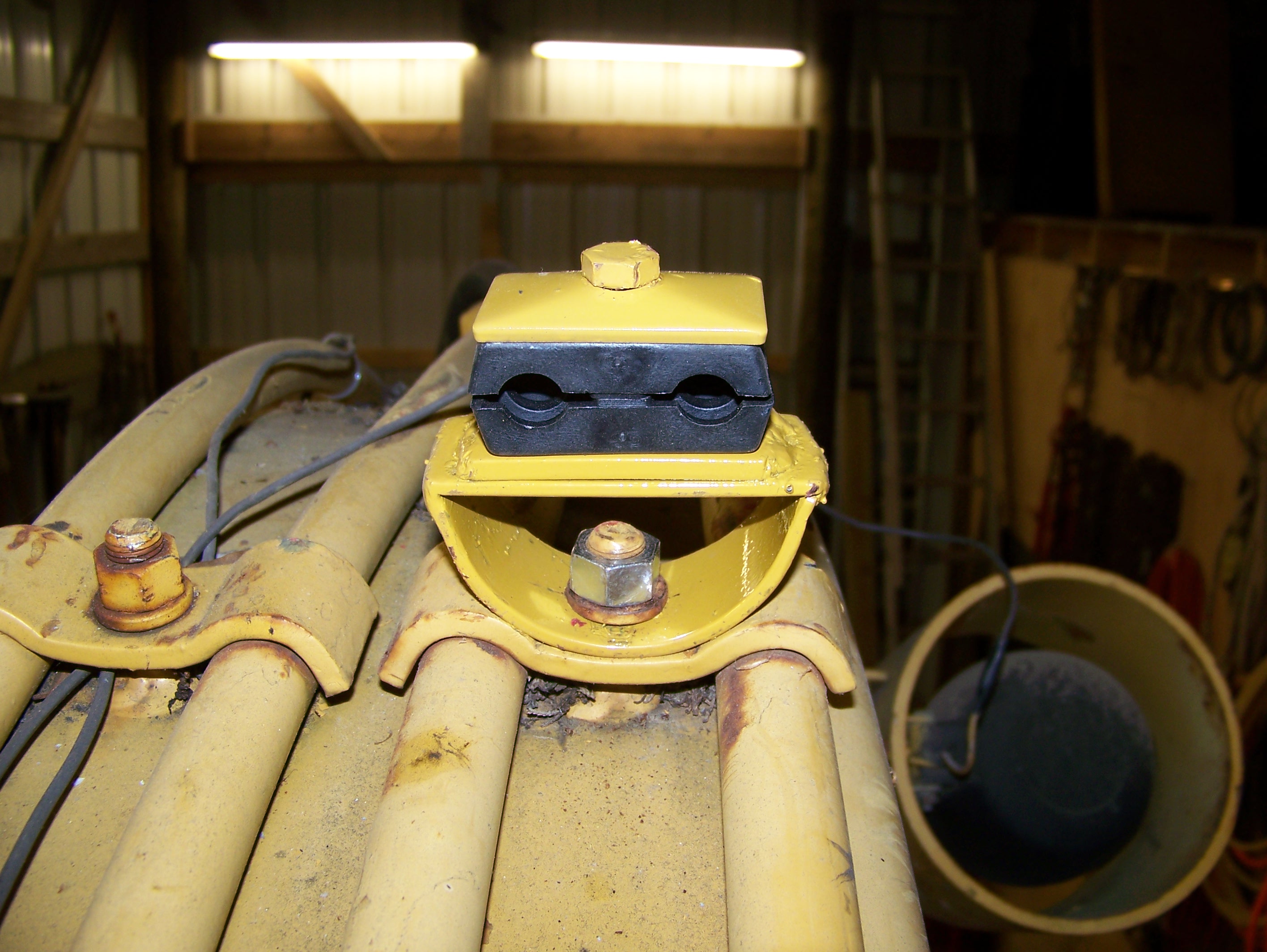

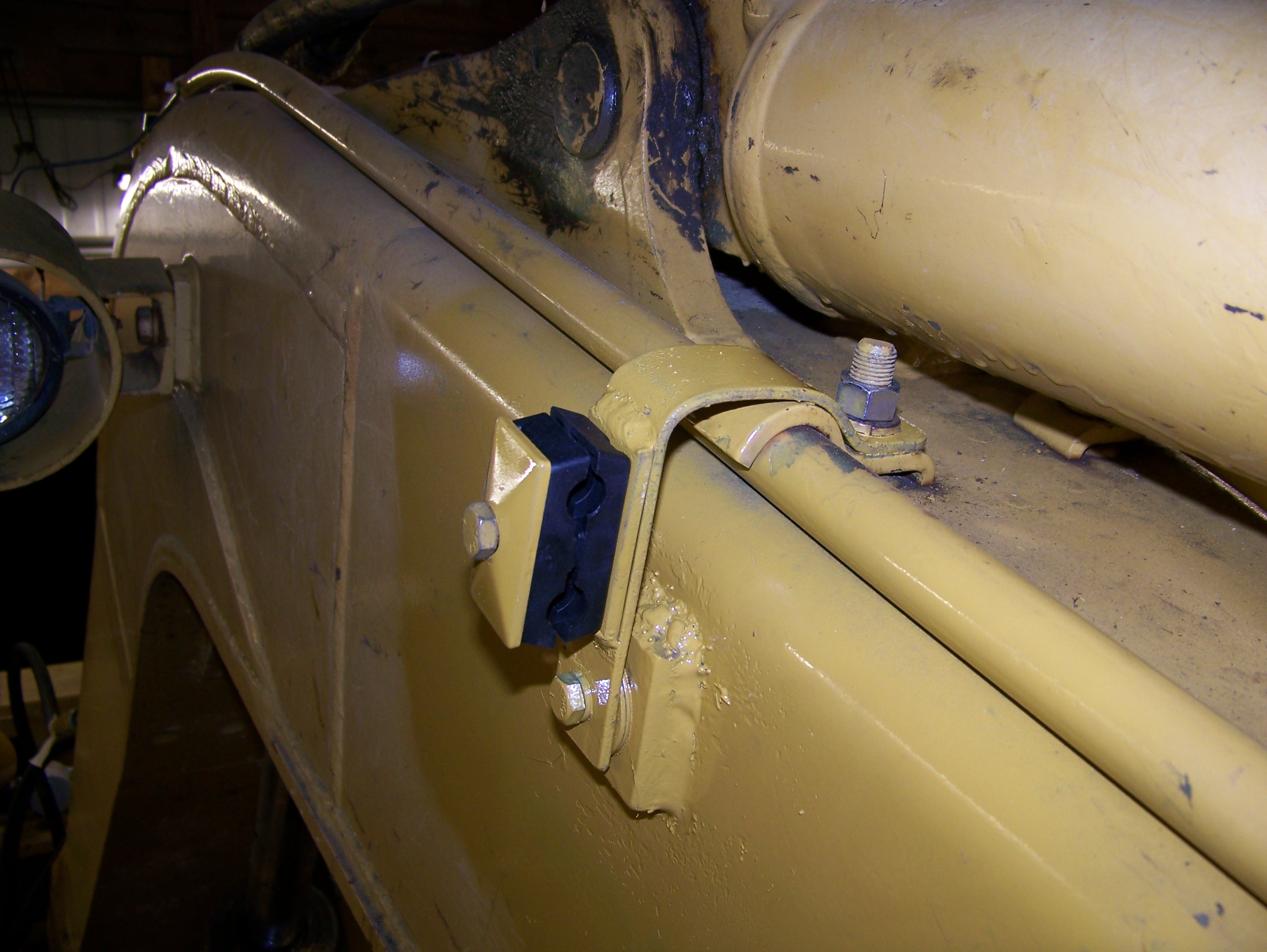

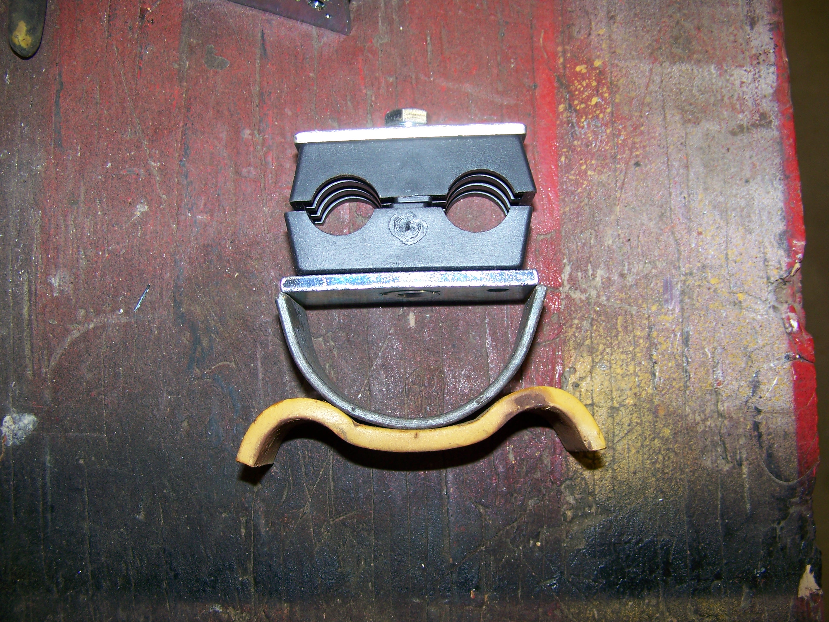

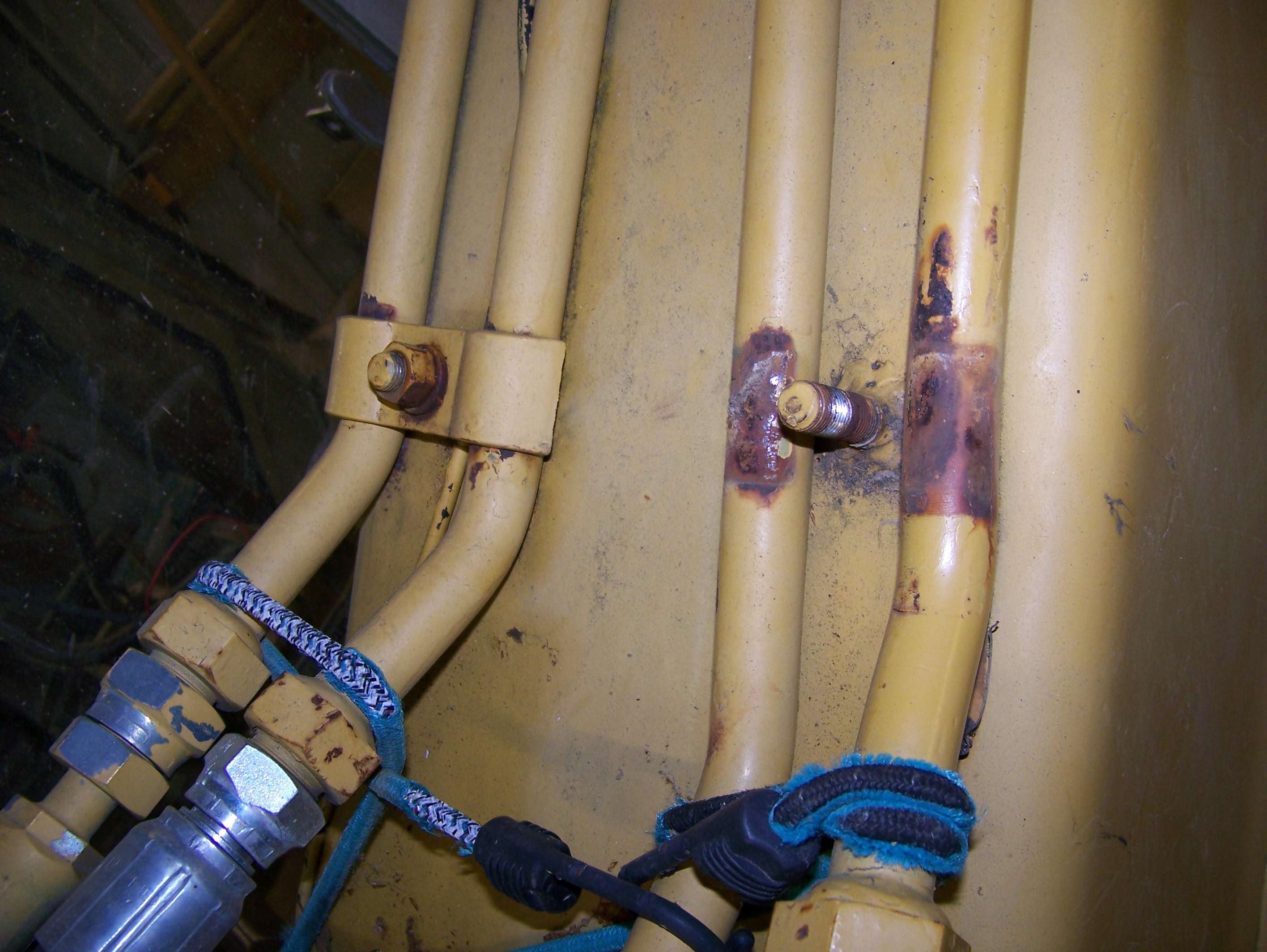

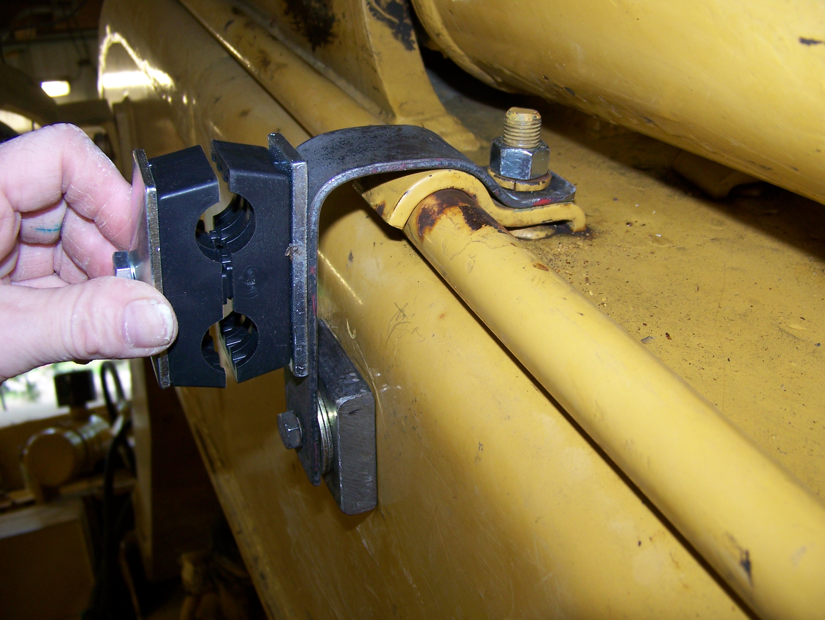

I have been busy today making clamp brackets. Here is what I got so far. The boom side mount bracket and the QD bracket will have tapped holes in 1/2 inch plate that will be welded on. CAT Boom Clamp Mount Clears Cylinder.jpgCAT Boom Lines Where Piggyback Clamp Will Go.jpgCAT Piggyback Clamp Mount.jpg

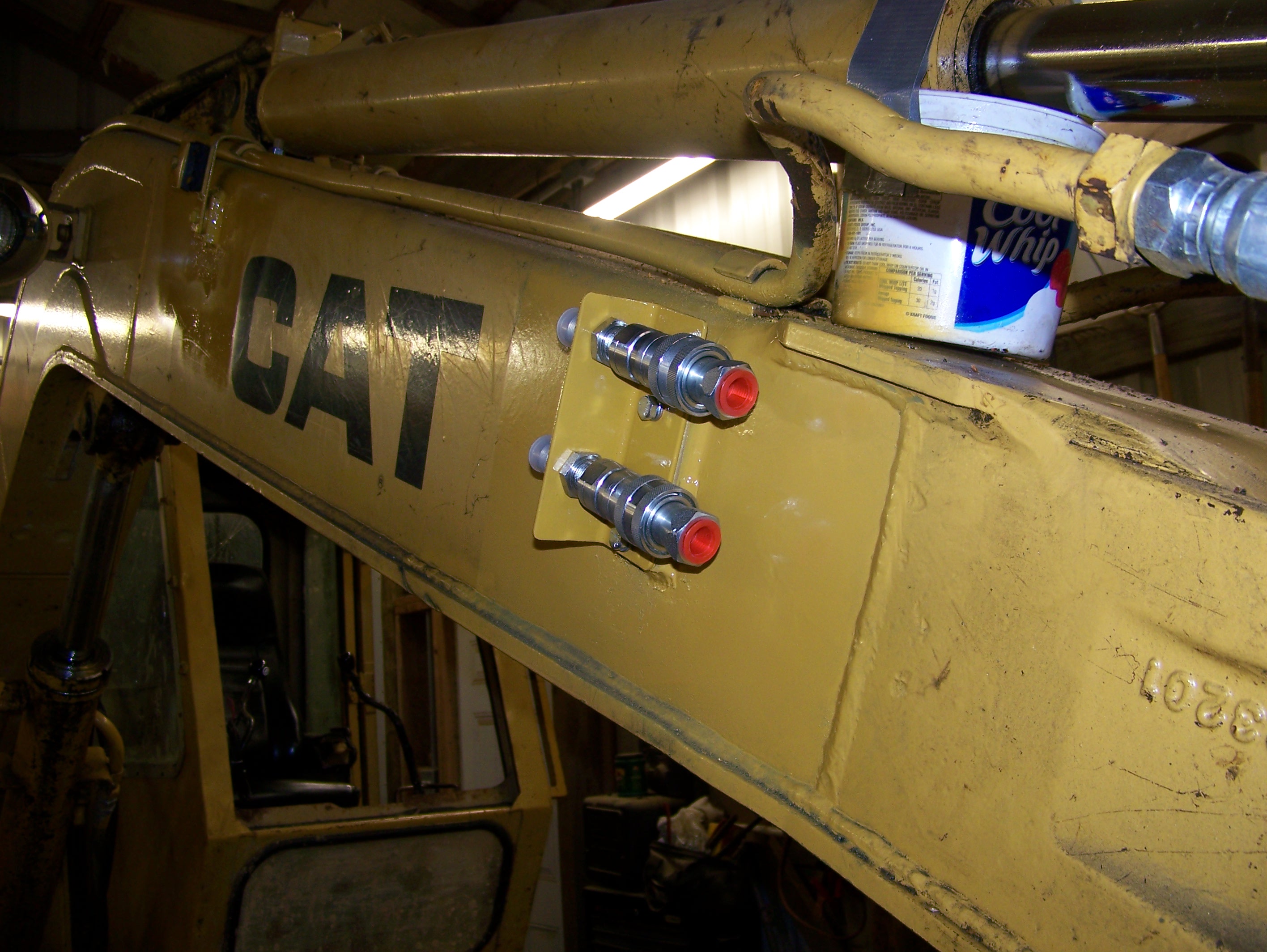

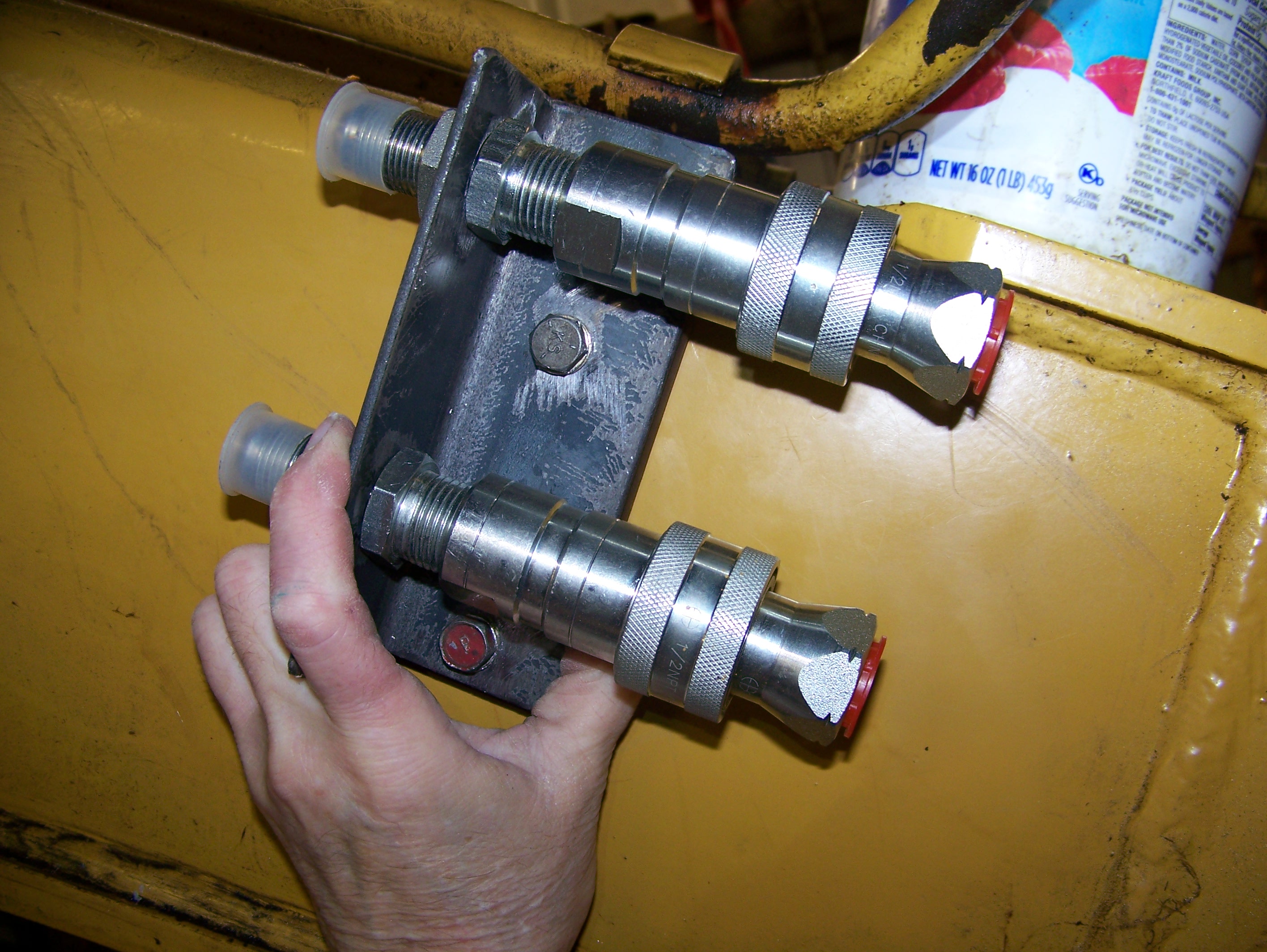

..............and here is the QD Mounting Bracket.CAT Thumb QD Fitting Mount.jpg
Small X about a foot in front of the T is where the QD bracket will go.CAT Boom Clamp Mount Weld Locations.jpg
hugs, Brandi

The 1/2 inch line clamps came in yesterday. Since I was off tonight, I got to weld them to the brackets and installed, along with the QD mounting bracket and plates.4-13-17 Thumb Line Clamp Boom Top.jpg4-13-17 Thumb Aft Line Clamp.jpg4-13-17 Line Side Clamp Installed.jpg4-13-17 Thumb QD Bracket Mounted.jpg

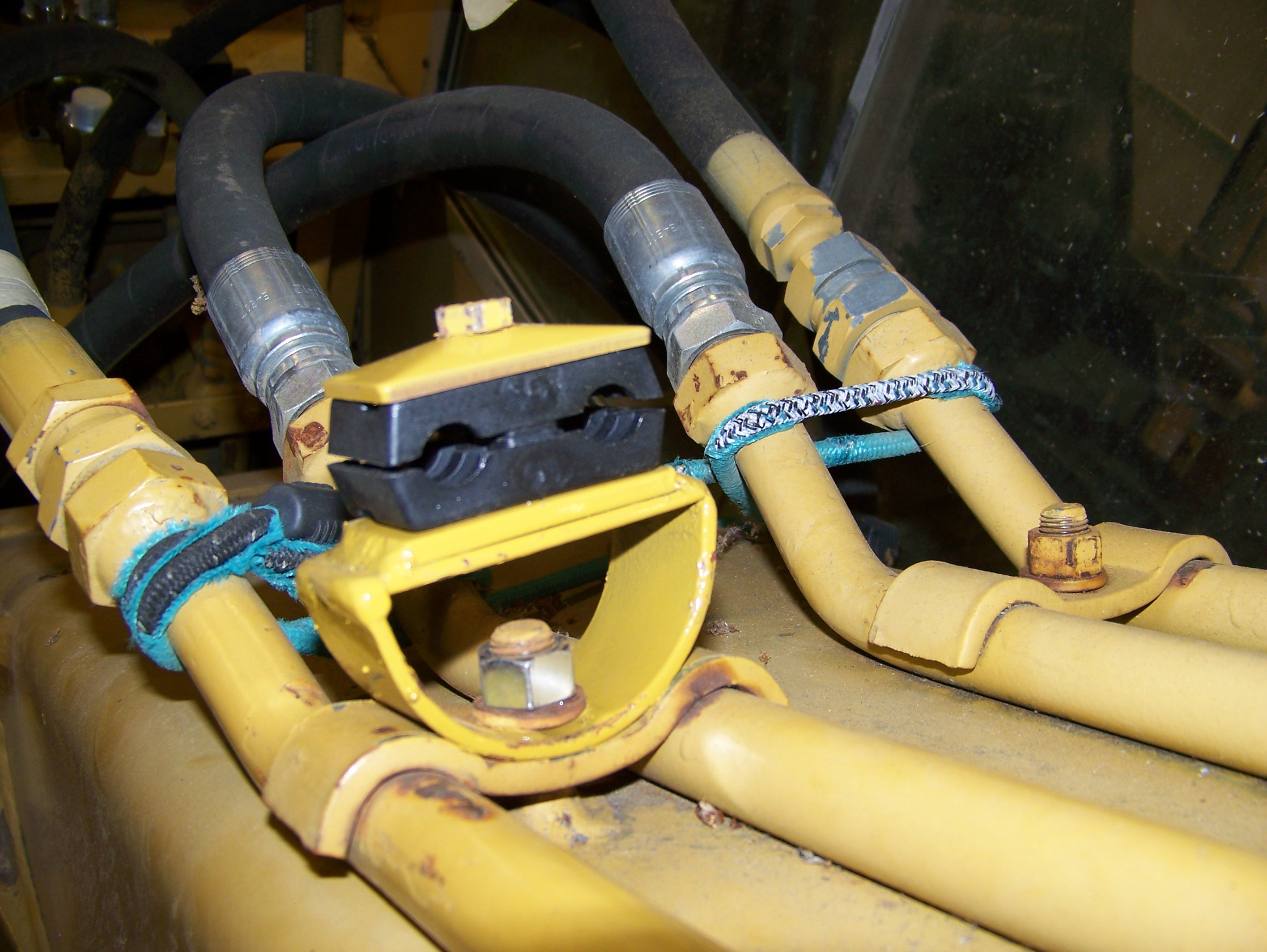

Found a couple pix of the flareless JIC's on my 580 (part of a larger project incl. loader QA, grapple, etc) - these are 3/8", don't need speed for anything these extra remotes will control - sorry about the "bundle of snakes", I wanted to keep these as low to the deck as possible :D
Where did you buy the stainless tubing and what it is? 304? What wall thickness is it?
hugs, Brandi
   / Caterpillar Diverter Valve #67

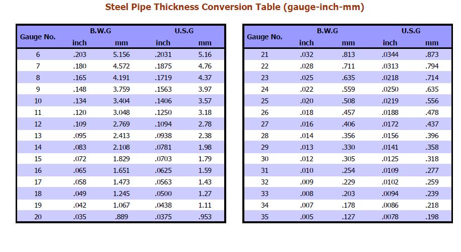

That was 3/8" x .035 wall 304 - normal hydraulic pressures no problem at that diameter, larger (like 1/2") should be at least 18 ga. (.050" or bigger) - those pieces were actually from "dumpster diving" at work - up til the last 4-5 years I worked (rare metals plant) they allowed us to buy scrap from the dumpsters (separate ones for mild, stainless, zirc, Ti, copper, etc) - IIRC, at that time mild scrap was $.05/lb, stainless was $.10...
If you can't find any locally, here's one source
ASTM A269-1 34 Stainless Steel Round Tube | Buy Online | Cut to Size | No Minimum Order
check out the price difference on different wall thickness - 16 ga. 1/2" tube is less than 18 ga. ??? so if you're not desperate for that last little bit of flow, it's cheaper and sturdier to go thicker wall...
Also, note that they will cut a 20' stick in half, should make shipping a little easier. Here's a gauge chart if you don't already have one... Steve
