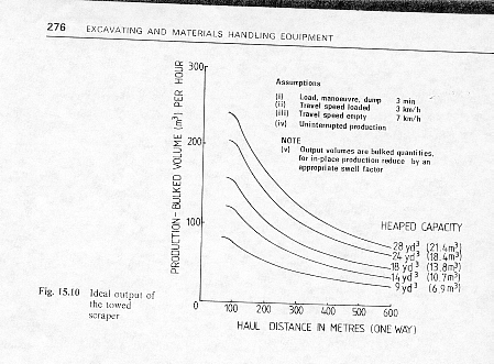

   / Cat D6, D8 vs Excavator & dump truck #14
Weed, here are charts of production for towed (cat and scraper) and self propelled scraper. I'll post towed first then self. Wally

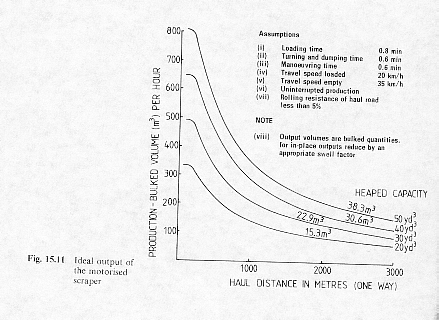

   / Cat D6, D8 vs Excavator & dump truck #15
Here is the self power scaper chart. I don't have a dozer chart but have track and wheel loader charts. These are scans of copies from the research I did for the dirt moved here. Settled on a track loader.
