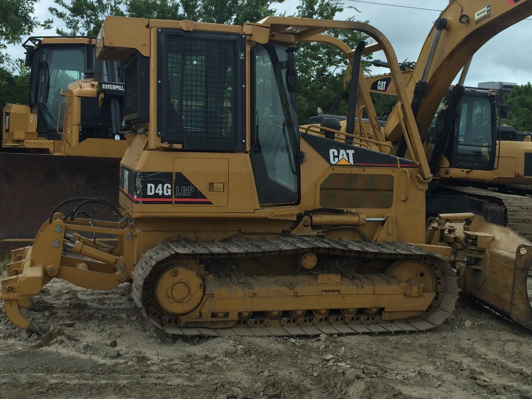

   / Cat D4G LGP, good choice?
Here is a picture.

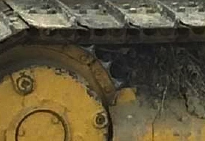

   / Cat D4G LGP, good choice? #6
I may be talkin' out of school here...But, I'd check out the under carriage real good. The sprocket in the picture looks to be pretty sharp. Rails & pins probably won't look much better. This is something that would probably have to be replaced right a way.
There's not much worse than having to wrestle the tracks back on a machine twice a day, especially one that you've just paid $55K for.
Good luck, used equipment is a gamble at best. You win some you loose some. Here's to hoping that you win, and if you loose, not too bad. :drink:

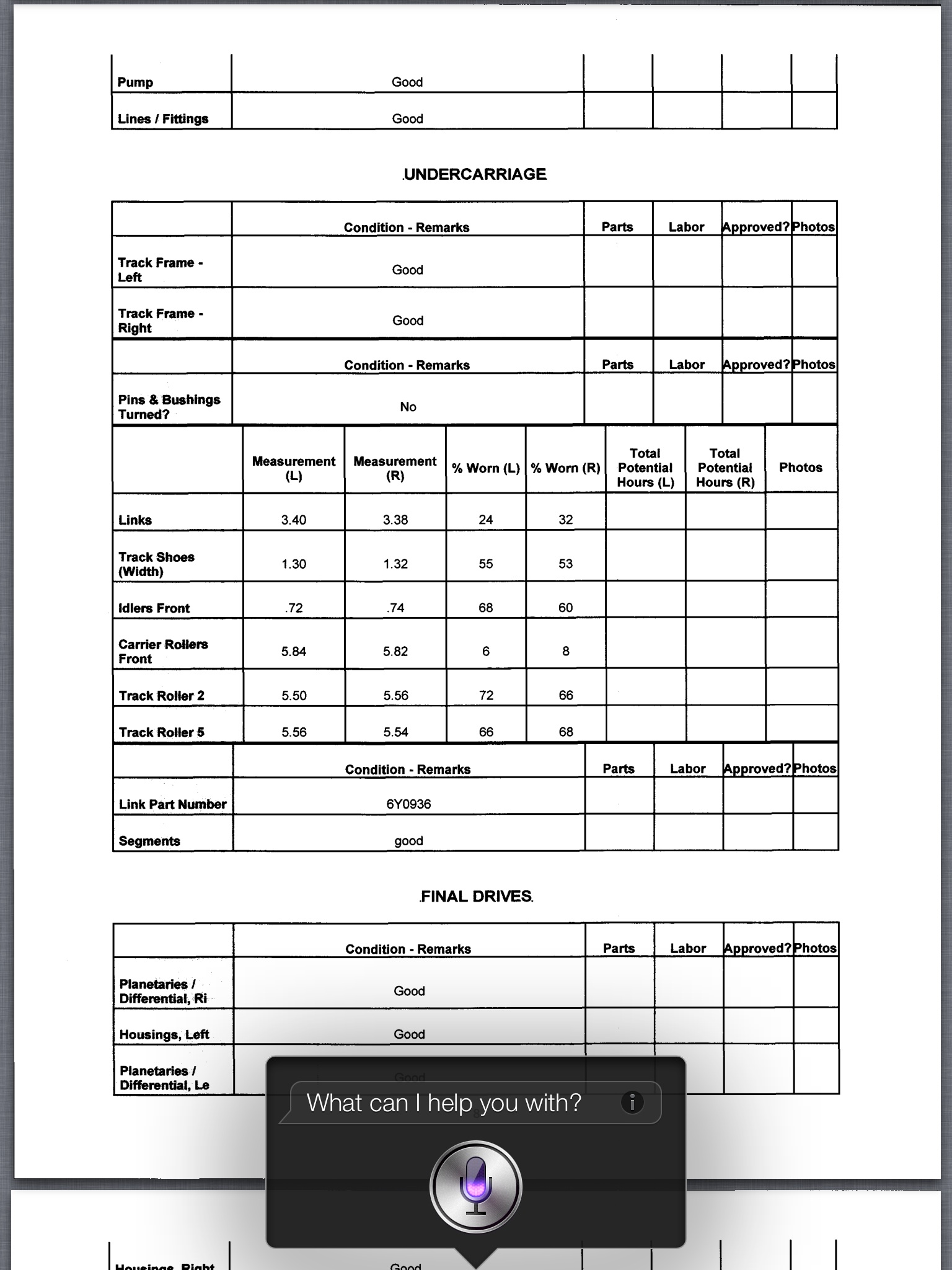

Here is the report.
35% left of undercarriage more or less
I agree the sprocket looks worn. Thank for your input.
A full track job is not cheep. I really want a machine with 2000hrs, but this one popped up in my area set up like I want it.
At 2000 hrs there is a whole lot less worn out. I figured I could run it at least 1500hrs as is and do a full aftermarket track job.
