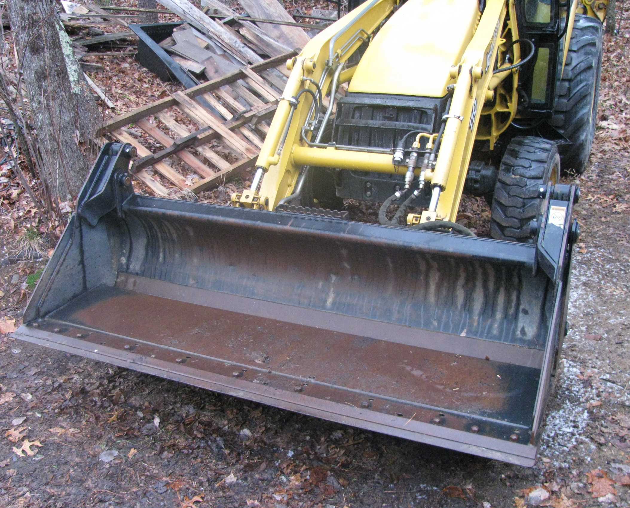

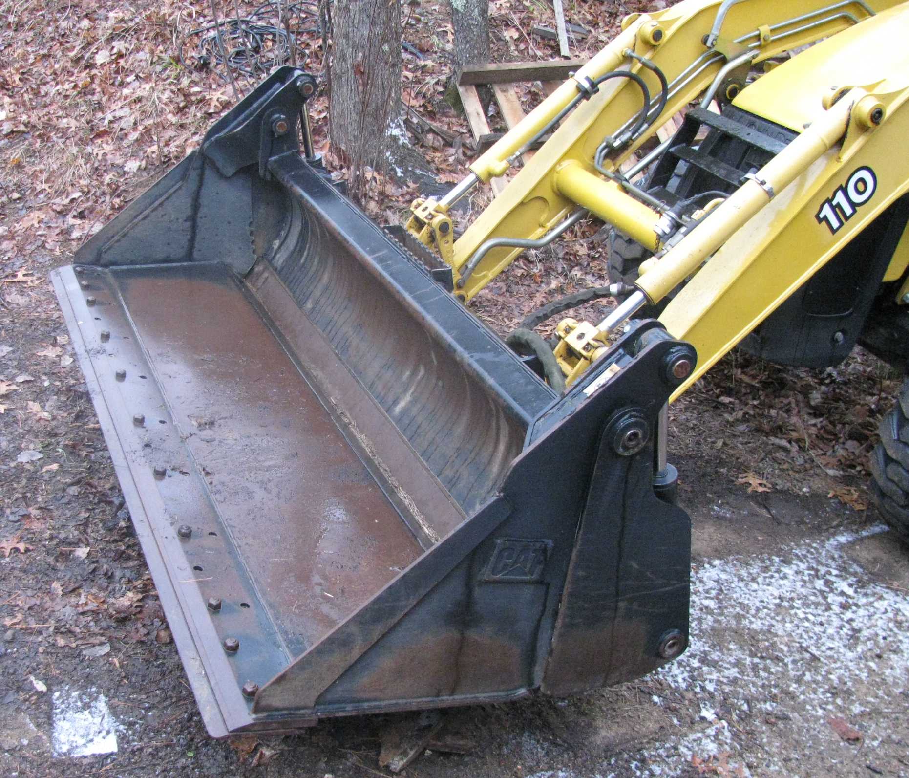

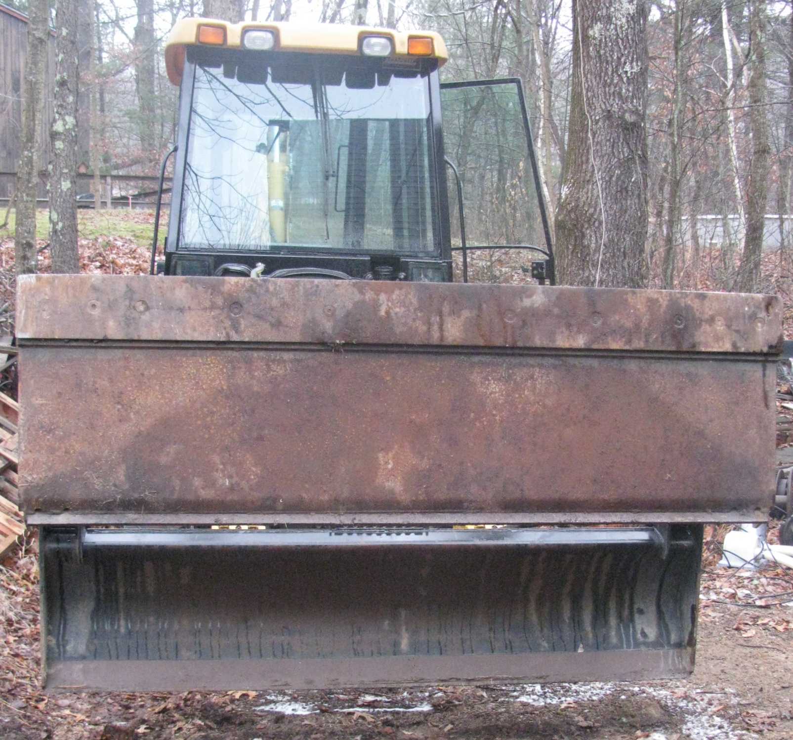

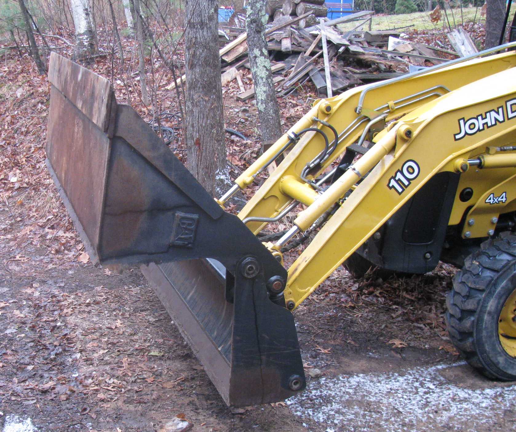

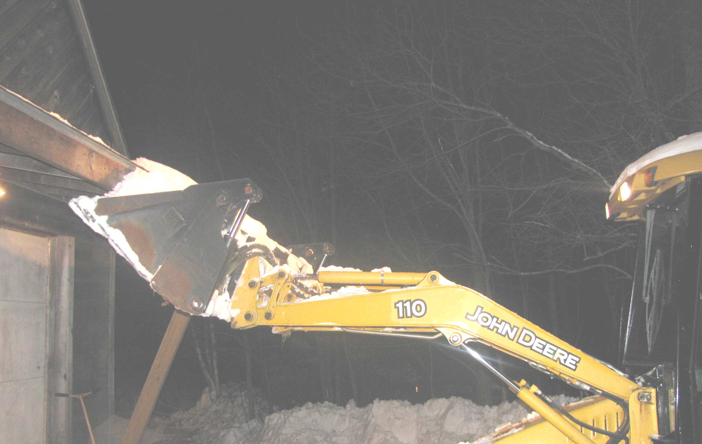

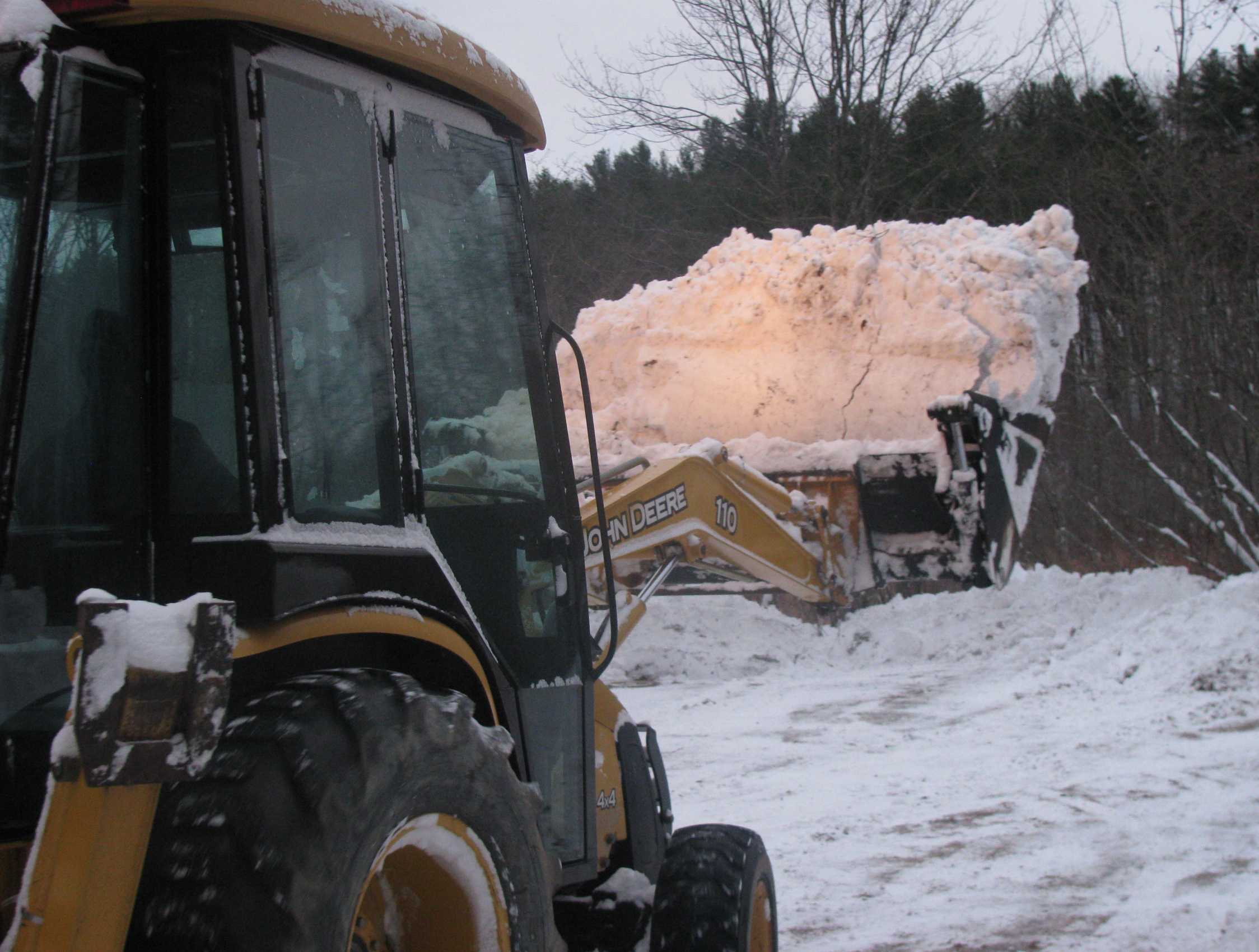

catbucket2.jpgcatbucket3.jpgcatbucket4.jpgcatbucket5.jpg110tlbroofrake.jpg110tlbsnow4.jpgImages of bucket mounted, roof raking snow into bucket and snow bank relocation with bucket.

Greetings, and nice bucket. May I ask what the 3rd connector is for that is beside the front pair of hydraulic couplers?
Of course you can!
It is an electrical connector. The original owner ran a Vee plow. The Vee plow was run in A or B constant flow plumbed off the remotes with an additional open center valve with separate electric control at the joystick. That's the electrical connection for the Vee plow, which I do not have.

Looks good on there! Another thing I did to my bucket was I installed a 5" piece of steel on the top of the bucket between the mounts for the 4n1 cylinders to get a little more capacity out of it. It would also help to keep material from falling back onto the machine.
I've seen that done before, makes sense. I've seen it done with expanded metal or other perforated plate so as to add capacity but maintain a sight hole.

Most guys use expanded metal on the back of the bucket to keep an eye on the cutting edge when it is being run on a skid steer. Since the 110 has a level indicator you could probably add a taller spill plate and not have any worries about seeing the edge. I like your idea with the wood splitter as well, being able to dump the bucket while leaving the splitter attached would be a real time saver.
