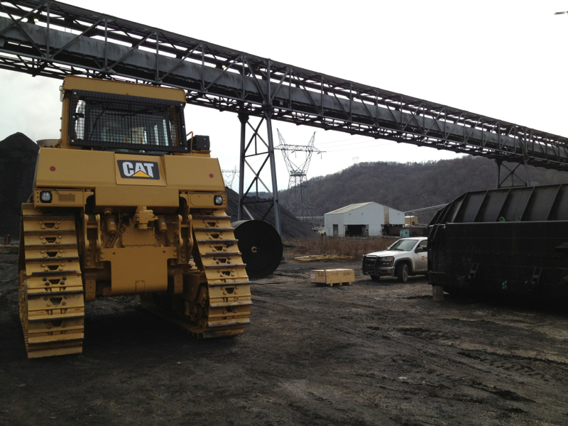

/ Cat 299d #32
Power plant in west Virginia they just bought 3 new d10t s 1.4 million dollars each
