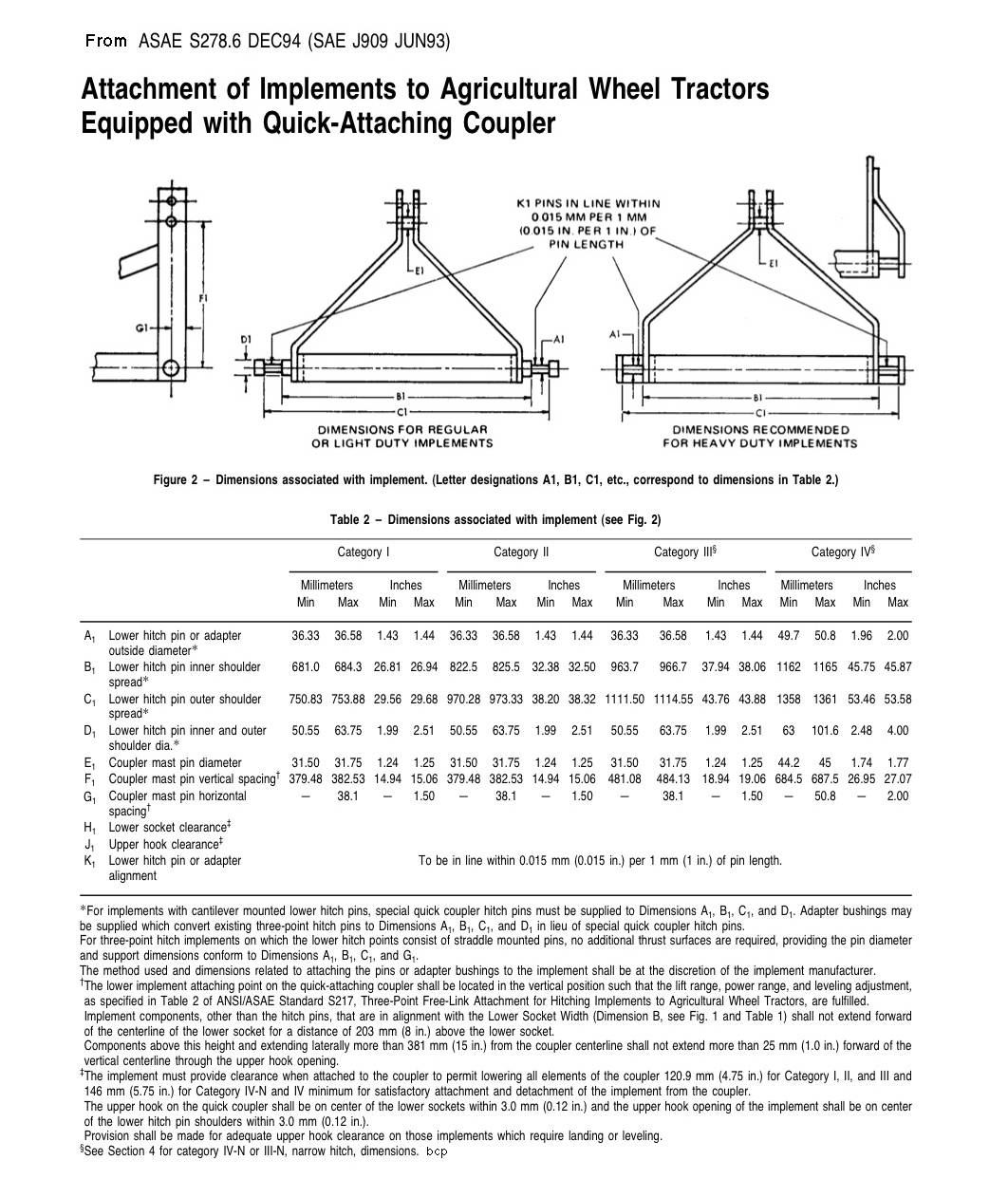

What are my options for a Cat 2 quick hitch?
I have extendable lower arms to make hooking up easier and I don't change implements often but every time I do struggle with changing them...I question my decision not having one.
Can you run Cat 1 implements with the Cat 2 QH if you use the sleeves?
Or do I need special pins for all of the implements to use a QH?

   / Cat 2 Quick Hitch? #4
See the attached about dimensions (standards)of quick hitches....

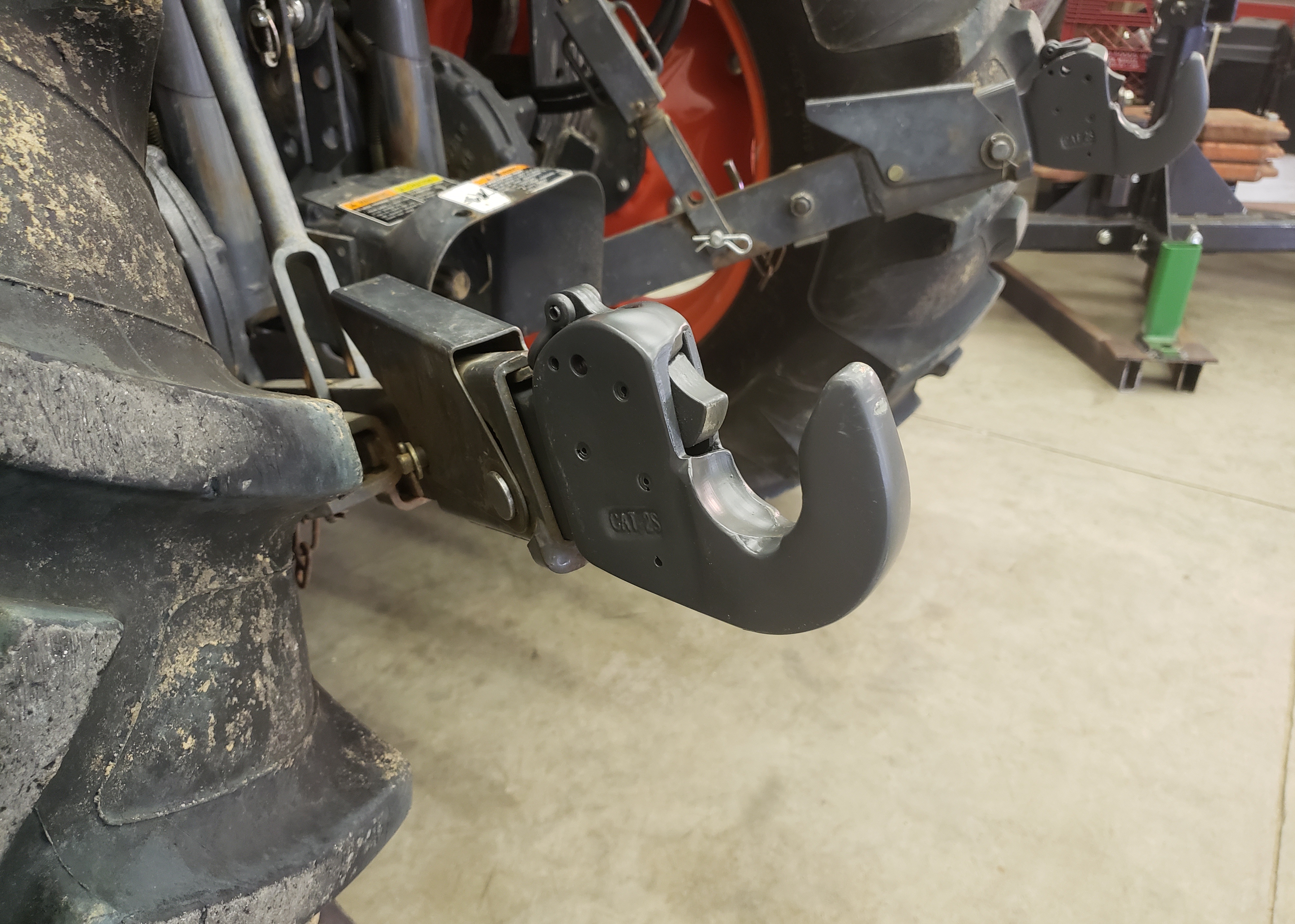

   / Cat 2 Quick Hitch? #6
I just converted my Kubota L5740 to the Euro style hooks on the bottom links and love them! A quick hitch wouldn't work with many of my implements. The Euro hooks are great!! Wish I had installed years ago.
