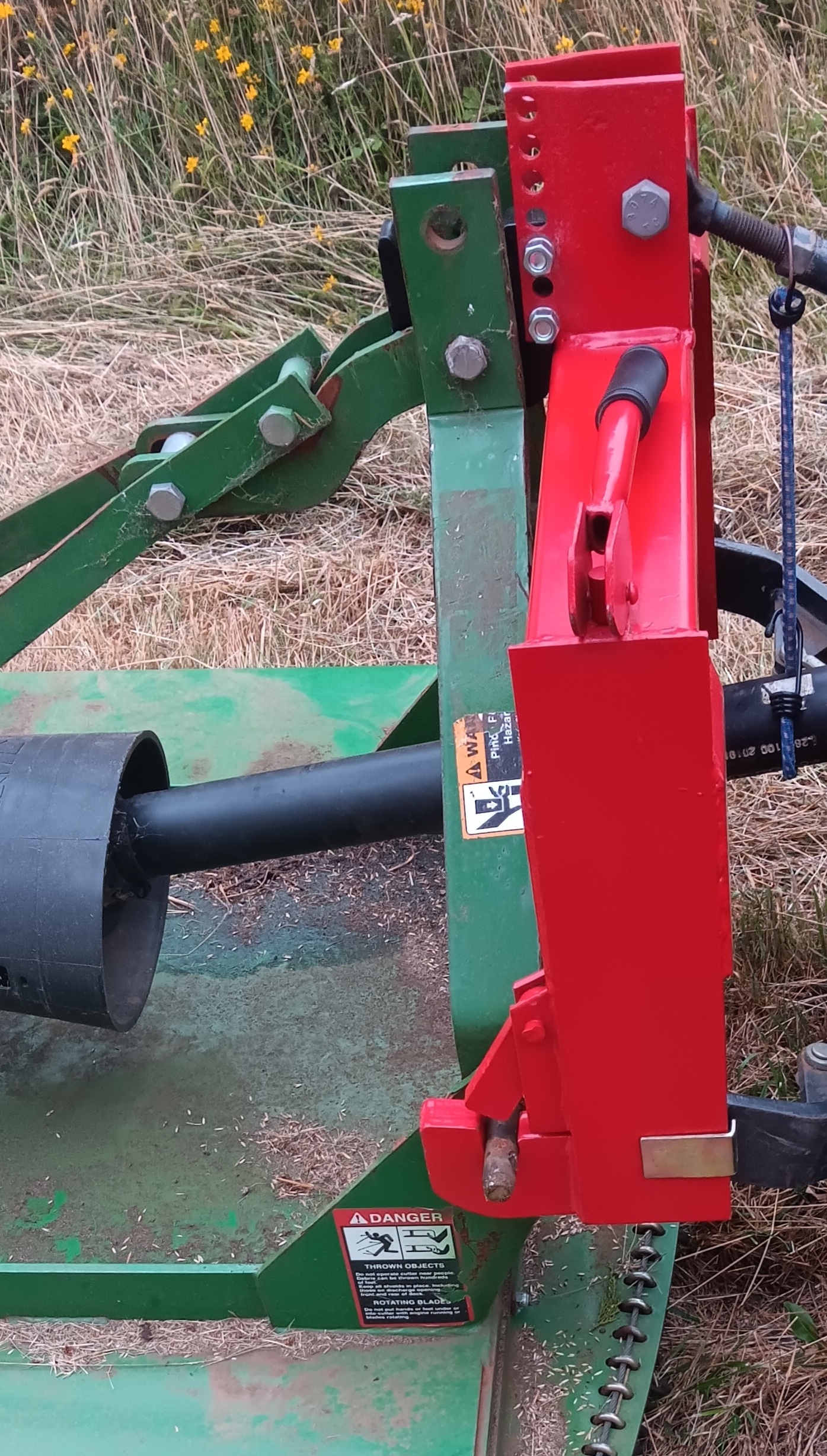

I have a similar quick hitch but I had to modify the top link attach point on most of my implements to make it work.

I installed this "cat 1 E" (no bushings) QH today on my Massive Ferguson GC2300 SCUT. I only have the Frontier 2048 and a box blade, both with the small pins. $200 at Trac Sup. On the box blade I have to clearance the pin nuts a little, and add a larger spacer on top, or make a thinner hook. Apparently not QH compatible, yet. https://www.tractorsupply.com/tsc/product/tooltuff-direct-cat-1-e-quick-hitch-25-040
