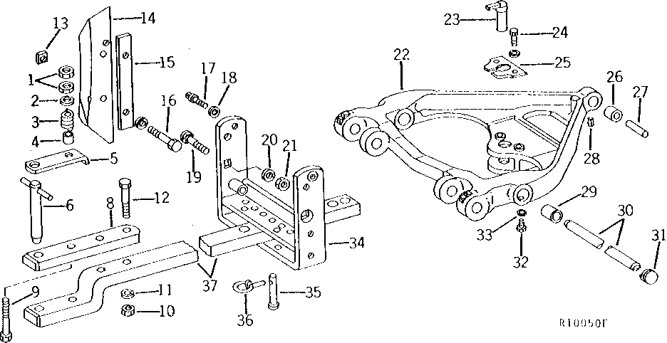

Have you switched sway blocks(parts key #14) to their narrow(Cat l) position? If that doesn't remedy the problem then just leave sway blocks off.

TX Jim,
Thanks. I didn't know about the sway blocks. I removed them and it now works great!

The sway blocks should fit in their narrow position for Cat l implements.
