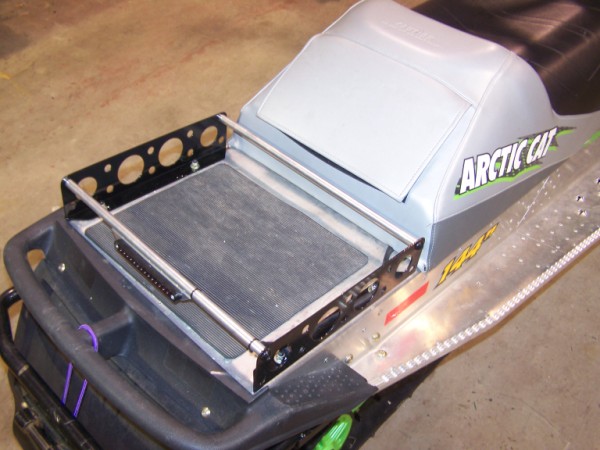

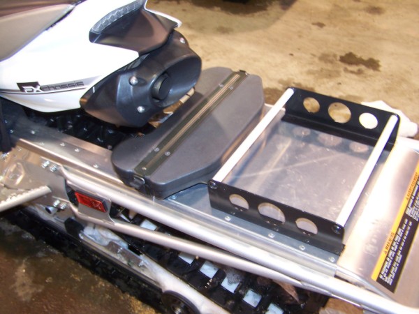

^^^Yep. Nice feeling doing the work yourself vs. paying someone else for something you are capable of doing.
I have been using Eastwood products for 6 yrs coating my custom gas/cargo racks for snowmobiles for 6yrs, and have had fantastic results. I have done some auto parts and misc stuff in between and have been VERY satisfied with the results of powder vs paint.
Here's a few shots of the racks if your interested.
