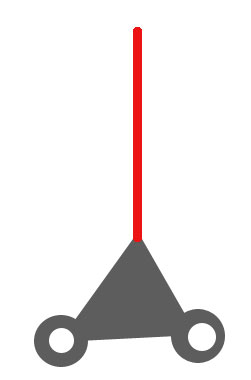

If the grade is relatively level I have another idea for your situation. Instead of using a caster consider building a triangular frame with a wheel at each end. So instead of having one wheel supporting the weight of the gates you'd have two. The hinge post will keep the gates up. And the two wheeled end on the big gate will enable the smaller gate to swing easily.
The idea is to have the end of the bigger gate strong enough to handle the weight of the shorter gate during it's whole swing arc.
If the ground isn't level you might have to replace the top hinge on the big gate with Heim (rod end bearing). Then the lower hinge needs to have either a smaller pin or a larger hole. This will allow the gate to move up and down on the end while keeping it in line.

I think Harv's idea is right on the money. I also like the addition of of the guy wire, however if you were resting the main gate on the double castor wheels, the ground should bear the weight of the wheels just fine, unless it very muddy. Perhaps instead of castor wheels which might dig into soft ground, you used some very small tires or wheels??? Something that would spread the load of the primary gate over the soft ground. Picture a trianglular plate with the apex pointing up. Then put a wheel at each of the bottom corners. Looking at the gate "end on" (the red post in the photo), the bottom of the gate would sit on the apex of the triangle. Not trying to steal your thunder here Harv, but I had an image program open on the desktop. Is this what you are describing somewhat?

   / Castor wheel for holding up gate? #8
Ooops...here's the picture.
Ken

   / Castor wheel for holding up gate? #9
You got it Ken, darn, either I'm getting better at 'splainin' or ya'll gettin'n better at cipherin'. And your picture is definately worth more than my thousand words. /forums/images/graemlins/blush.gif
I'd like ya'll to think about something.
If you run that guy wire from the top of the post aren't you putting more leverage against the footing of the post?
But if you put that guy wire from the lower corner of the latch side of the gate back up to the upper frame near the high hinge aren't you accomplishing the same thing without the additional pressure on the footing?
Just a thot, harvey
