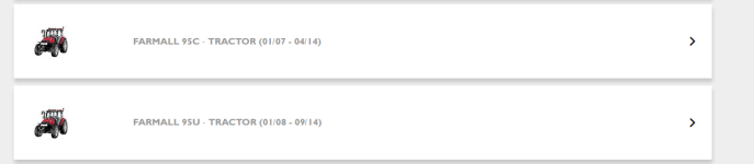

Could someone please tell me the difference between a Case 95X and a Case 95. We have one of each and some parts are interchangeable and some are not. Decals are the same on both tractors with the exception of the X after 95 on one of them. No local Case dealer can give me any information when I give them the serial # on the 95.

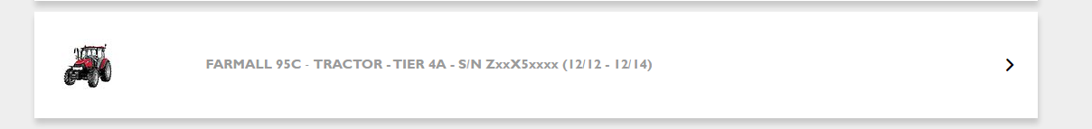

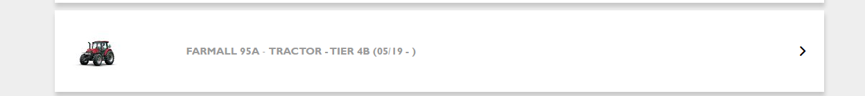

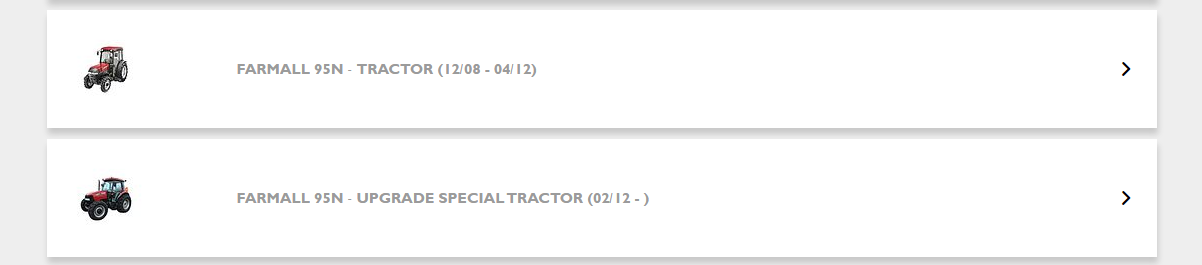

What does the SN plate say for country of origin? I’m not sure if one is built for Case by Turk Tractor in Ankara, Turkey, and the other may have a different country of origin. The info I found says the 95 was built at the Turkish plant.
