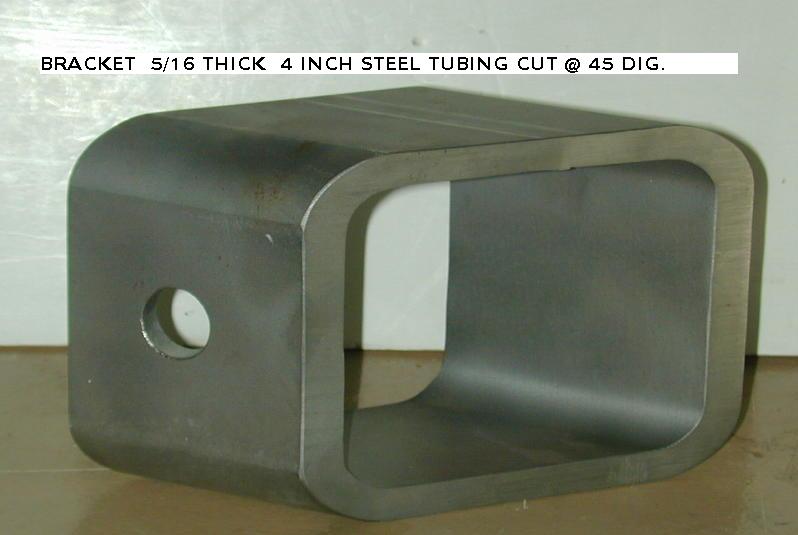

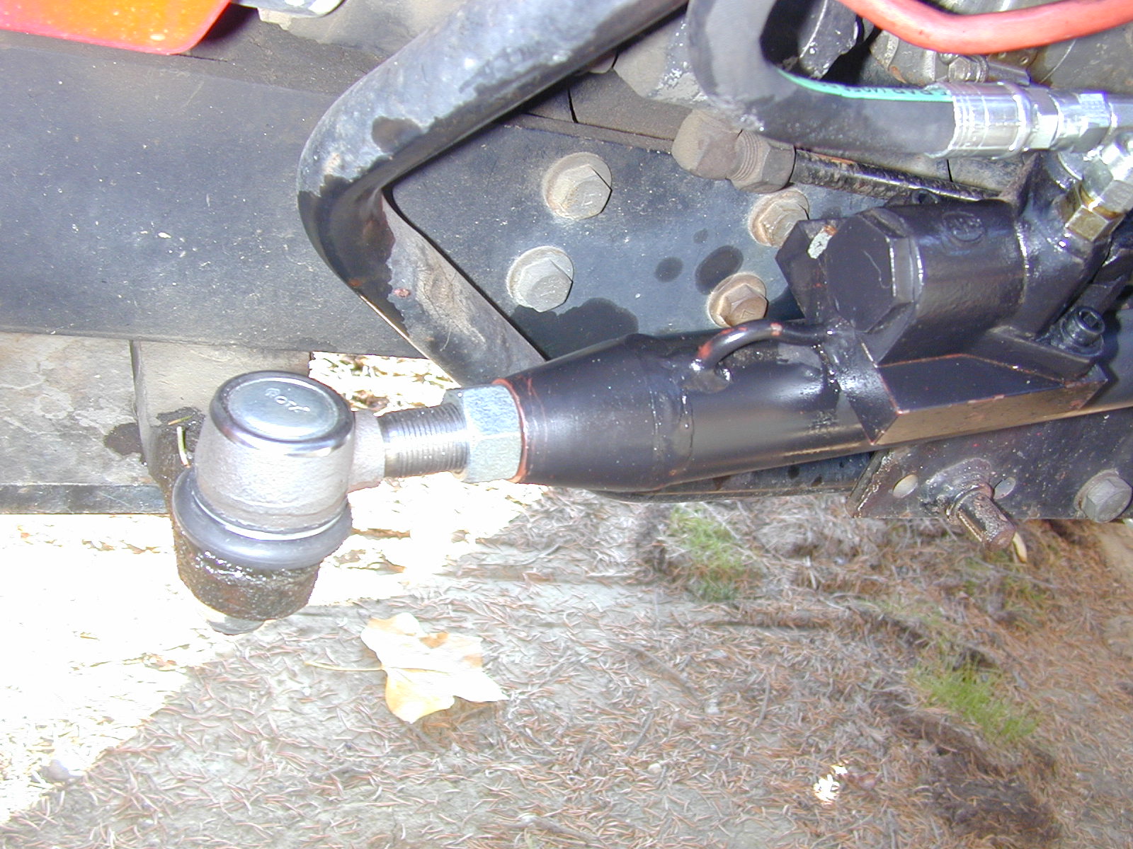

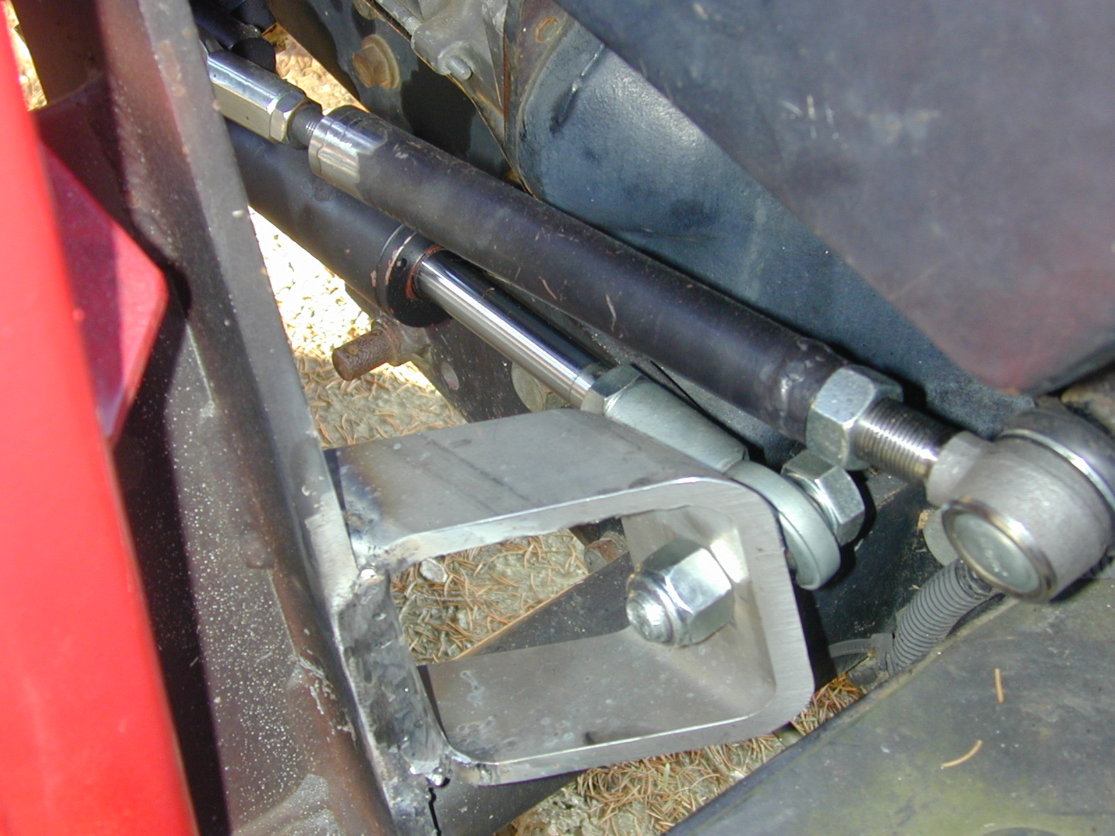

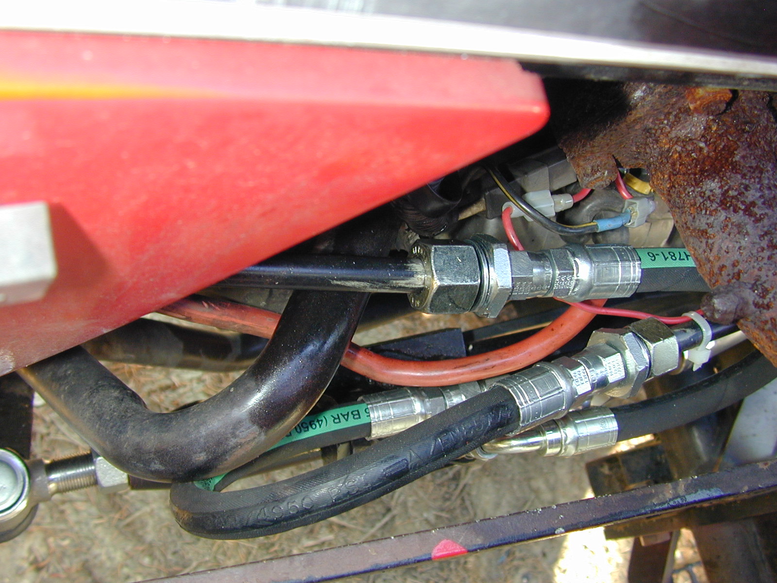

/ CASE IH 275 Power Steering Conversion #6
Hi
I finally got the cylinder installed.
Mounting bracket was a bit of a challenge because of the bucket.
But it works great.
Will try to attach some photos.
Steve
Steve,
Thanks for the information. It looks like it is really not that complicated. Thanks so much for the pictures. A picture is worth a thousand words. I'm going to have to check into putting one on my tractor, since you like the way yours works.
