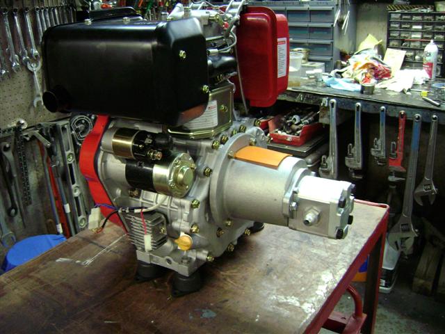

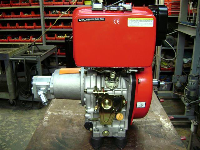

MORE PHOTOS OF THE CHINA DIESEL

The pump is a Vescor AP20011D880, SAE"A" mount 4000 RPM-3000 PSI
The adapter is a Vescor #6024, SAE "A" 2 bolt 5.00" FF
This is a METRIC adapter "PEM-G"
I took off the pull starter assy and machined a plate and welded a shaft
that accepts the case fan for cooling the oil!! It mounts up to the
pull start cog assy holes in the flywheel.

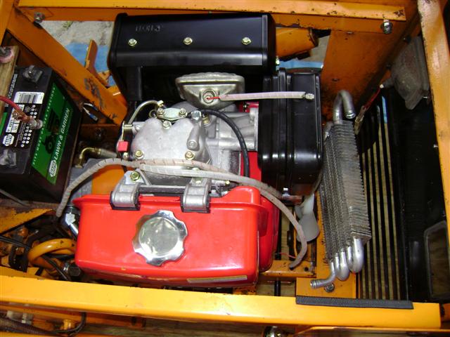

Here are a few pics of the engine in the tractor.
