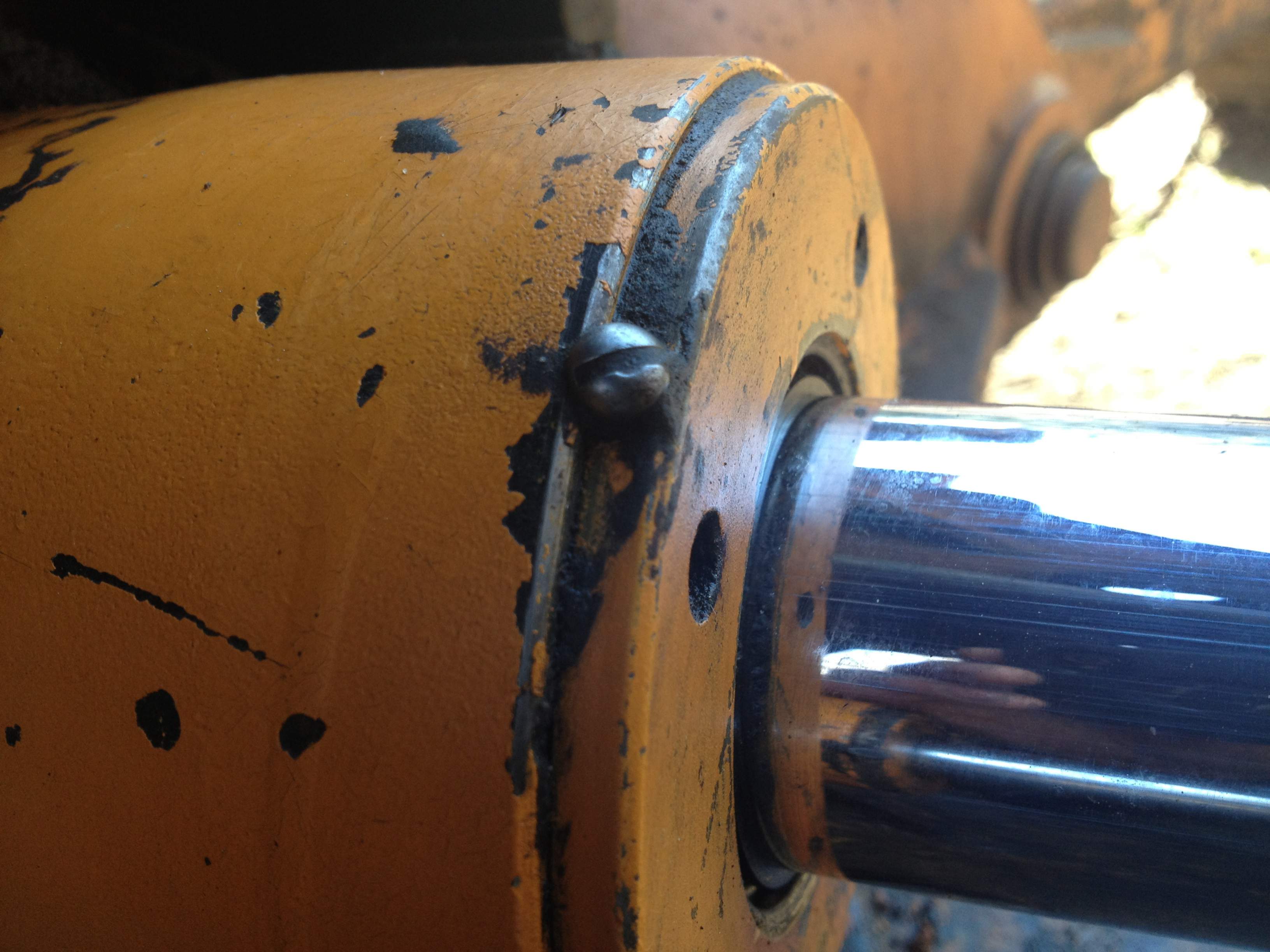

On my case 580D some of the cylinders have a small screw in the end cap of them, what does this screw do? I thought it may be there to keep the end cap from loosening but not all the cylinders have it.
   / case 580d cylinder question #2
Don't remember if all the cyl's on my 580B have them, but that's what they're for - in my experience, the little hole will NOT line up after you re-seal your cylinders. Not sure why.
Are yours leaking, or just curiosity? Steve

well, both they are leaking a bit but I'm rebuilding the stabilizer cyl now and it doesn't have a screw in it so I wanted to know if there was a different way to rebuild or bleed the other cylinders.
   / case 580d cylinder question #4
Only thing I can think of someone used screw to lock gland in place bleeding is done by opening and closing control valve from the cylinder to the tank from the return line. To get the cylinder cap off use a spaner wrench. I use hot water to aid gland seal installation.If the rod has crome damage the new seal wont last long.
   / case 580d cylinder question #5
My 680h has both screw on some cylinders and some of them just have a plastic thread lock on the inside . The plastic fits in a hole in the gland and squishes into the threads as it is being tightened. Hope I explained it to your understanding. But both are there to lock the gland in place
   / case 580d cylinder question #7
.................. But both are there to lock the gland in place
After repack, you can redrill if they don't line up again or just reuse the old holes
