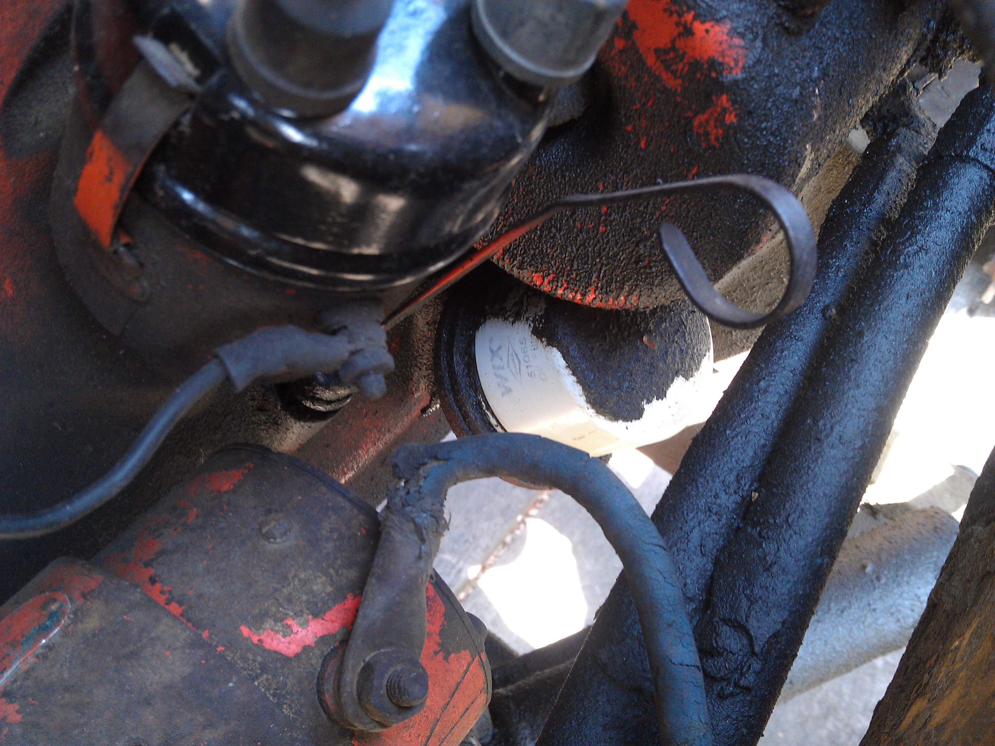

Hi everyone!
I traded a 74 Dodge Dart straight up for a 19?? Case 580 CK with a front end loader. The bucket is like brand new.
View attachment 354667View attachment 354668View attachment 354669View attachment 354670View attachment 354671

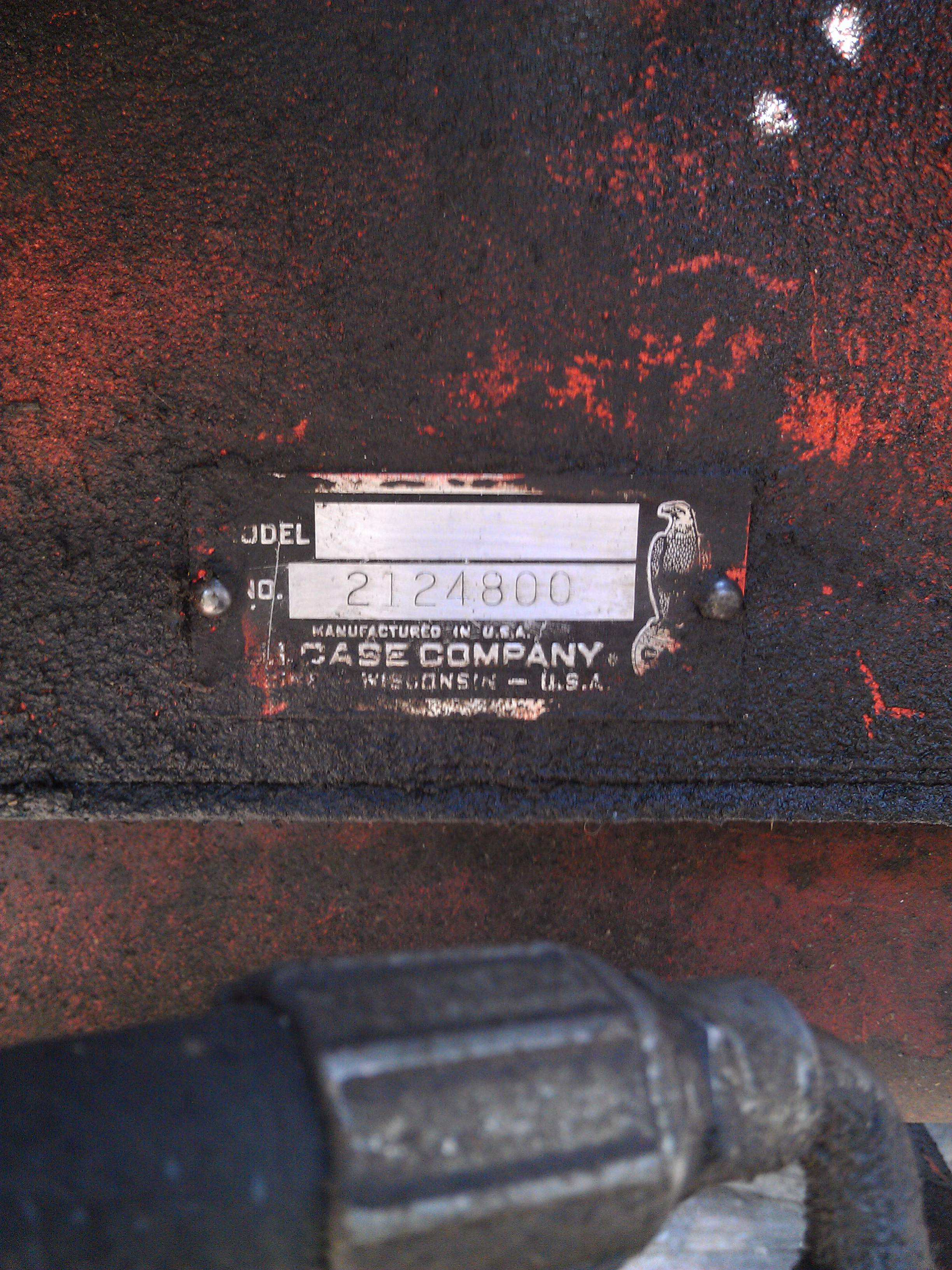

It has a possibly Frankensteined 4 cylinder gas engine. I am trying to figure out if the engine is original to the tractor or not. If it isn't, what it is, so I can order parts for it. The engine may be out of a 600 series combine for 660 I am not sure. The engine seems to fit in there okay but according to the hood it's probably not the right one. There is a hole that is half-assed torched into the hood to be able to get to the oil fill. Now you know as much as I do about the thing.

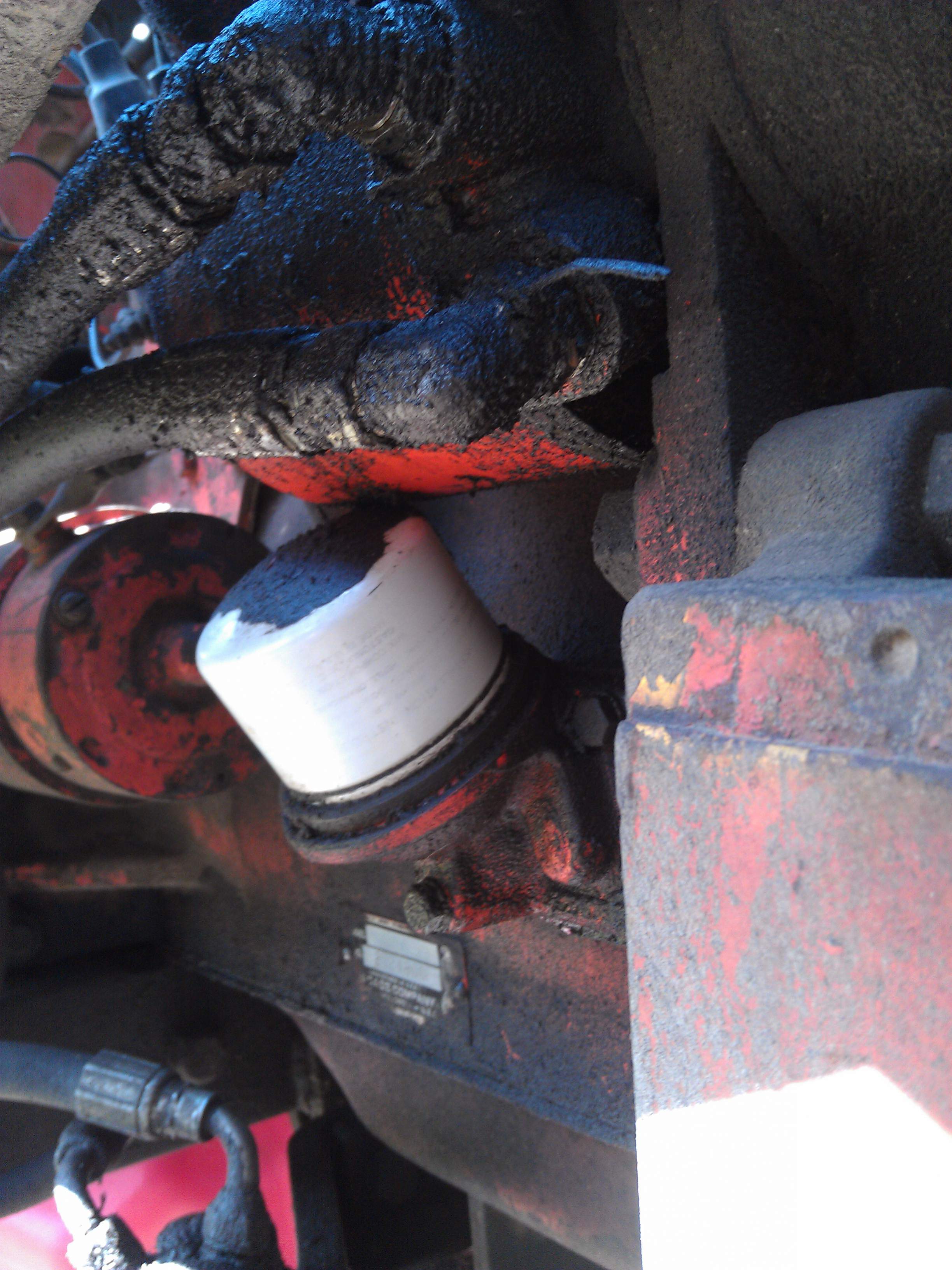

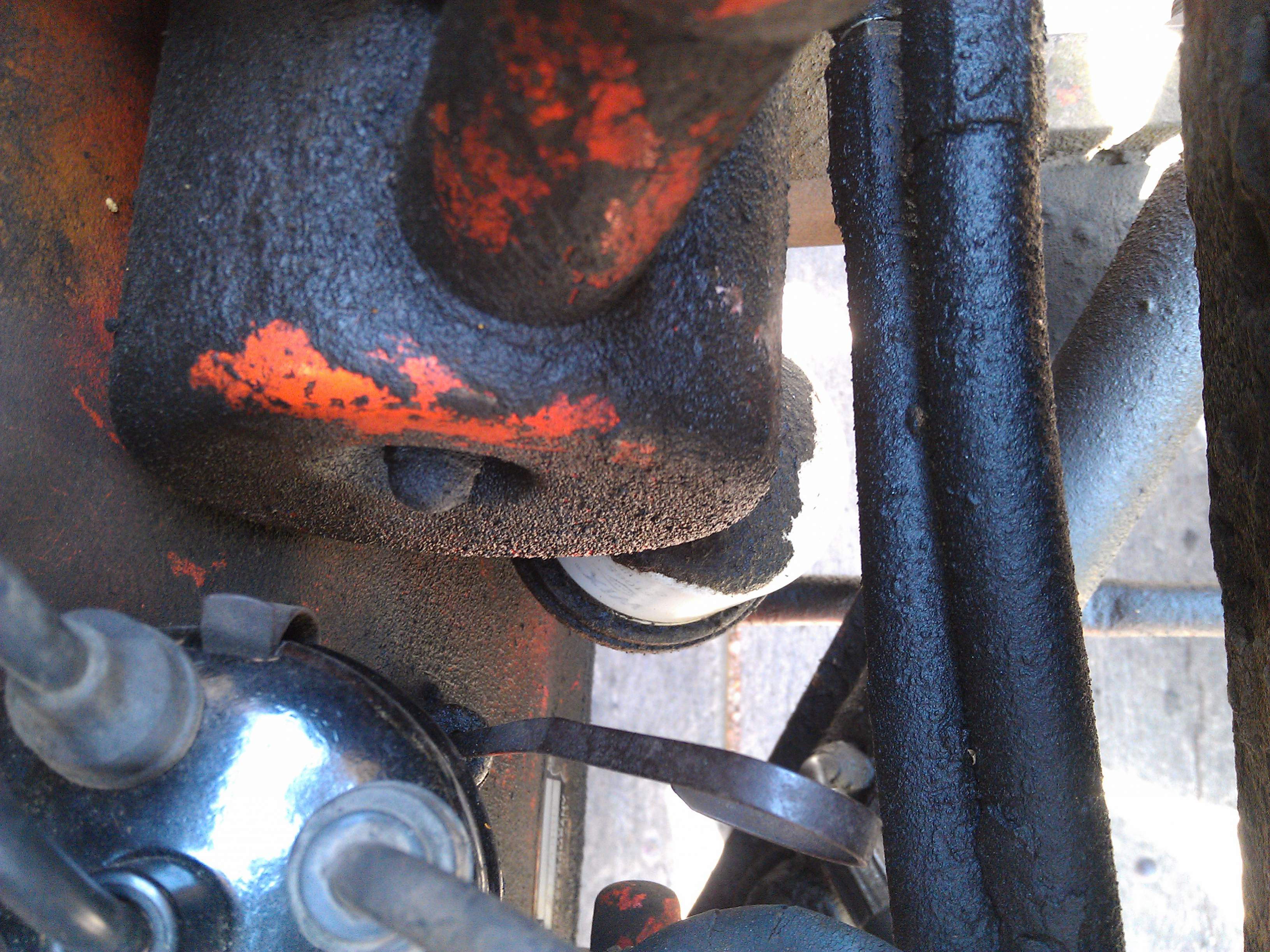

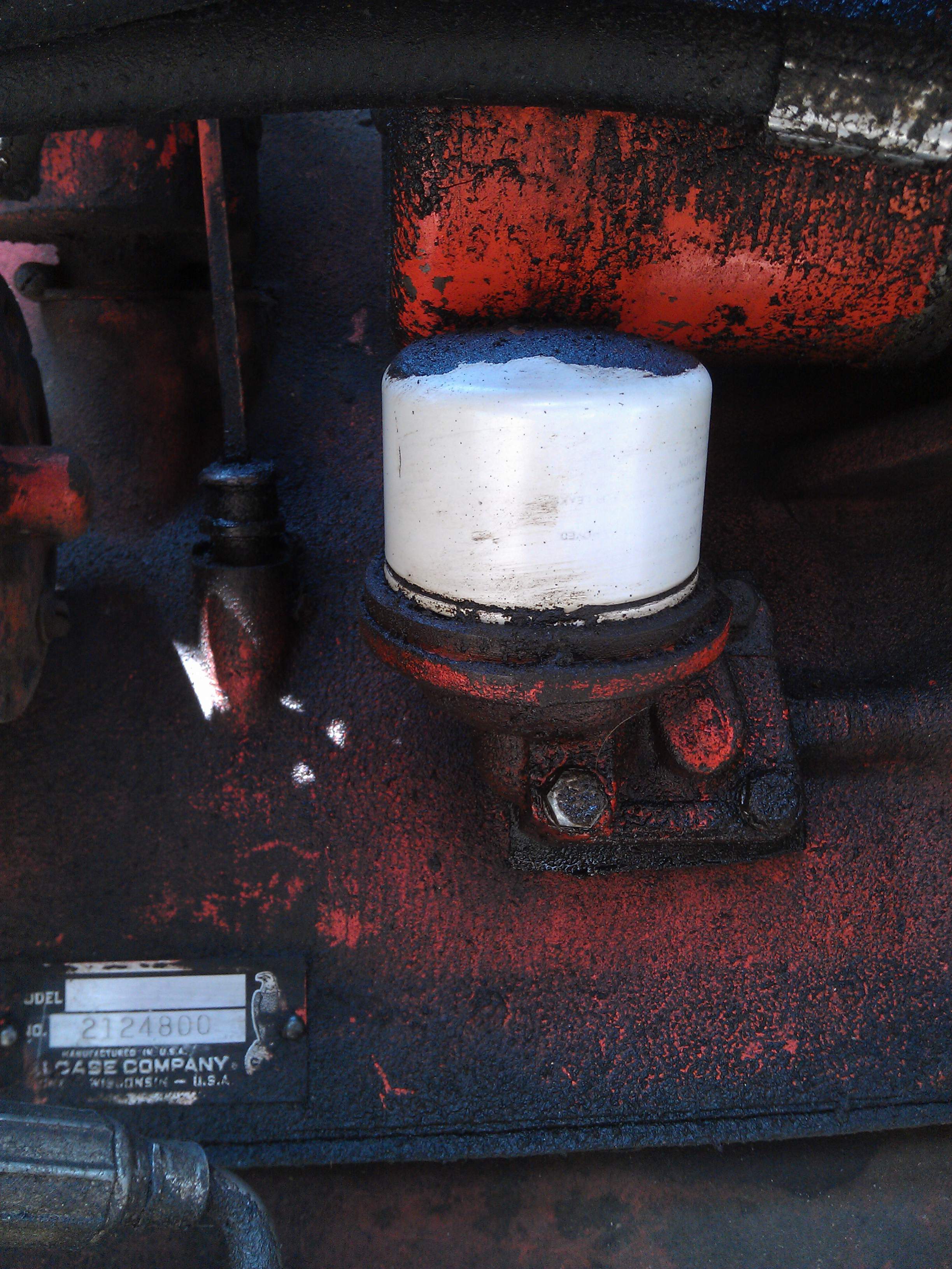

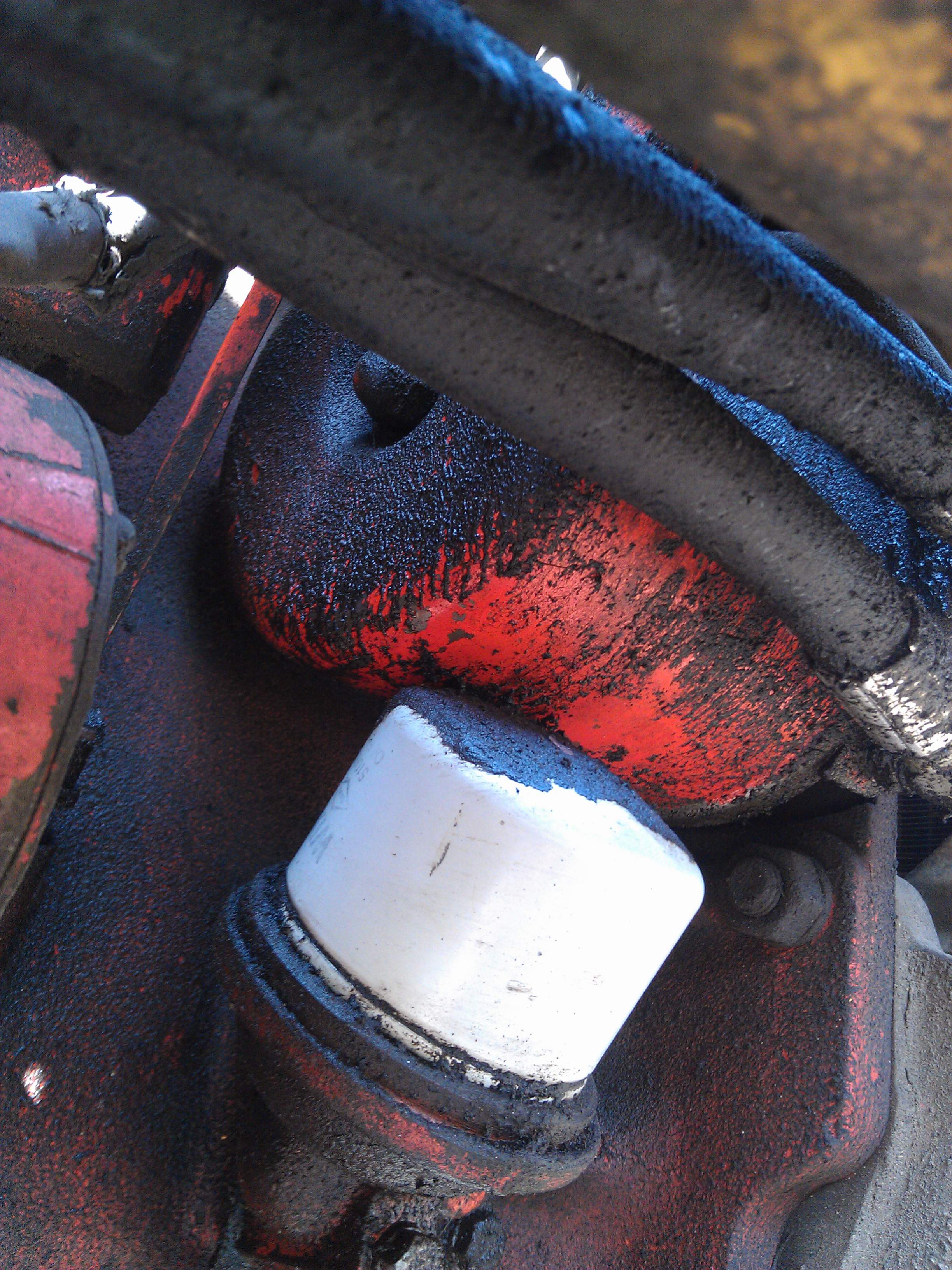

It was in rough shape and there was water in the oil from exhaust not being covered. I drained and flushed the system multiple times and now seems ok. The oil filter housing is set up horrible! The oil filter will NOT screw off without taking the power steering reservoir off.
The original oil filter for this tractor does not fit the current engine. (4 cyl gas) The filter is very short and small. Almost like on a garden tractor. The problem I have run into is the Case dealer said this does not seem like the original engine. There is only a serial number stamped on the tag on the block, not a model number.
I have a few issues with the tractor.
#1.
The tractor does not seem to have much power. I have to idle it pretty high to get enough power to use the loader. It lacks power and acts like it wants to die when putting it in gear and letting the clutch out. If I get it rolling and try to lift the bucket, god help me. It bogs down BAD and nearly dies. I have to stop, raise/tilt the loader and then continue on. Compression is good and equal. I don't know which engine I have to check the timing procedure or specs. Engine
#2.
The three point does not work. There is a 55 gallon drum hanging off the back for weight. I don't think it's too heavy to lift, but I may be wrong. If that's the case, I'll deal with it, because this thing has nearly NO traction even with the barrel.
#3.
The oil level rises slowly. The oil smells a bit like fuel and seems thinner than when it's fresh. I just don't know how fuel would get into the crankcase. I rebuilt the carburetor and it ran better, but still not trustworthy to take down to the woods and drag trees and what not.
#4.
The throttle linkage on the dash is rusted tight and will not work. I had to disconnect the foot lever linkage due to this. I installed a throttle cable from the lawn and garden section. It works, but not as it should. I have to take the dash off and free it up and re-install the other linkages and I'll be back in business.
Any help identifying the engine and running concern would be appreciated.
Thanks again!

Here is a link that ought to help you find what you need: Official Case Construction Equipment Online Parts Store and Parts Look Up. Parts for Case Equipment and Construction Equipment. Parts Store for Case Wheel Loaders, Case Excavators, Case Skid Steers, Case Original Parts. It is a link to Case Construction's parts manuals online. I went ahead and got you as far as the main parts manual. All you need to do is click on what you're looking for. Note, there are 6 pages.
On the #1 page, #002 item in the list shows where to look for serial numbers. A lot of the older models seem to be missing the cowl piece, the serial number tag was pop riveted to.
You'll need to go to page #2 and #036 in the list,to find info on the gasoline engine. If you look at the picture of the block, you'll see the location of the block casting number. That is what you need to identify the engine you have. There should be a flat boss, with the casting number engraved there. If not there, look for a flat boss elsewhere, but I believe most were located there.
That number if original should be A37209. The serial number will be date of mfg. If that number does not match the above number, then get the block casting number, type in into a search engine, and see what you get. You could probabaly go to Case Ag. site, and do a search for the 600 series, as it should show block casting number for the Ag. tractors also.
As for #1 in your list, it sounds like the governor to me. Go to 050 to see an exploded view of the governor, that is on the original engine. May not apply to what you have though. Once you find out what engine you have, you may need to go to Case/IH Ag. to find that info.
#2 on your list... Go to page #5, and click on page 142. It will show you an exploded view of the hydraulic pump. It may be just low on fluid. If you're not that familiar with it yet, the hyd. pump for the 3 pt. is located behind the torque tube, and ahead of the transmission. If there is notable oil leakage showing around the clutch inspection plate at the lower front of the torque tube, more than likely, the shaft seal is leaking where the main drive shaft passes through. The tractor will need to be split at the engine & torque tube to replace it.
#3. Can't see enough of your engine to determine if if has a fuel pump attached to the block somewhere. If it does, I'd suspect the diaphragm was leaking on the pump, letting fuel into the crankcase.
#4. The throttle lever not working may be part of your power problem. ie: governor not working... If you look at the exploded view of the governor, you will see a couple of springs attached to the throttle rod, that in turn work with the gov. control rod. If that linkage is frozen, and not able to move, I'm guessing it will not allow the gov. to activate as it should.
As for the oil filter. How about one of those oil filter relocation kits..?? Hardest part would be finding a place easily accesable, but yet not get the lines/hoses in the loader arms. Second hardest would be cross referencing the filter, and see what all it fits, and see if there is an automotive application. I believe I remember that being a Wix filter, so doing a search at NAPA online, and using the parts interchange block up in the corner should get you some results you need. All I've checked, when checking the actual filter description, gives the thread and base size.
Purely all speculation on this end, but should help you get started on info you're looking for.
Once you determine what engine you have, and what it's out of, you can probably do a search, such as using Google for the model number of Case tractor it came from. Usually at the top of the results will be TractorData. When you open that link, it gives the serial numbers on down in the info.
Hope this helps..!!
