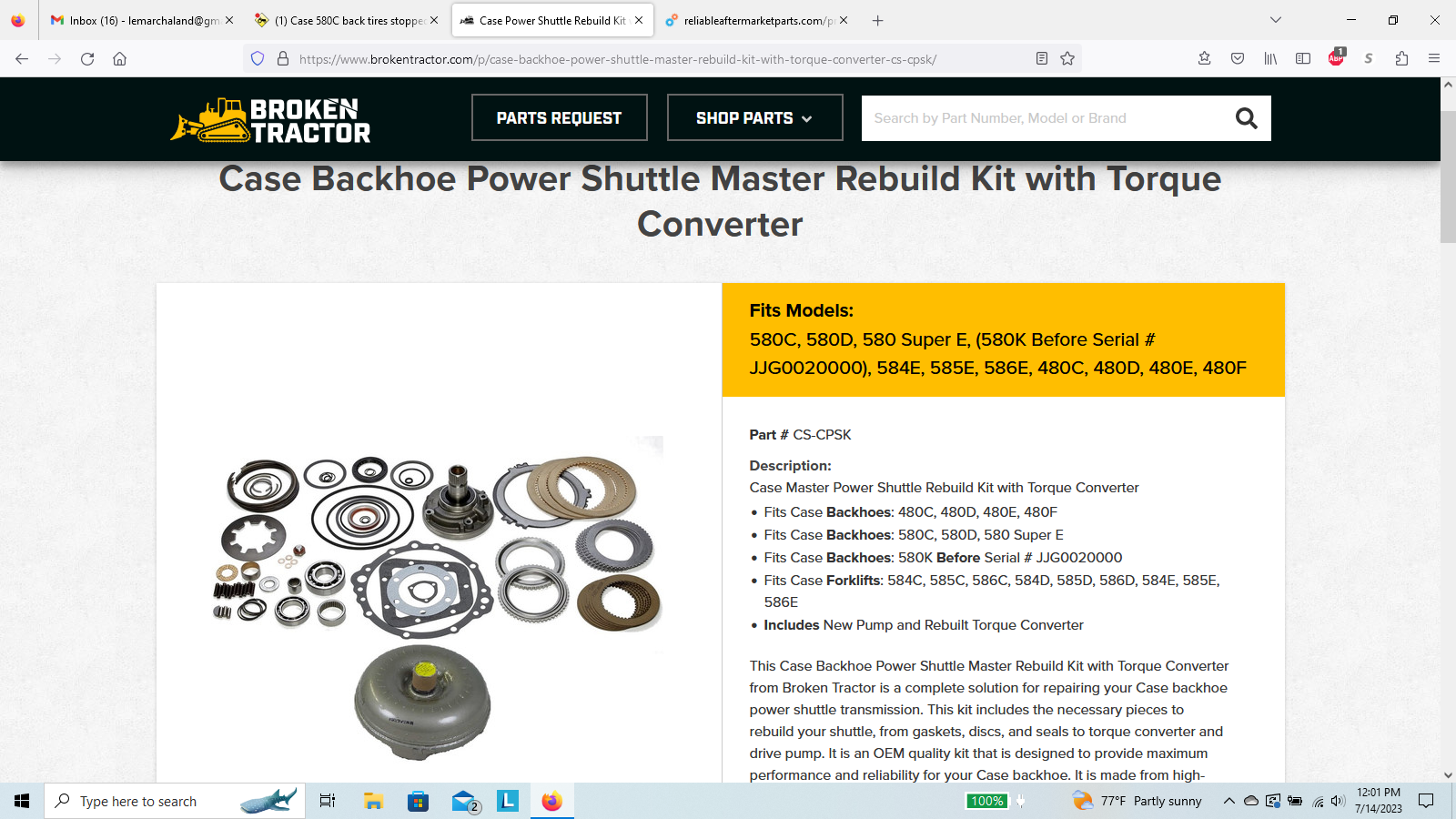

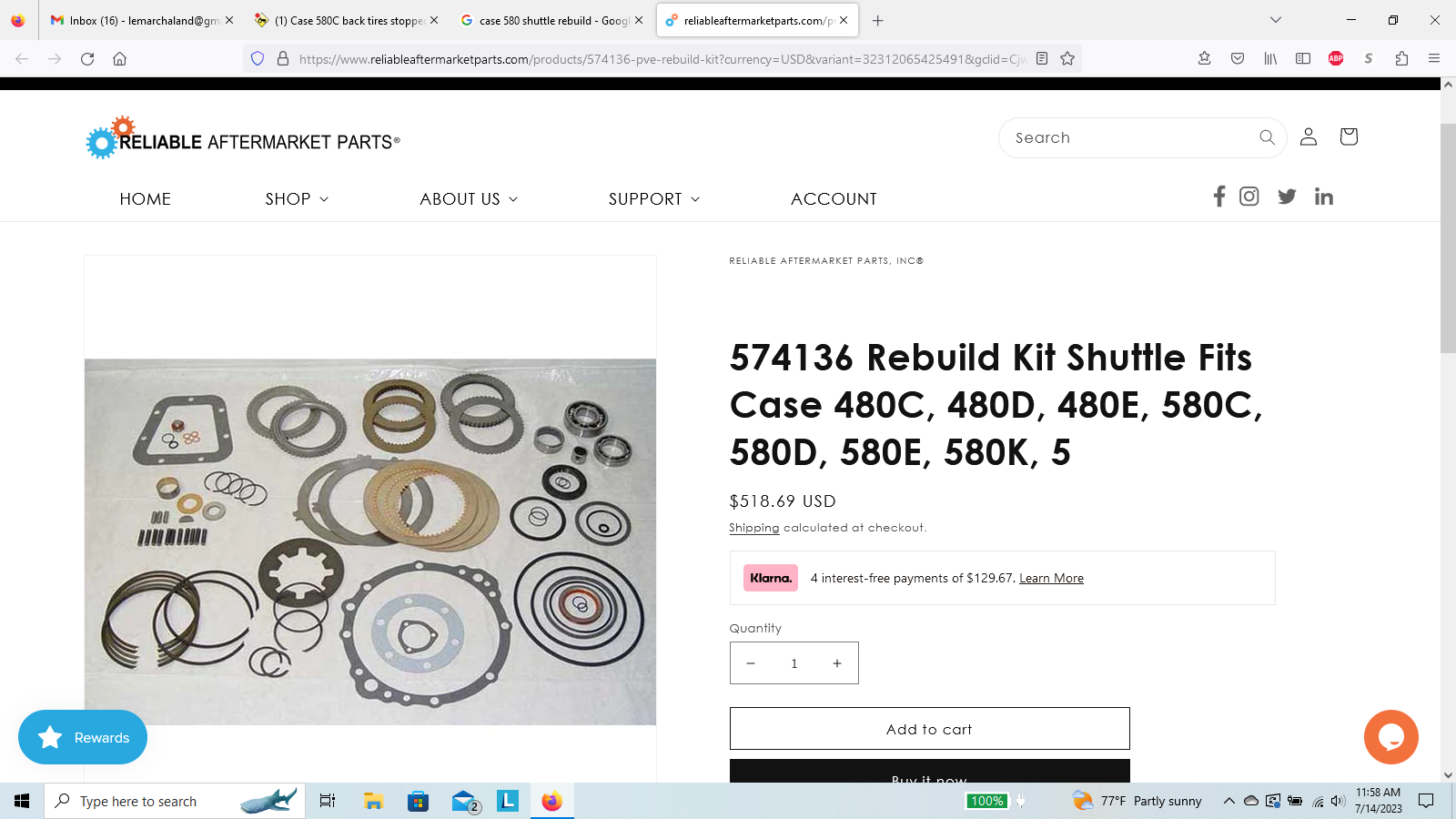

I believe most of those where a power shuttle or reverser, with a torque converter drive to a manual transmission.
From;574136 Rebuild Kit Shuttle Fits Case 480C, 480D, 480E, 580C, 580D, 580
Or complete with a torque converter; Case Backhoe Power Shuttle Master Rebuild Kit with Torque Converter
