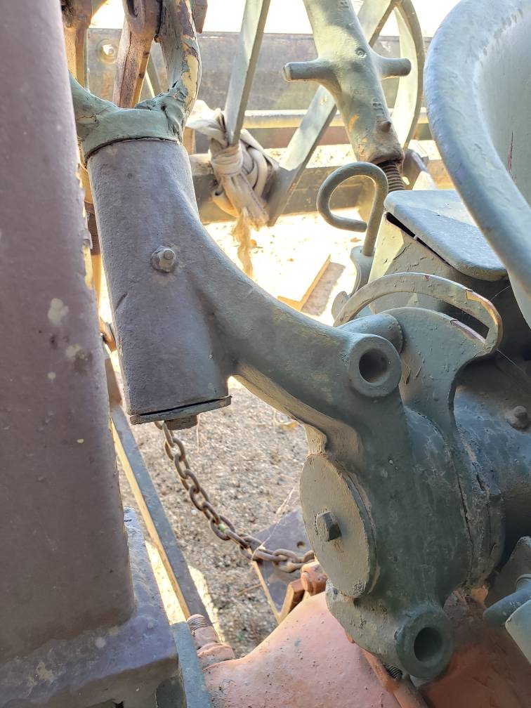

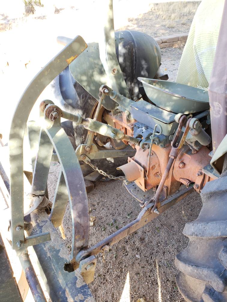

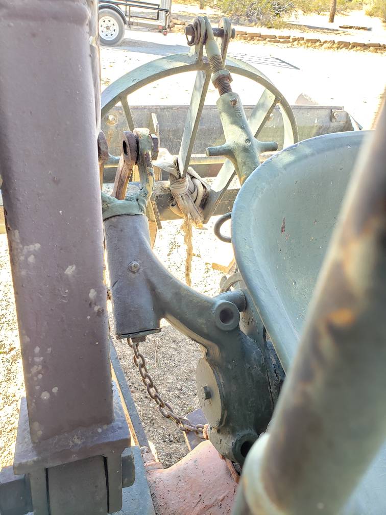

Greetings. My Case 530 rockshaft has lifting arms that I cannot identify anywhere. The arms are equipped with a grease fitting and the arms that attach to the lift links looks like they could rotate within the lifting arms. I am asking for help with any information on this style of 3 point hitch. Please see attached photos. Thanks. 20201117_132708.jpeg20201117_132751.jpeg20201117_132822.jpeg
/ Case 530 Rockshaft #2
Looks like #25 in this exploded viewhttps://www.mycnhistore.com/us/en/caseih/na/tractors/agricultural/under-100-hp/case-ag-utility-tractor-prior-to-sn-8262800/power-train/swinging-draft-arms-before-sn-8211729-eagle-hitch-tractor-prior-to-sn-8262800/cn/A6C3B762-8FBF-E111-9FCE-005056875BD6 is the piece you have pictured. Looks like a PO removed the adjustment part, the yoke in the exploded view attaches to. The adjuster probably failed, and they replaced it with what you have now.
I'd look that part over pretty close for a part number cast into it. Case was pretty good about doing that. Then search Google for the number you find.
Otherwise, if you plan to keep the tractor, look for a parts catalog for it. I'm assuming it's a agricultural/utility model, and not a Construction King model. I did a quick look on ebay, and found a reprint of the parts catalog for the Ag. model. I guess not a bad price for a new catalog, although some reprints I've gotten, the scannning/printing process could be better. Case Model 53? Series Tractor Parts Catalog Manual A4?3 | eBay
If you plan to keep the tractor, using the part number is the key to finding any parts for your 530. Most salvage dealers, and aftermarket part suppliers use the part numbers in their listings. As one part may fit different models, such as in this case,a 430 also.
I'm not sure how much this will help you, but here's a site that has several parts catalogs for the 530CK.Case 53?CK - Manuals Pretty much the same 530 Utility chassis, transmission, and engine's, whether gas or diesel. You'll have to look through them, as many models did have 3 pt. hitch, and were a popular item in that era, to have a loader, and using a Gannon box blade to finish grade in housing developments. This was a transition era, where they used an Ag. utility tractor for industrial purposes, just modifying them with heavier front ends, manual reverser's, etc, before going strictly with industrial models, bringing out the 80, and 90 series.

Thank you DJ54 for all the information. This is my first tractor. The PO said it was "a 580 with some carb issue". I had doubts about it being a 580 and the price was good. Well, since owning it I've learned a lot. It is a 530 Utility which I'm happier with. I've always liked the compact tractors. It does have a FEL and Gannon drag.
Looking at a lot of pictures of 530's and casting numbers, in addition to a low engine VIN, I felt it was an early 530 and bought the appropriate parts book. That has been a great help as you stated.
I agree with your part reference and theory as to how it got this way. Thank you so much. I totally missed it in the parts book.

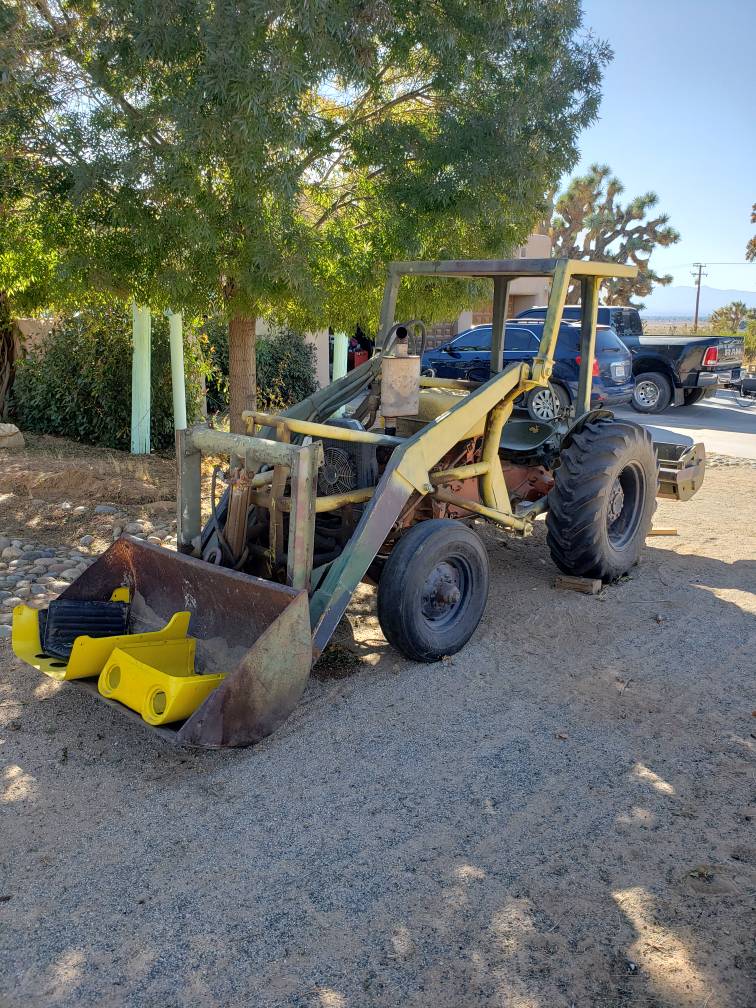

So good to know that others also have had good experiences with the engine running and starting. Particularly as I bought mine not running due to the "carb issue". I gave it a quick look over and jumped in with both feet first. I really have to stop doing that. LOL.
I really believe it has good bones and just needs some TLC. Hour meter shows 3131.2. By using the parts book I have narrowed the SN to be a 1962 or early 1963 model.
It has a really heavy duty FEL, a really beefy Gannon, and a really heavy duty 4 post ROP roof canopy. There is a lot of Olive Drab paint evident that a PO has attempted to cover. It has most of the sheet metal but missing the side panels on the gas tank instrument panel area and the chrome strips.
I don't know if Case ever had a military contract but I think this tractor very likely could have been used by the military. This might explain the number of things I have discovered that had been broken and repaired/welded. Some of the repairs were done well, others just a "band-aid" repair.20201119_131432.jpeg
