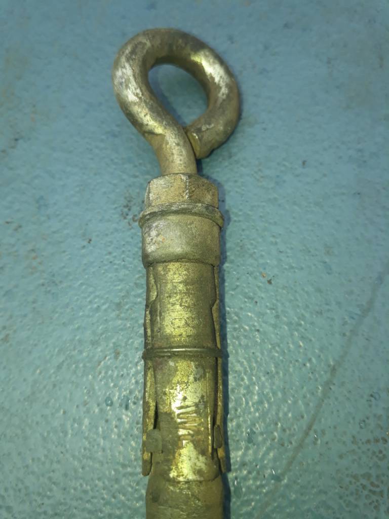

If valve is stuck in mcv put a bucket under the tractor to catch the oil...remove priorityvalveplug and spring ....start and rev engine till valve pops out.....polish valve and reinstall.
If it dose not come out use a rawbolt(as in pic) and pull it out with that. 20180917_143646.jpeg
